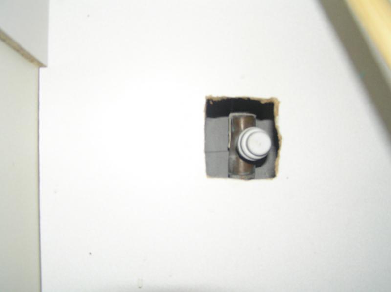

Installing a Filling Loop on WB 24i Junior

Well, I took a look and in a cupboard under the boiler, tucked in a corner there's a cut-out.
It looks like some kind of valve.
Picture attached - sorry for the quality but the angle is a ... pain.
Is that gonna be it?
You would be better fitting a standard filler loop, between the mains and the boiler return.

What you need is a return pipe, and a mains pipe less than 300 mm away from each other; the standard braided hose is about 250 mm long.
doitall - I think you're right, I'll just fit the Filling Loop I bought - sounds a lot easier than screwing around with pipes in awkward cupboards.

Worked perfectly. Once the isolators were off the Filling Loop just plugs in - screw it in as in the manual and pressure is back from 0.6 to 1.5 and all the radiators actually work!

Wonder what that stopend is all about :confused: Suspect it was part of the original filling loop which subsequently got in the way of the kitchen. Looks like 15 teed off 22, so possible
Well the boiler was changed, you can tell because there's need a new hole put through the wall (to the outside) for a new Flue so the old boiler may have had a filling loop there. That or that's how he filled it up initially.
