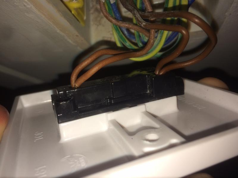

Hi all
I would like to have a new remote controlled dimmer switch installed in my bathroom. The bathroom has two lighting circuits - one circuit is downlighters and one circuit is incandescent pendants over the basins. At the moment they are controlled as a single circuit with a single switch and I'd like to retain this set up.
I wouldn't dream of doing this work myself - I think electrics are best left to the pros. But an electrician in London is expensive and I only want to have to call someone out once.
I would like to be able to confirm that the electrician has wired the switch properly and that he hasn't taken me for a ride when it comes to charging for the job (most electricians are honest, but I have had people string jobs out before).
Here is a link to the circuit diagram for the remote dimmer / installation instructions:
http://www.adeoproav.it/site/adeogr.../manuali/luci/WirelessDimmerModule_IG_Web.pdf
Here is a picture of the light switch (on the left are the two permanent live wires for the two circuits).
Is this a fairly simple job for an electrician? Should an hour be long enough?
Am I right in thinking that all he needs to do is connect the two permanent live wires into the Line (L) terminal on the dimmer and the other two wires into the load wire on the dimmer?
Many thanks.
