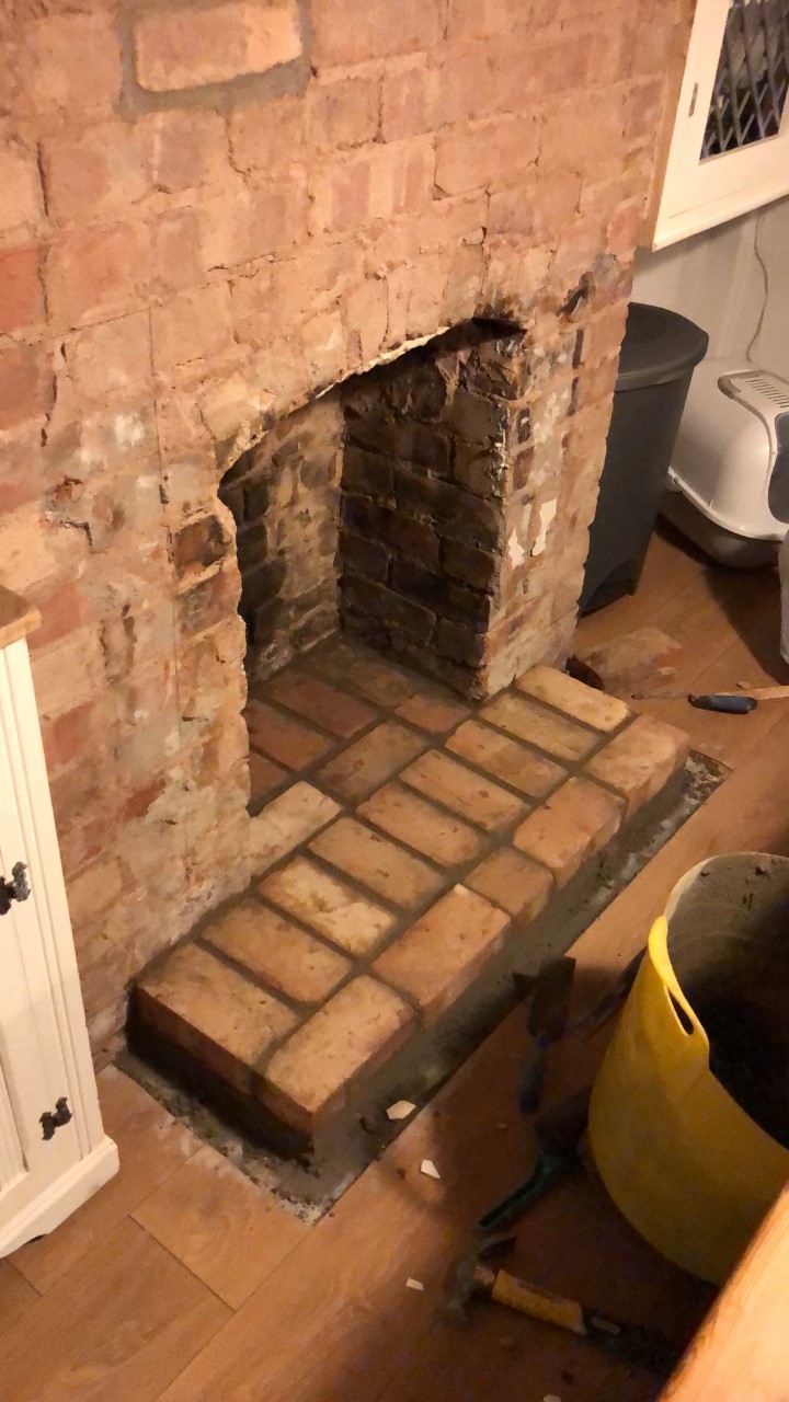

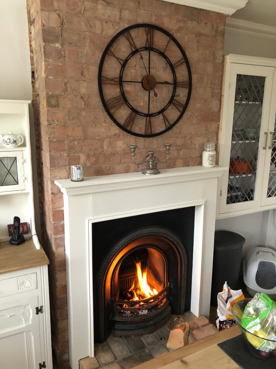

Update if anyone is interested. I had the chimney sweep back to examine the state of the chimney and all was fine. In the end we did go for an open fire which I've posted some pictures of below. I built a brick hearth and sourced a cast iron insert which was put into the opening. I fixed it into place and sealed around the edge then built a surround using old ply and some lengths of architrave and beading I had in the shed.
The new problem is that when lighting the fire, the smoke exits the chimney pot and a lot of it sinks down the front room flue pumping smoke into the room! This only happens when the stove is not lit and the flue cold. Not sure how to stop this other than by putting a taller pot on?

Does the room the fire is in have enough air supply, if not it may be trying to suck it down the other flue?
Yes plenty of air supply from the failing seals on the old double glazing! I have started it with the door/window open to promote a good supply but this does little to help. I think it's because the pot and the cowl on the stove flue are very close to each other at the same height.

the smoke problem sounds more like a damaged flue feather (brick partition between flues) thats allowing smoke and fumes to transfer into the front room flue - this is dangerous.

Thank you. I’ll explore the possibility that the feather is damaged but my gut feeling is the proximity of the pots to each other plus the prevailing wind/outside temperature. The flue was cleaned but I didn’t ask for a smoke test — reason being I carried this test out myself prior to the installation. I got some smoke pellets from the plumber and used those. I clearly saw smoke rise from the chimney pot and nothing had come down into the front room, nor in the upstairs bedroom or loft.

With this issue it sounds like the mid feathers have collapsed. The hot gases are cooling as they rise and some is escaping and heading down the other cold flue. When the heat in both flues is higher the hot gases create a good flow so the smoke is sucked outside. If you lit one and smoke comes out the other unlit flue and visa versa then its the feathers.

I’m not ruling out chimney damage at all, but if the mid feathers were breached why would smoke be pushed down the liner and into the stove? The only opening in that liner is at the very top of the chimney on the pot. That’s the only place smoke could be entering.
Two things you can do is like you say install a higher pot or get a top damper installed which will seal the chimney and stop it getting cold whilst you're not using the open fire.
