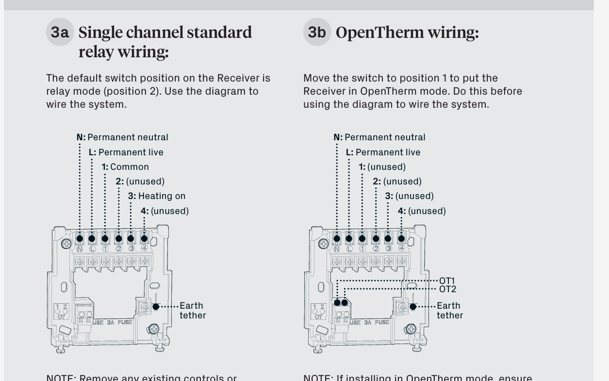

Hi
Bit of a diyist here. Could anyone help me. I’m planning on replacing my Honeywell thermostat (CM927) with a BDR191 receiver.
How will I go about wiring a nest mini hubless version receiver? I’ve attached photos of current wiring and the hive i want to buy.
Thanks in advance
The mini receiver is wired the same way. Power is connected from L and N (Brown and Blue), switching is performed by Grey and Black for a combi.
The Mini itself is wireless and battery powered.
No, but black to 1 would just keep it the same as the existing one. Not critical, it's just a switch in reality.
