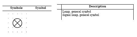

can you just confirm something for me please thats on the diagram, that picture of a circle with a cross in is the light isnt it.
