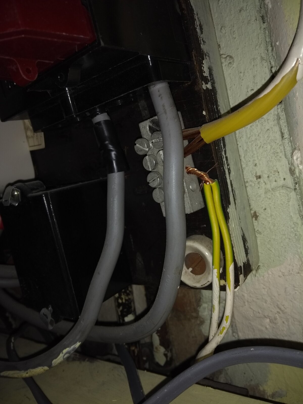

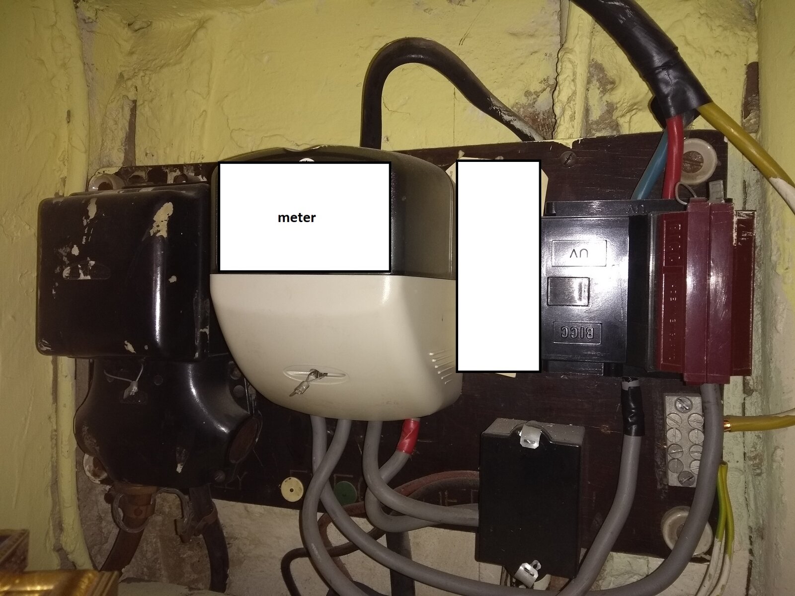

Just to clarify my question:
Am I to assume correctly that the new 10mm2 water and gas need to terminate in the distribution board terminal block? Or should they terminate in the CU.
I'm assuming it's the terminal block as per photo?
Do the cables need to be labelled individually as to which they are?
The large conductor split between two terminals, where is the other end of that connected?
Is that overhead TN-S?
Staffordshire was the first place I ever saw overhead TN-S and on the same day, subterranean TT supplies.
When you learn about supply types at college, you are generally told TN are underground and TT overhead. Then you go out into the world and find all sorts of variations!
It's a flat so I'm assuming it's TN-S? The cables likely sprawl all over the building? No overhead lines around here
