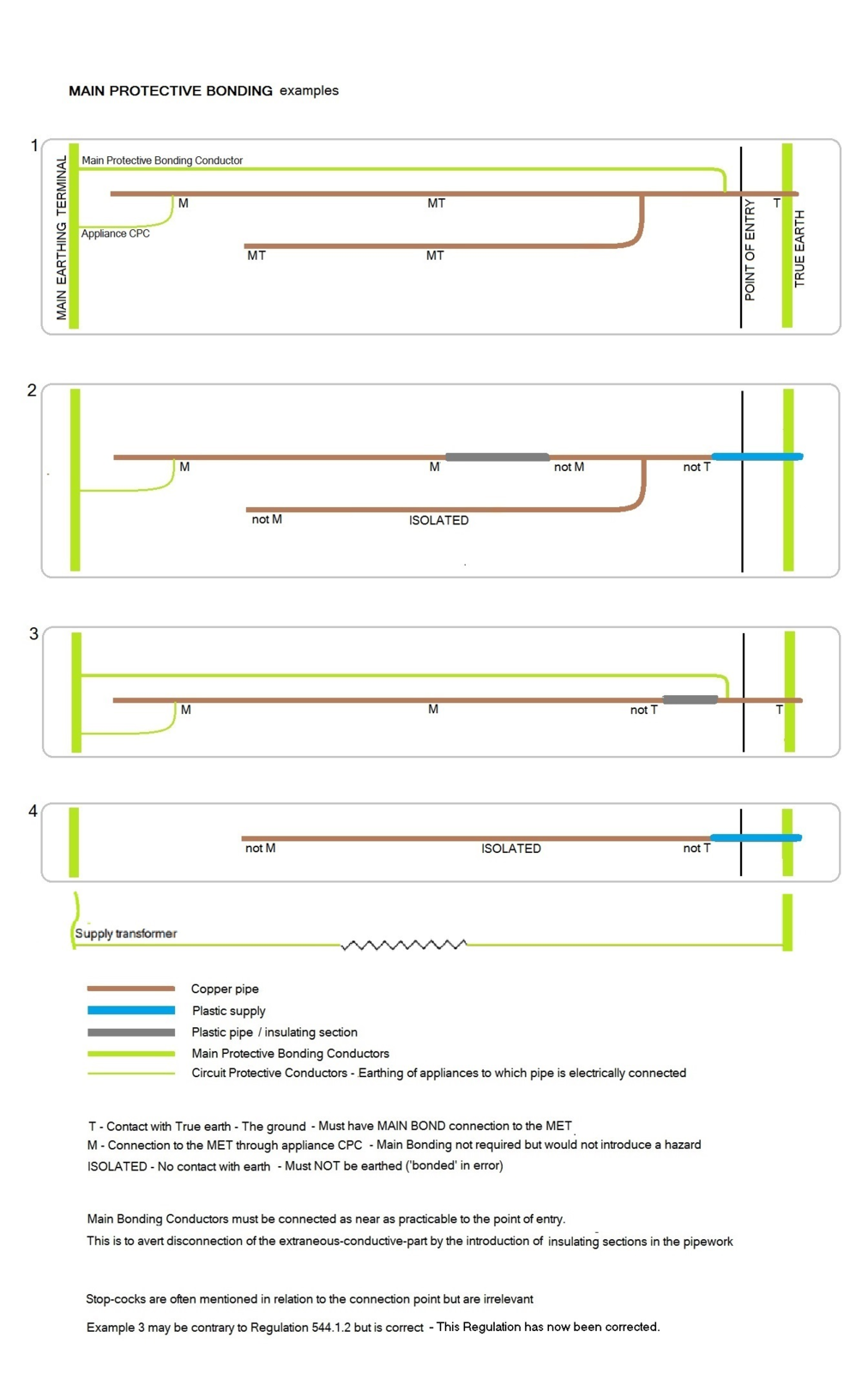

installing main earth bonding conductors to gas and water services
Ok. That seems correct.
They don't understand.
There would only be PD with the meter removed if the bond was on the consumer side. The error of gas people and also in the regulations until recently.
Not entirely certain of the position of things but the steel pipe must still be the extraneous-c-p.

The instruction in the regs about bonding on the consumer side of an 'insulating section' was always plain wrong. Whoever wrote it, and whoever allowed it to persist for many years, simply did not understand the concept of bonding.
However, in the situation you now have, I'm not sure what you mean by "the customer side" - 'customer side' of what?

of the meter

of the meter
Right - so that brings us back to the nonsense of BS7671. What it says is:
... Where there is a meter, isolation point or union, the connection shall be made to the consumer’s hard metal pipework and before any branch pipework. ...
... and I can't find any way of reading that which does not mean that one should bond on the consumer's side of the meter (no-one is quite sure what an "isolation point" is, but that doesn't matter if there is a meter).
However, electrically speaking, to bond on the consumer's side of the meter makes no sense. Electrically, what matters is to bond any conductor which enters the building from underground and that logically should be done as close as possible to the point of entry, regardless of any meter. If there is no electrical continuity across the meter, then nothing on the consumer's side of it can possibly qualify as an extraneous-c-p, so nothing on the consumer's side of an 'insulating' meter can possible require bonding.
Unfortunately, therefore, one has to choose between doing what is sensible/required, electrically, and what the (incorrect) regulation says. If yoh want to 'cover all bases' (primarily people undertaking EICRs!), you could do both - i.e. bond both on the consumer's side of the meter and (if there is any) also bond any metal pipe within the property which is on the supplier's side of the meter - the former to 'satisfy the regs' and the latter to do what is required electrically. Given that the consumer-side pipework (if metal) will almost inevitably be 'incidentally earthed', the (electrically) unnecessary bonding on the consumer's side will very rarely create any hazard.

...bond both on the consumer's side of the meter and (if there is any) also bond any metal pipe within the property which is on the supplier's side of the meter - the former to 'satisfy the regs' and the latter to do what is required electrically...

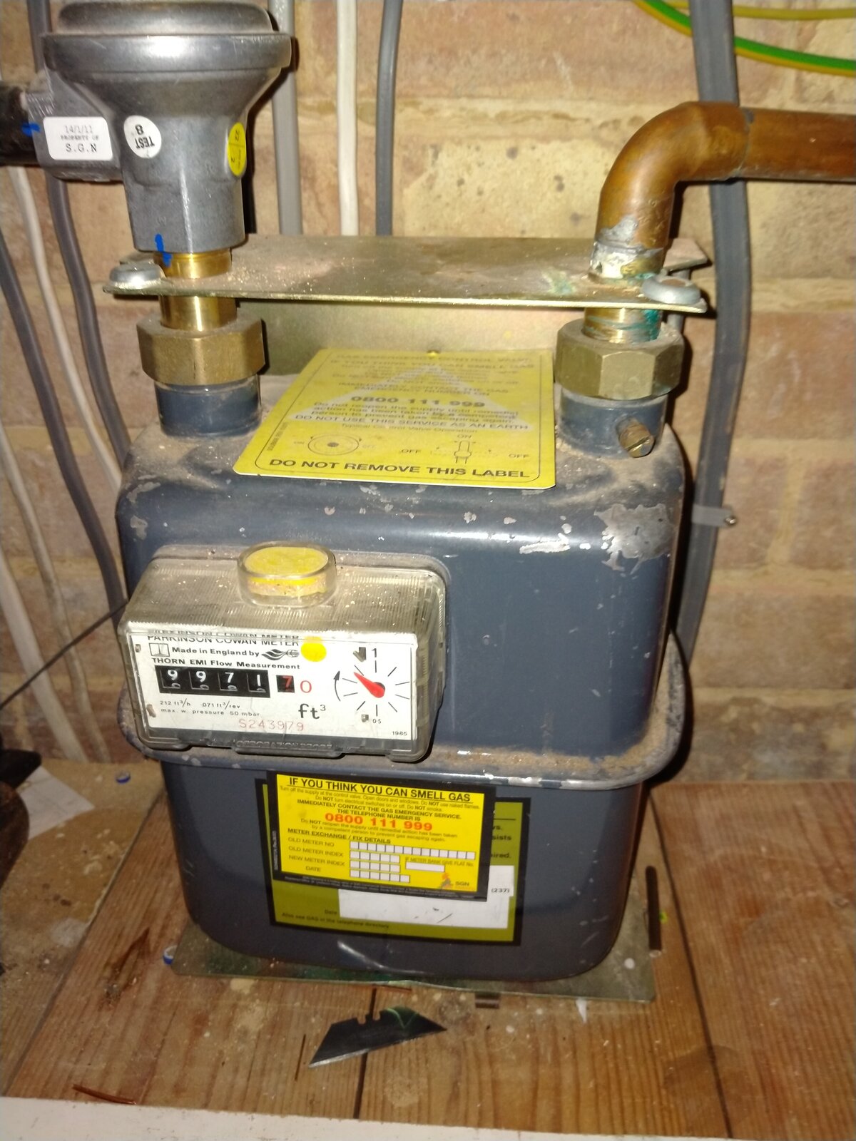

When my gas meter was changed a few years ago, they mounted the new one in a metal bracket that clamps the in- and out- bound ports together:
You'll find they're not clamped in there, the unions are very likely to free to rotate if it weren't for the pipes. Yesterday 'er in doors spoke to the gas man to make sure Henrys garage didn't get any smaller and he simply rotated the meter to create a bit more space. I believe the idea of the plate is to be screwed to the wall to hang the meter but rarely done inside the house.
On closer inspection - both inbound and outbound unions have a groove into which the plate fits quite tightly, and appear to be in close contact with the plate, although as you say, not actually clamped. Perhaps clamping them would be a design improvement.
Sorted, been bonded on both sides for 25 years. Thanks guys
Fair enough.
As I said, the (electrically) unnecessary bonding on the consumer's side of an (electrical) discontinuity would create an unnecessary hazard (by unnecessarily creating more earthed metal for people to touch) were it not for the fact that virtually all present-day gas and water (if copper) plumbing installations will be 'incidentally' earthed (by boilers, CH pumps/valves, immersions etc. etc.). That wasn't necessarily true in the past. My parents and grandparents had gas installations which supplied only gas cookers (with nothing 'electrical' about them and gas fires (again, nothing electrical), so the pipework was not necessarily earthed by anything.
