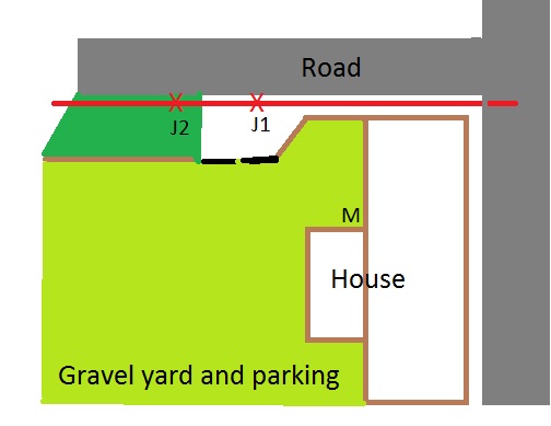

    Being flexible as to where the joint to the street cable is located can reduce the cost.
    Connecting a new supply to my cottage was quoted as £3000 and then when the DNO surveyor visited the site he suggested moving the location of the joint to the street cable by about a metre as it would save "a few pennies".
    J1 was under the tarmac of my vehicle access to the road, J2 was under the grass verge. The final DNO cost with the joint under the verge was £ 900
    Under a vehicle route requires traffic management to be in place ( yes even for a vehicle access to a private property ) while under a grass verge requires only safety barriers and much lower costs of re-instatement of the surface. A friend with a mini digger dug the trench from M (meter) to J2 for the same cost as it would have been to J1
