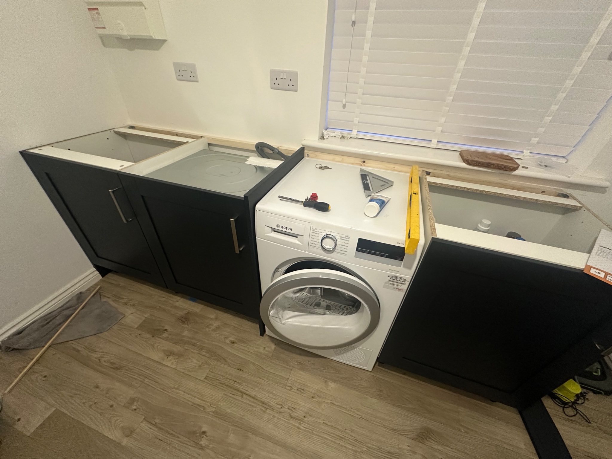

I’m fitting an oak worktop in a utility room I’ve made. I’ve not fitted an oak worktop before (used cheap laminate in the garage).
I’ve had it pre-cut so it will just drop straight in. I’m going to leave 3-4 mm clearance at the left side and along the back edge for growth.
I’ve got some slots bracket to fix the worktop to the cabinets. I’ll probably screw through the cabinet frame with some oversized clearance holes and washers as advised to add extra fixtures.
I was thinking of applying some sealant, maybe in the corners underneath the worktop and along the back edge. Mainly due to my suspicion that I haven’t got everything perfectly level and it will help it sit on the units/frame.
Is there anything wrong with this approach?

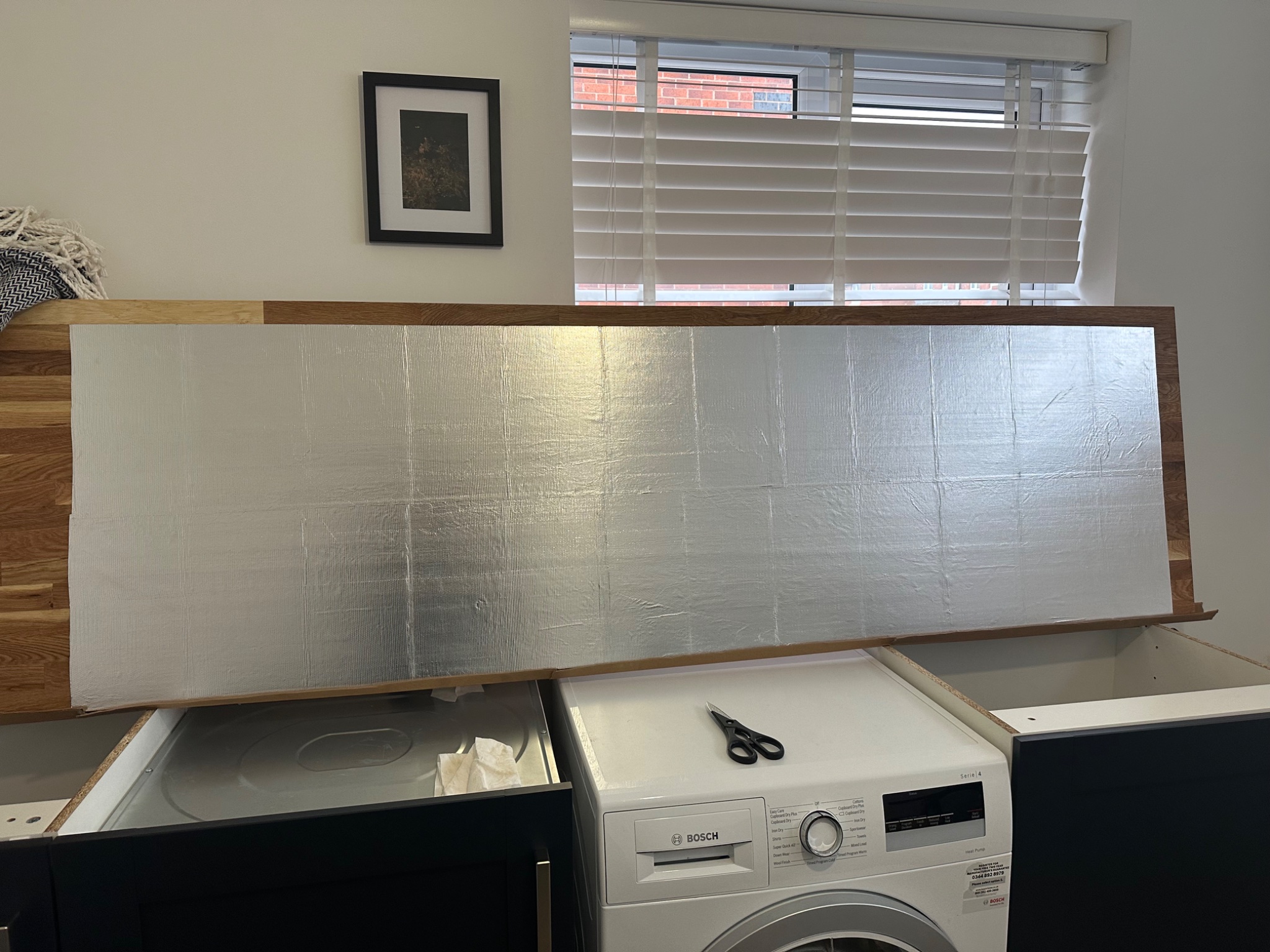

I also purchased some self adhesive foil in 300mm width to stick to the underside to try and prevent the heat from the tumble dryer affecting the wood.

Yeah I’m pretty happy with the left unit and it’s secured to the wall too, I’m more worried about the right unit as the floor runs out. I’ve tried my best to ignore the floor and window cill and keep it level.
Once you put the worktop on and fill the cabinets, the weight will sort all of it.
Won't do a thing for the heat, but it's more for the moisture, which is something you should be concerned about, eg steam from a dishwasher etc
If your windowsill and floor are massively out of level then you might need to let go the desire to have the worktop bang on and slope it some. "If it looks right, it is right" and having a windowsill that's obviously 2 inches above the top on one side and 3 on the other will look ramshackle. Adjusting the top to be a little off to take out a quarter inch, and adjusting the windowsill to take out another half inch for example would significantly diminish the visual effect of being far out
All in, try it for a fit and see how it looks, and don't be a slave to the level; you won't have a spirit bubble on it forever, but you will have to look at a windowsill forever

Yes the heat from the tumble dryer isn’t too bad tbf, but it is obviously a little more humid even though it’s a heat pump dryer. It’s probably overkill but I’ll stick the foil on today as the worktop is coming pre-oiled.
Re. The level, it has troubled me since I started. It is mainly the window cill and specifically the right side of it. It runs out about 8mm over a metre and my initial plan was to cut off the front of the cill and run the upstanding across the front. But it if looks ‘okay’ I was going to strategically place a planter or something on the worktop to hide that bit. My other concern was that if I tried to take that slope into account across the entire width I’d have bigger problems at the other end in terms of squareness and visuals.

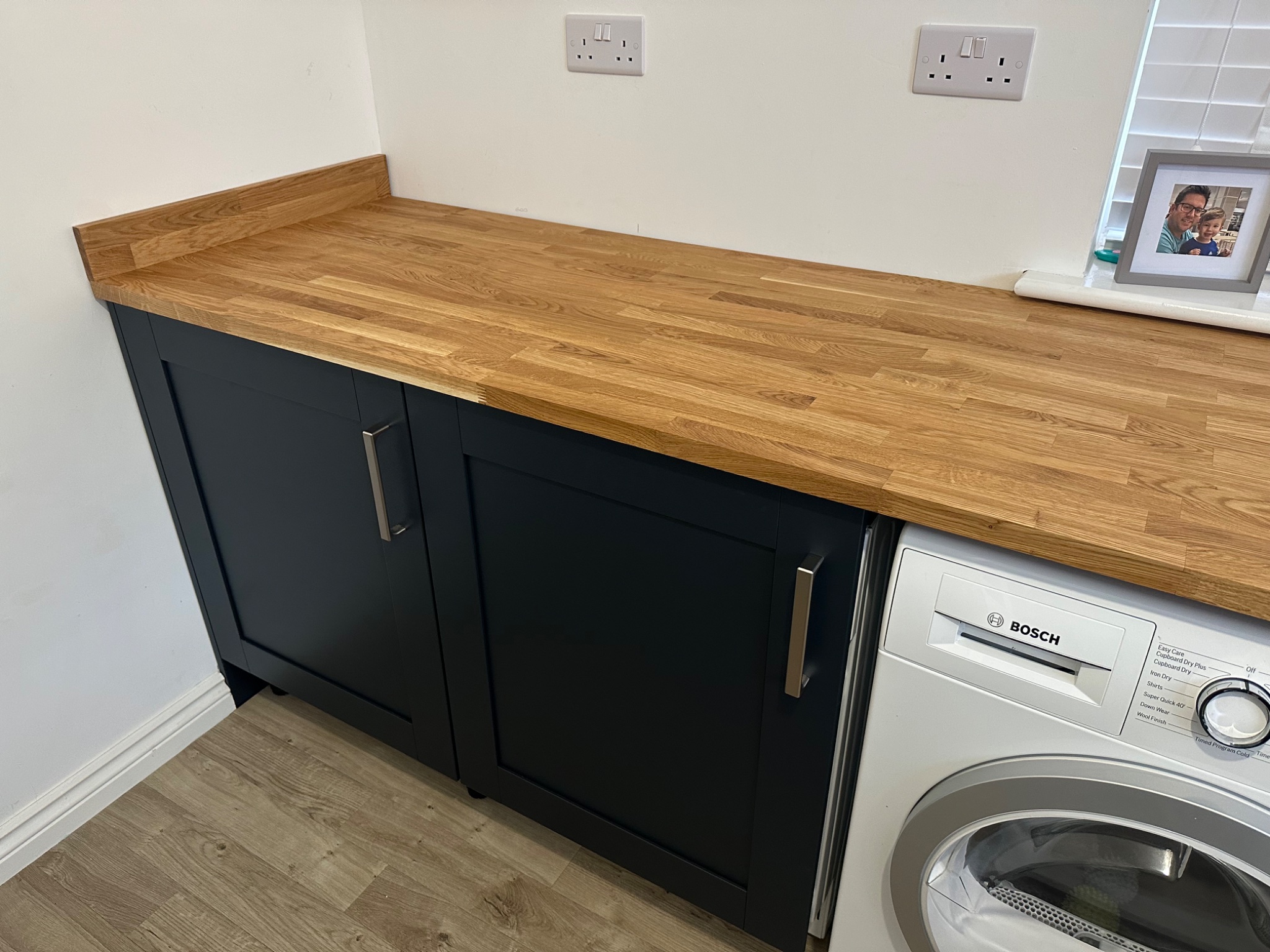

So I’ve installed the worktop.. gave the underside a coat (on top of the pre oiling) and done 2 so far on top and edges.
I’ve fitted the moisture barrier and secured it down to the 2 units with 4 x 4.5mm screws, 2 penny washers through 8mm holes.
Wasn’t sure where to tape the wooden beam along the back with foil tape in case moisture gets to that? Or is that excessive?
Worktop sat really nicely on the units, not too worried about the cill now as the far right will be obscured anyway.

Looks a tidy fit (y) think you've got that covered, no need for anymore.
Fitted my worktops years ago, they have no foil on above the washer, and it's never been a problem.
Are you adding an oak upstanding on the 'window' wall?
