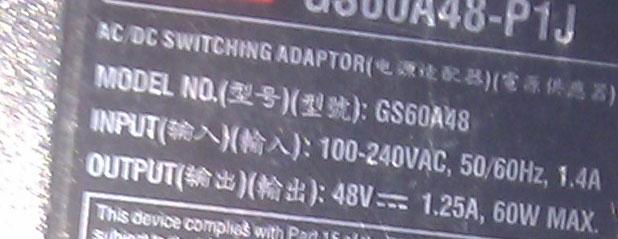

With regard to the power supplies, the PoE standard will require that the switch is capable of delivering so much power over each port which is why the PSU might seem overkill. Still, it says 30W max on the spec: http://www.cctvdiscover.com/megapix...ssories-c48_51/port-10100m-poe-switch-p4.html

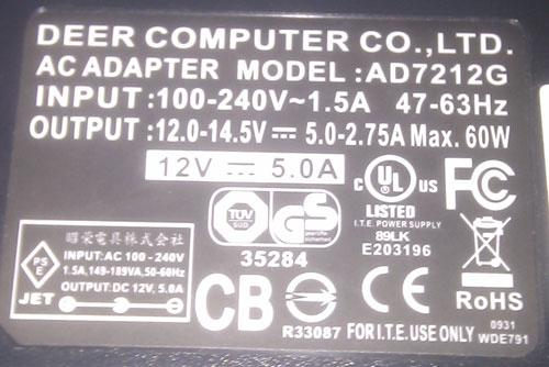

Picture of PC PSU:
Picture PoE switch PSU:
I will try and measure actual power consumption tomorrow.
Picture of PC PSU:
What on earth does "5.0-2.75A max" mean?
Picture Picture PoE switch PSU:
If they really did draw as much as they say when delivering their maximum stated output, they would probably get pretty hot ('rekindling'some of the previously-expressed concerns!), as well as costing you significant money to run continuously.
That will certainly be interesting. I would have expected/hoped for a small proportion of the total power consumption you are suggesting.
Kind Regards, John.
Measuring the power input will be difficult as with all low cost switch mode PSUs the input current only occurs during the peak of each mains cycle and readings on an RMS ( root mean square ) meter will not be valid for calculating power from volts times amps.
I suspect the 1.5 amp input current is the peak current taken as a short pulse 100 times a second.
The printed " 12 - 14.5 volt 5.0 - 2.75 amp " may be the extremes that the unit can "safely" produce but if the 60 watts maximum at 12 volts drops to only 40 watts at 14.5 volts then I would consider the output stage is operating on limits of some of its components. As a result I be very suspicious about the units reliablity.

As to the PSU ratings, you usually have to ignore the values on the rating plates ! It's something endemic in the IT world, and if people managing facilities worked on rating plates, they'd need to over-spec supplies by a very large margin.
That PC PSU is a good case in point. For 60W at 100V which is the worst case for input current, the actual current would be only 0.6A - plus whatever extra for the PSU losses. At 240V it's only 0.25A. Same for the other one as well. So we can only speculate as to where the numbers actually come from - my guess is that they are "just made up".
PoE provides (in it's current incarnation) a max of 15.4W/port, which means in excess of 60W if all ports were fully loaded. The actual power drawn will depend on the equipment attached - the phones we use at work only draw about 3-5W each, but I know some cameras can be marginal*. If the power drawn exceeds the limit for a single port then it will be turned off. If the total drawn would exceed the total capacity of the switch then not everything will be turned on.

Thank you for your comments. Here is the data I promised.

Power consumption:
34W with PC, switch and 2 camera connected and recording. During start up 40W was the highest value.
21W with PC idle, nothing else connected
11W just the switch, 2 camera connected
8W just the switch, 1 camera connected
4W just the switch, no cameras
Right, so the cameras are only taking 3-4W each, and the PC around 25W. That's not going to overheat under the floor.
