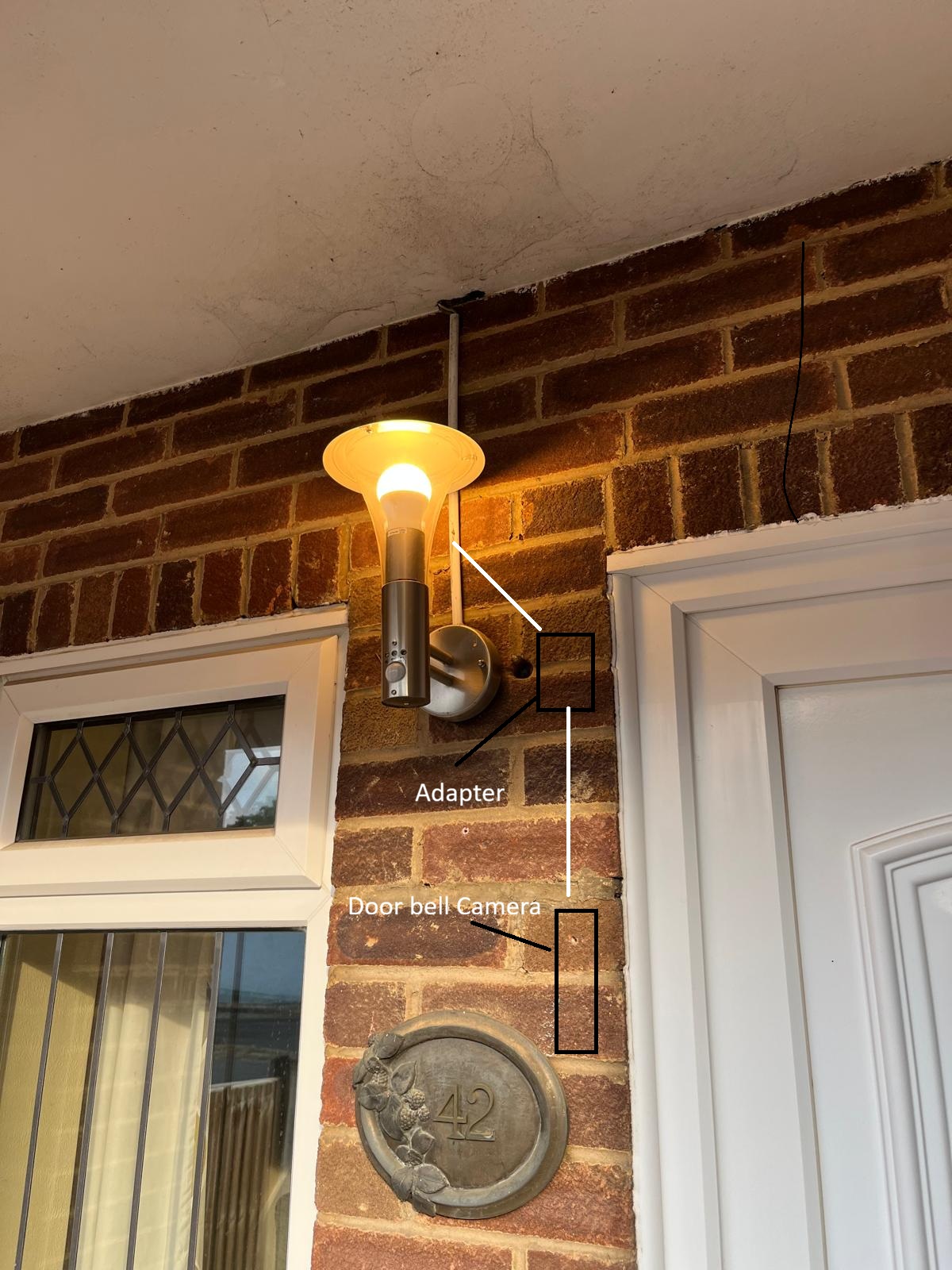

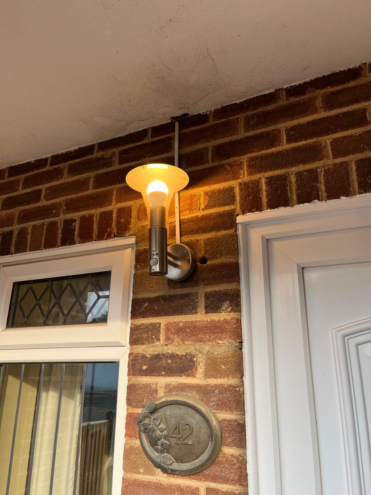

Hi

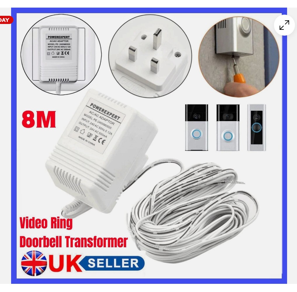

I want to install a wired video door bell, the problem is how to supply power. I want to use the power from nearby light, pls see photo, the light switch is always on as its a sensor PIR light. The adapter is as shown in the photo, I want to open the adapter which is coneveniently easy by removing screws and use the main feed connector to link to the light feed; the planned set up as in the last photo. I will have to find a way to fix the adapter on the wall. The area is like a porch so no risk of rain water.
Any issues with the above plan?
That won't look nice But I see what your point. I am only changing the way the 240V is supplied to the adapter. How about to use a 5A in line fuse connected to the live; which is similar in functioning to your suggestion?
How about using one of these

I'm not familiar with them but if the ring doorbell in picture has a plug in power supply and a lead to connect to the doorbell ?
That would be the best diy option for powered doorbell as no wiring alteration needed

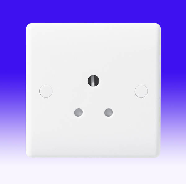

You could add a plug and socket arrangement if that suits you.

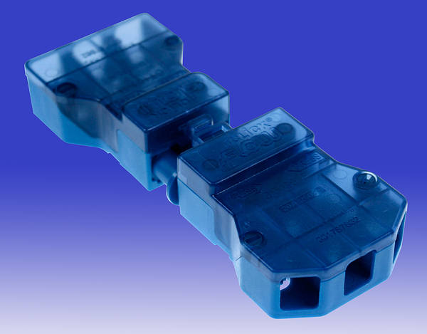

If you are concerned that a bog standard plug and socket might encorage someone to plug power tool etcinto a lighting circuit then you could use an alternative plug and socket arrangement
2 Amp and 5 Amp plugs and sockets shown
One make of 20A plug and socket connectors often used on lighting - there are others
