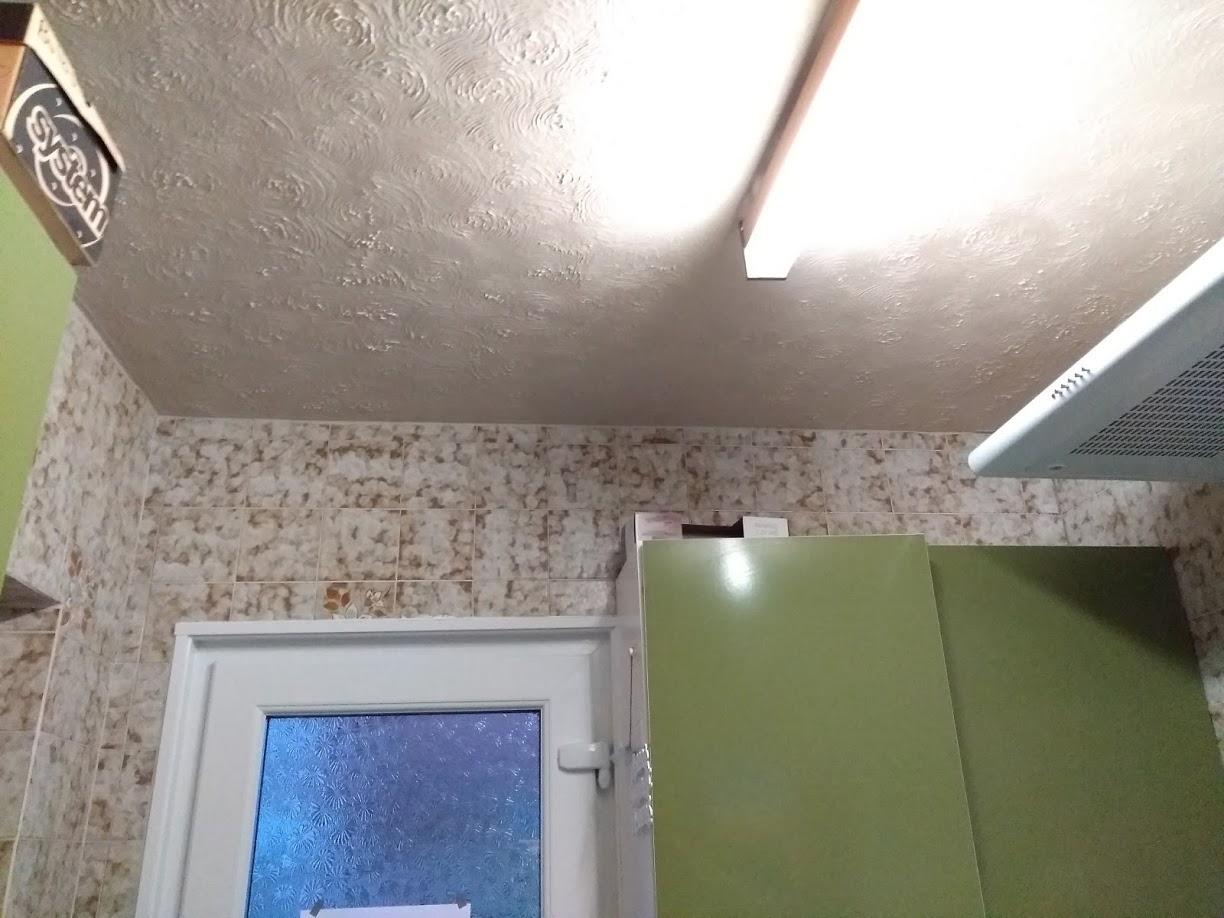

Although you say you have an extractor, mould suggests lack of ventilation, and the moist air is condensing on the cold parts. Post a picture, and we can discuss this further.
If there is plenty of insulation above, I'd be looking at possible leaky roof of pipes dripping on your ceiling. Or if its right at the edge next to the wall, then possibly damp coming from the walls. Either way celotexing (PIR) out the ceiling wont fix. Also, adding mineral roll to the loft is better from a fire protection point of view.

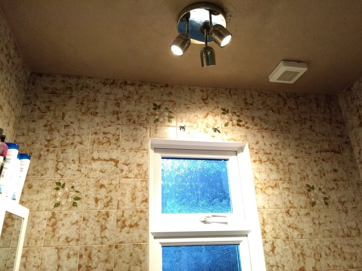

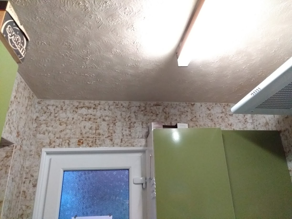

Not unusual especially at the external wall perimeter where the roof tiles are nearest to the ceiling.
Improving the insulation will help a lot as it will also address the cold bridging through the joists.
You are unlikely to rid a bathroom of all condensation even with the best of fans. An insulated under-draw will benefit greatly.

Pics of the ceiling, But after I cleaned the mould off. Came off with a bleached sponge, so seems surface only, not rotten through or anything.
