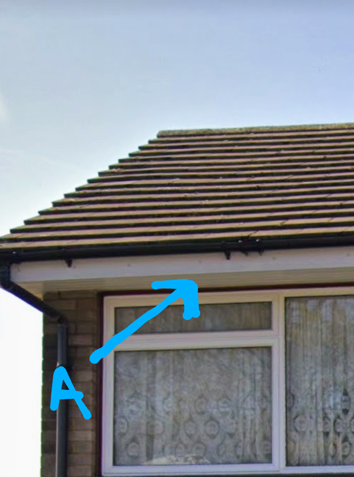

I recently topped up the insulation in my loft area.
I added insulation up to the edge of the plasterboard ceiling (none in the eaves). I made sure there was a gap between the insulations and the roofing felt
Given the construction of my roof/eaves is it possible to tell whether I have done the right thing?
Some posters questioned whether I have ventilated eaves. I am not certain.
The part I have labelled A is made of plastic and quite floppy.
Can't tell from that photo. Ventilation is often over the top of the fascia - obscured by the gutter - otherwise through the soffit (the underside) which isn't visible in your photo. Are there any vents in the soffit?
No there are no vents in the soffit

If you can't see any vents then you don't have vented eaves
So I don't have vented eaves
So Woody do I insulate up to the ceiling plasterboard
Or do I need to push the insulation further into the eaves?
Probably not. The only other option could be over fascia vents but your roof sounds original and would be too early for that. Vents might have been removed when the plastic fascia was installed. If there are any neighbouring houses with original facias left, check and see if they have any vents visible?
There may be some adventitious ventilation from air-leaky soffits, but not a lot, so can normally be insulated with no gap
So then I have made mistake by insulating up the the plasterboard ceiling below.
I need to stuff insulation in the eaves (ie right at the very edge of the ceiling)?
Would it be prudent to leave a tiny 25mm gap at the eaves or unnecessary?
If eaves are not ventilated by design then they are not ventilating the roof, so could potentially be blocked off. I've done it my gaff and done it on jobs where I could make a site assessment, but strictly you or someone would need to make that decision based on what you can see (or feel) in your particular roof.
Even if the unvented eaves are providing some adventitious ventilation, it wont be a great deal. So if you are concerned you could stuff some crumpled paper, cardboard or a polythene bag on the top just to create a small gap. Or buy some rafter roll and cut it into sections. The thing is you don't need to maintain the 50mm full width gap as recommended for vented eaves, but if you are minded or worried just "some" gap.
