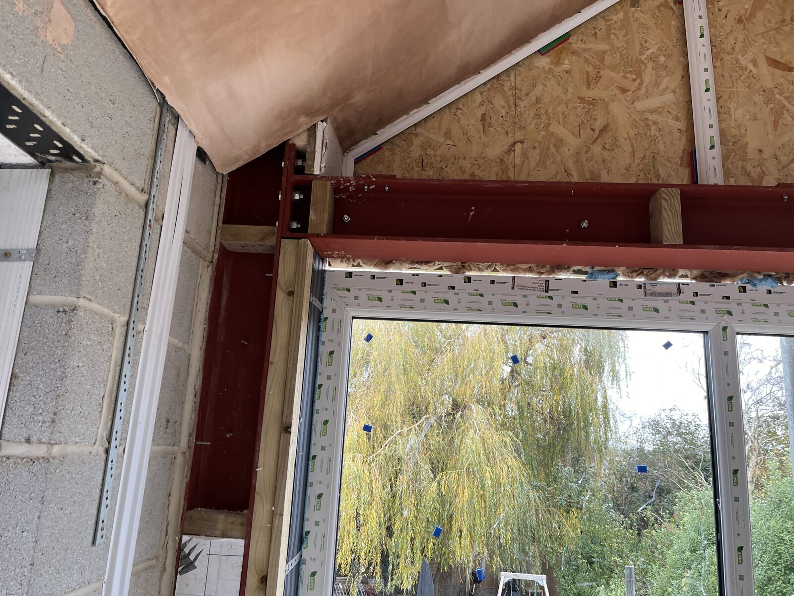

Just getting things ready for the plasterers to come in and plaster the room around the steel A frame forming the gable end. The drawings state a double layer of plasterboard but is that enough to prevent cold faces all around the gable end window?
I've already glued in wood noggins in the steel webs to take the plasterboard screws, but should I insulate in the web and is this worthwhile as the steel forms the reveals both sides and over the top and can only take two layers of plasterboard.
No; plasterboard alone is not innately an insulating material
Unlikely that adding insulation to the web will cure the cold bridge but it may help reduce the cold surface area presented to the room
This cold bridge should have been better designed out at the start. I'd be looking to put the steel entirely in the cold side and insulate the room from it completely
Upload pictures of what you have now and of any drawings, so we can better advise
This is what the gable end of the steel frame looks like.
I've now padded out all of the steel webs with rockwool and the drawings states two layers of plasterboard over any exposed steel. The underside of the cross beam between the top and bottom gable window will have 50mm insulated plasterboard. The cavity side of the steels have cavity batts behind the brickwork and more rockwool in the web of the crossbeam and the outer window facia. Any small gaps will be foamed.
I think that is as much as can be done.

Can you not use celotex in the webs? Like you've done on the bottom left of the picture?
I think not a lot more can be achieved here, sometimes BC need to accept and be pragmatic around the solution presented.

I'd ditch all the timber down the sides and replace it with insulation, keeping just a few small bits for where your window strappings fix through, and wrap that entire set of steelwork in 50mm+ of PIR, get it out to the cold side
Are you adhering insulated PB to the block walls?

You are, but youre talking about putting it in the webs, which is only half the story, really. There is enough space here to get some PIR in where just plasterboard is being proposed, and I think that opportunity should be leveraged; it seems mostly possible to clad the entire room-side presentation of this steel in insulation
RichD1 have you got the enginner's drawings available?
Also, how come the ceilig is skimmed when the walls aren't even plasterboarded? Such an odd detail
No engineering drawings for this detail. Just very loose statements of two layers of plasterboard around exposed steel for fire purposes.
I started with PIR padding but it provided difficult. The steels had lots of tek bolts in the webs to secure wall ties in the side and back faces and holding the timber linings which prevented the PIR being fitted easily. So I've padded with Rockwool. I also had the Plasterers on my back waiting to board.
I've now got 50mm PIR insulated plasterboard around all the steel faces.
The ceiling was skimmed first because we had an internal scaffold frame the length of the room to reach the vaulted ceiling and the veluxs. This was removed and then walls lined and skimmed. No problem as the finish and join is superb.
