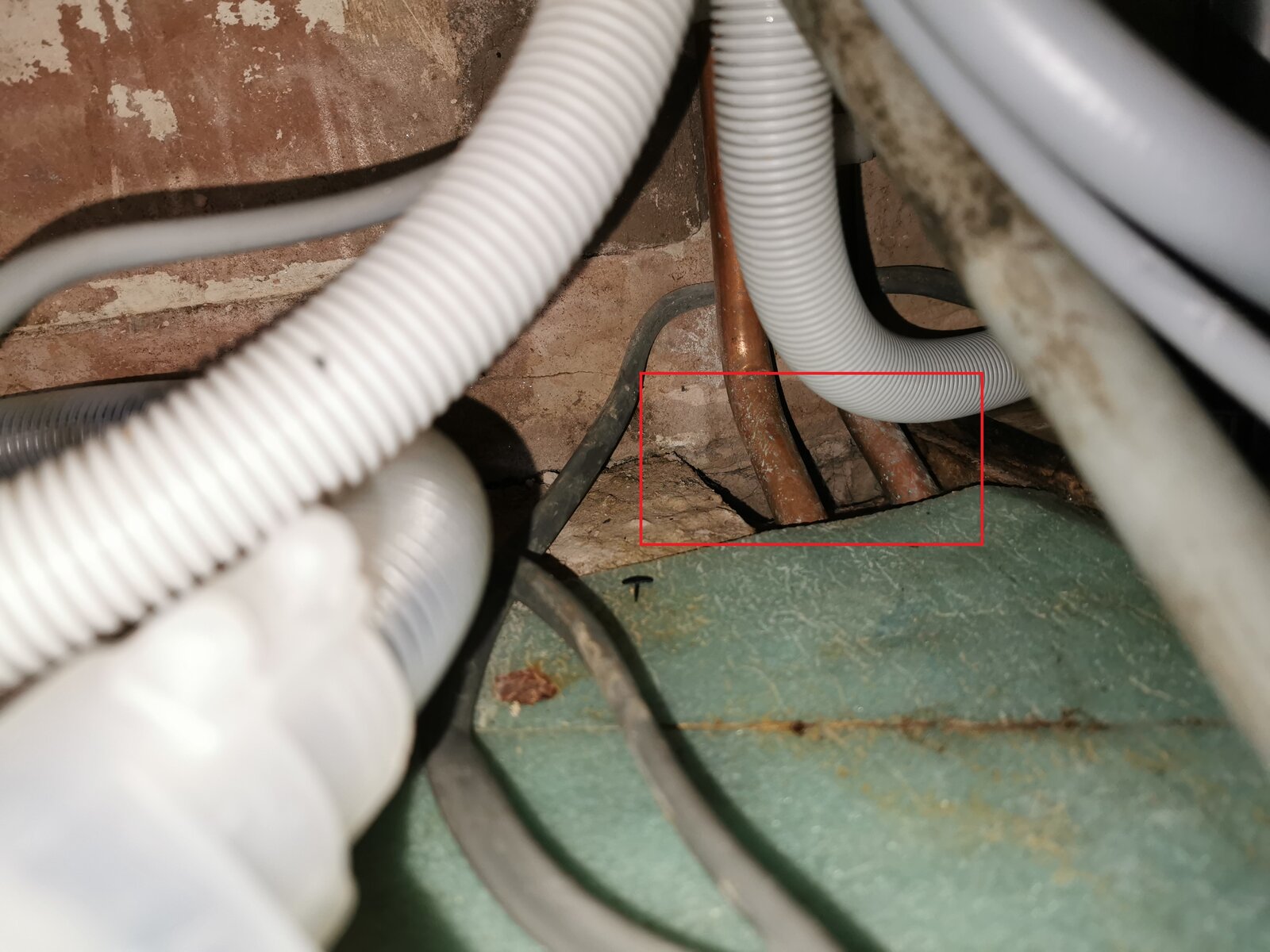

Hi All,
we have bought a house last year and already first winter exposed the problem with the temperature in the kitchen. There are some massive draughts and generally, floor is extremely cold when the temperature outside drops.
We have a suspended wooden floor with laminate on top of it.
I've discovered under a kitchen sink cupboard that there are pipes coming down through the floor where there is a big gap, a potential entry point of the cold air.
I wanted to patch it somehow but not sure what would be the best way to do that?
Any advice would be very much appreciated.
Picture of the gap and the pipes attached.
Thanks,
Mike

Thanks. Anything that would both fill that gap and improve the temp?
Expanding foam will cure the draughts, but for insulation you'll have to install something like snug fitting PIR insulation between the joists, i.e. beneath the floor. There is no easy solution, I'm afraid
floors need draughtproofing, but not a lot of insulation
there is no convection loss, obv,
negligible radiation
and not much loss through conduction into the still air beneath
so a layer of mineral wool, tightly packed to block draughts, will block most of the remainder as well.
