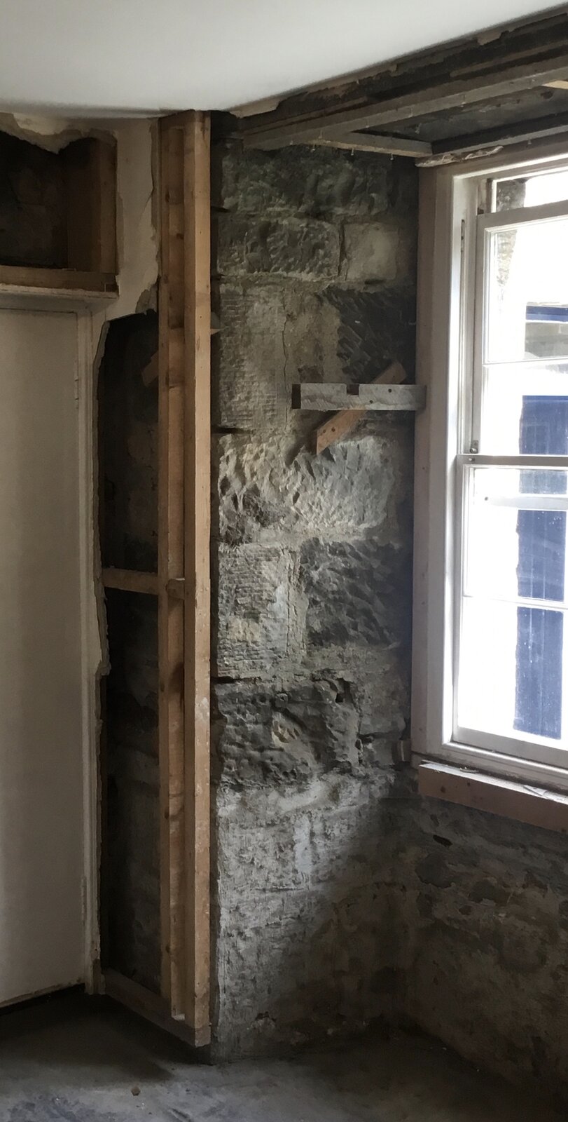

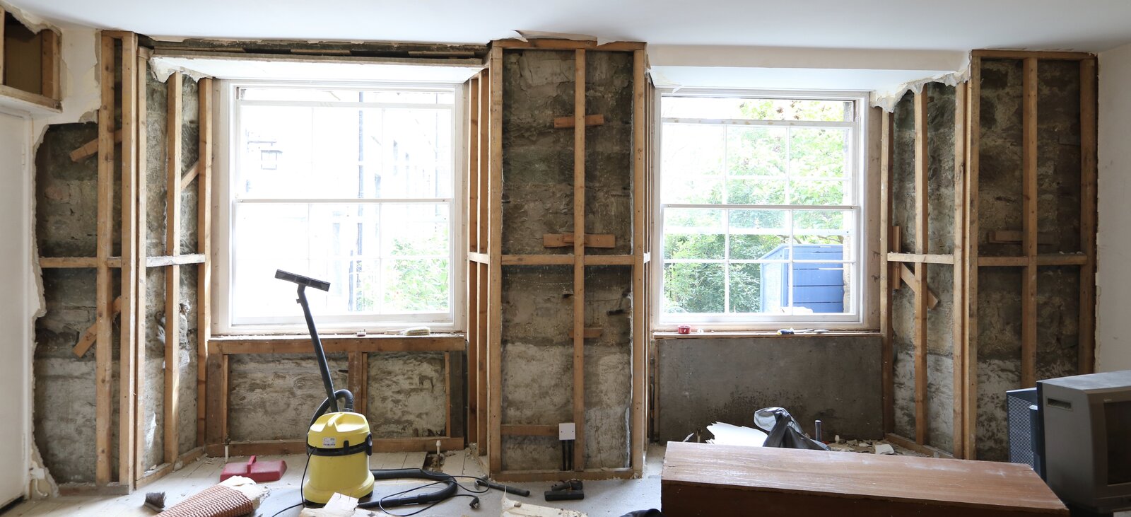

The room is something like 4.5m x 5.5m. It has two large sunny windows on the South wall. The North wall, on the other hand, is somewhat subterranean (the building is on a slope). Here’s a photo of the South wall:
I’ve removed the plasterboard, but the studwork is still in place. The walls are a mixture of good dressed stones, other old stones and some modern brick to fill gaps. Below window level, everything is covered with a layer of modern cement - presumably as an attempt at waterproofing.

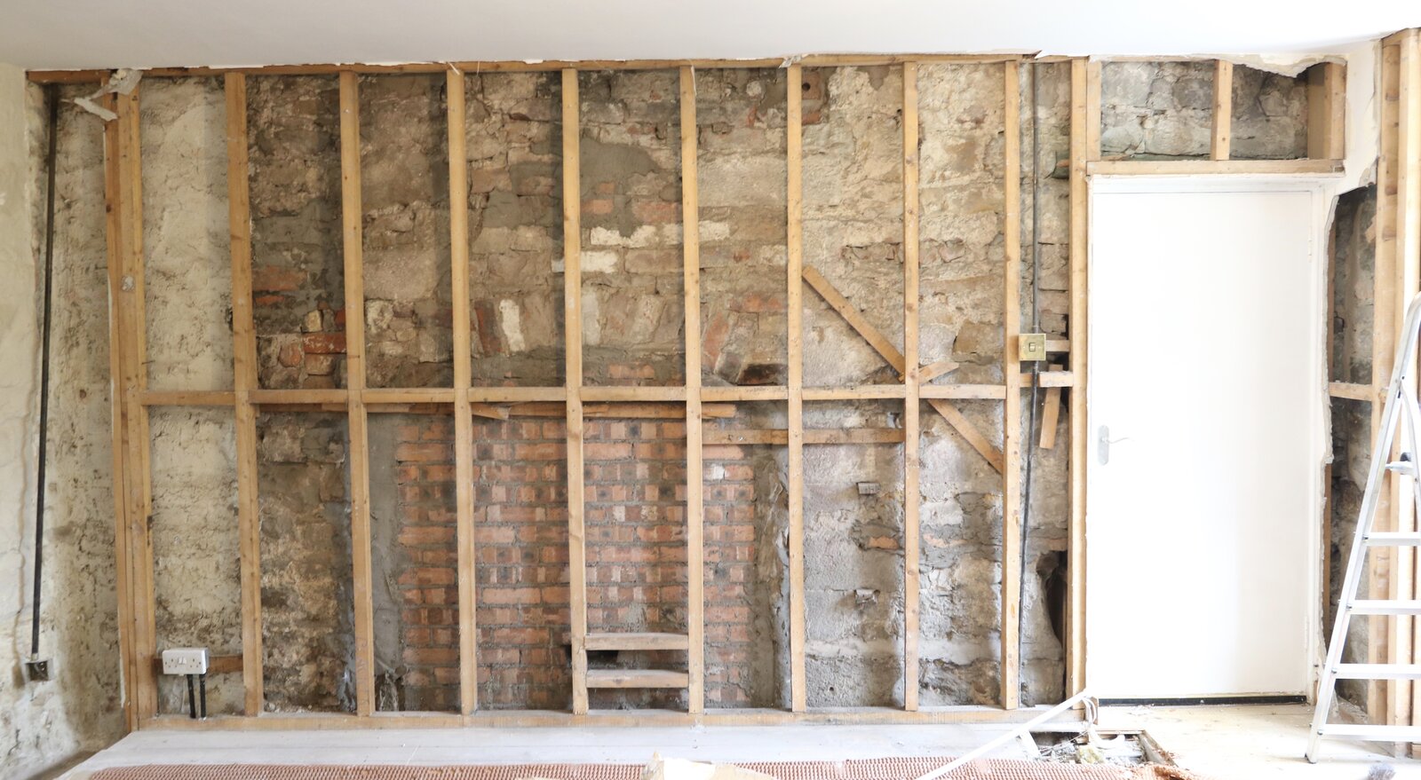

Here’s the East wall:
There are a few nice old stones, but most of it is lumps of rubble and bricks of various ages. The bricked-up fireplace was a surprise (for reasons that will become clear later!); it has a missing brick as a vent, but the corresponding vent in the plasterboard had been blocked up so I guess I’ll need to reinstate that.
This isn’t actually an external wall - but being about 1m thick and in contact with the ground at the base and its left end, it will still benefit from insulation.
In the other rooms I’ve removed the studwork and rebuilt from scratch to suit the insulation, but here it seems to be in better condition and I’m considering how I can modify it to accommodate the insulation batts, as that will reduce cost and waste. The timer is 50x47mm; for the external walls I’ll use 100mm wood fibre batts. I was considering making it deeper by adding battens to the front, but I’m also considering detaching the frames and moving them forward into the room, with or without something attached to the back. In any case, I will add more noggins to hopefully make them feel a bit more solid.

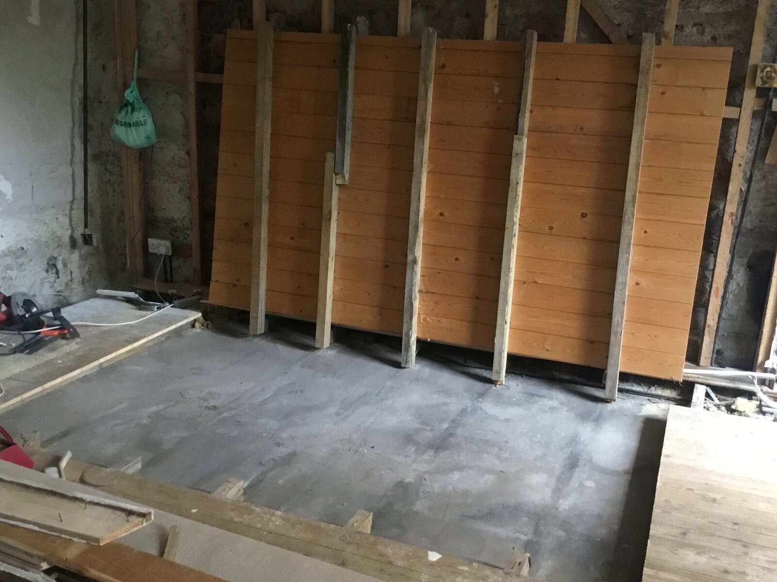

This afternoon I’ve lifted the first bit of floor:
I’m surprised by the subfloor. In all the other rooms I’ve found a pretty rough concrete surface, but here it appears to be some sort of screed, self-levelling compound, or possibly even bitumen. I’ll clean a patch up and then maybe you can help me identify it? If it is something impermeable then I won’t need a polythene layer below the insulation panels.

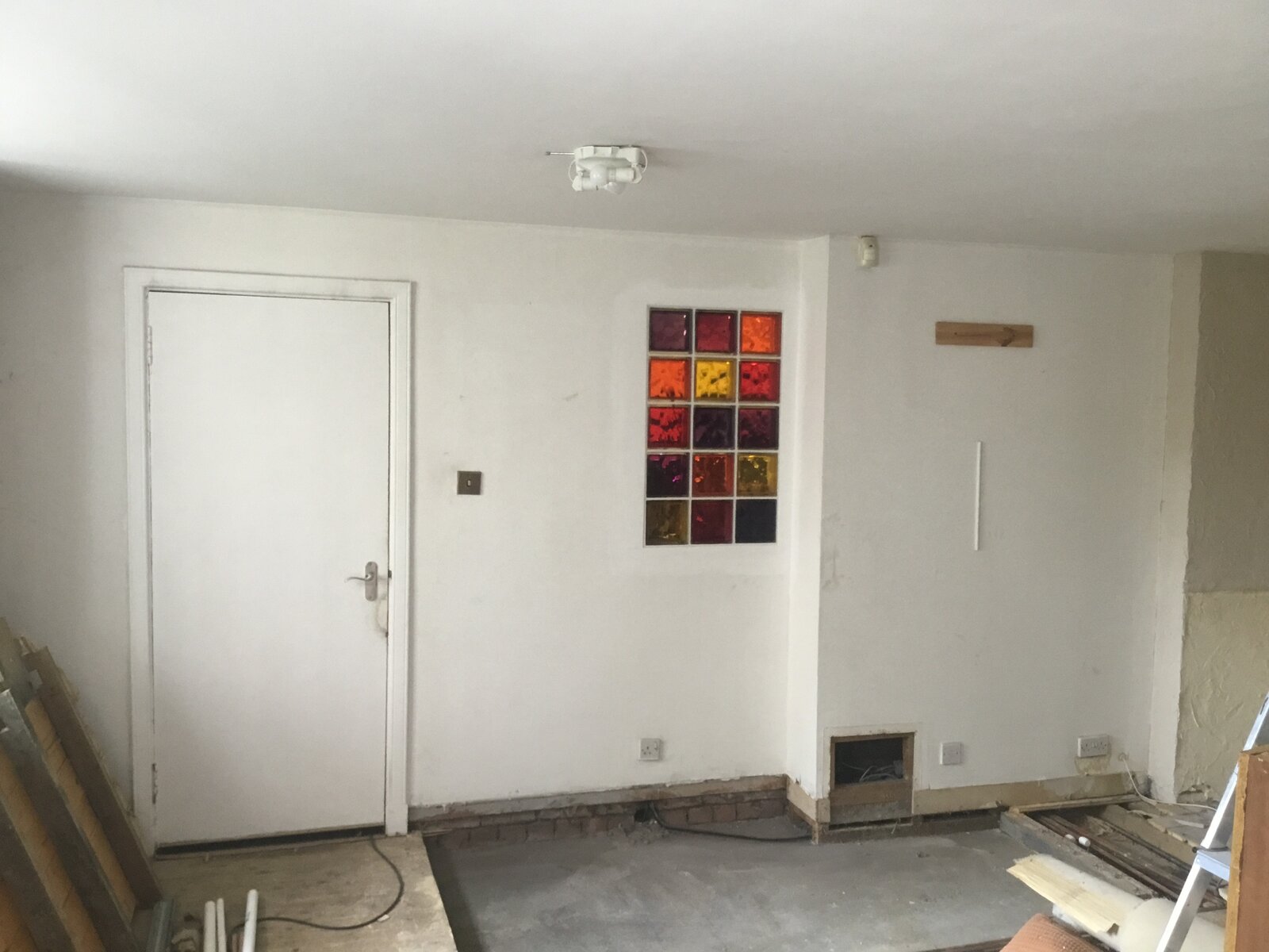

Here’s the room’s West wall, which was hidden behind a pile of junk when I posted the other photos:
I’m so jealous of anyone who is able to work in an empty property. It took a lot of work to move all the furniture out of this room, and every other corner of the flat is now full. So the only place for materials that haven’t been used yet and waste to-be-disposed-of is in this room itself. (There’s a small amount of space outside in the rain.) So from time to time I have to move everything from one end of the room to another.
Beyond this wall is the kitchen. The coloured glass bricks are one of the first things that I did when I moved here. There was previously just an open hatchway - so all kitchen smells were shared with the living room. Interestingly the hole was originally a doorway.
The wall is mostly modern brick; the right part has some plasterboard boxing around a soil stack from upstairs. The right part of that is empty behind, and I have considered making an inset bookcase or something.

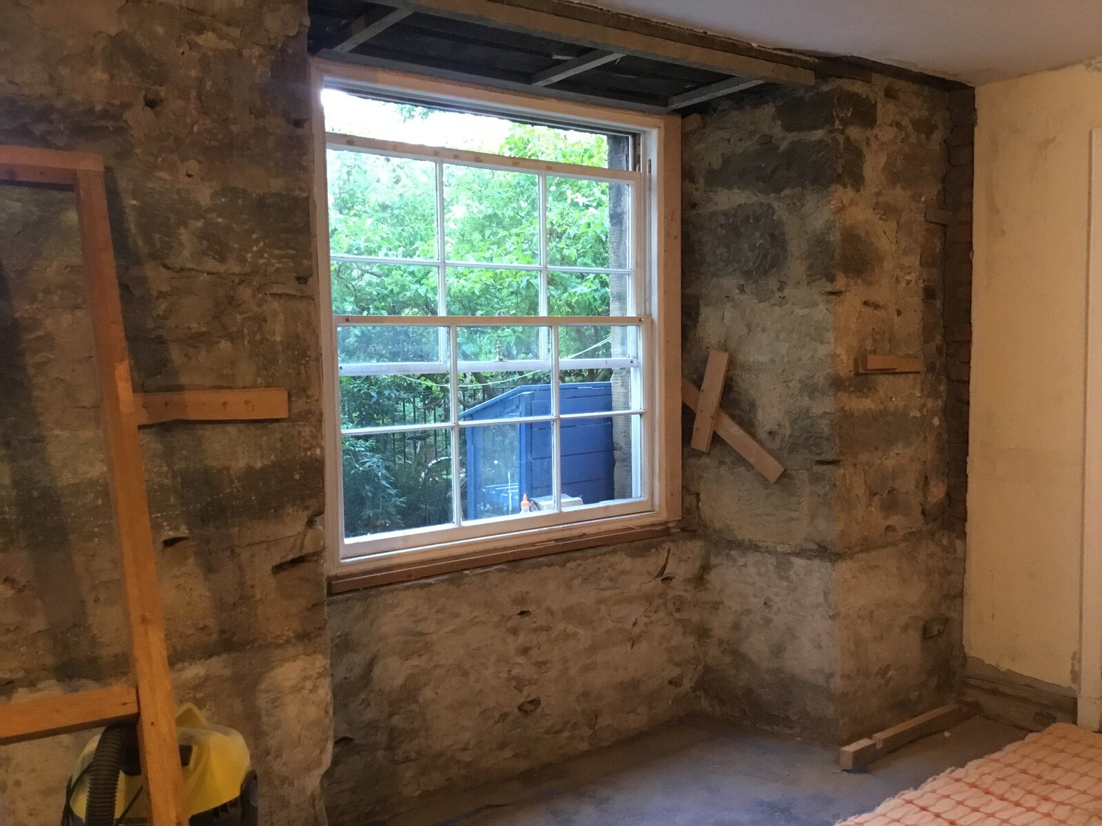

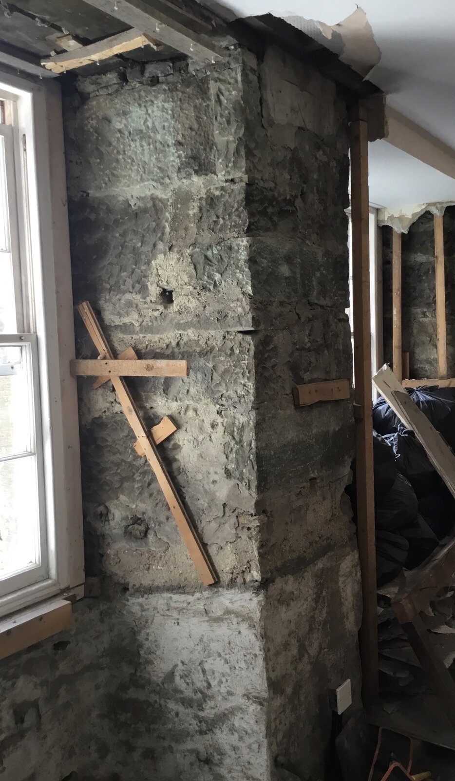

I’ve now removed the studwork frames from around the left hand window, exposing more of the stone.

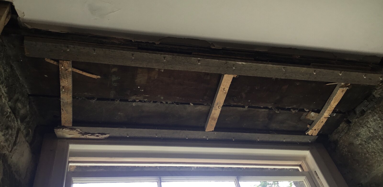

I’ve also removed the plasterboard above the window that was covering these timbers:
My resistance moisture meter reports something around 11-12% for those timbers, which I think is OK (right?). I’m unsure how old they are; I guess that they are probably from the 1980 conversion, and were inserted into the older stonework.
11-12% is good for an old building and these days anything below 20% is considered acceptable. Too dry and cracking could occur.

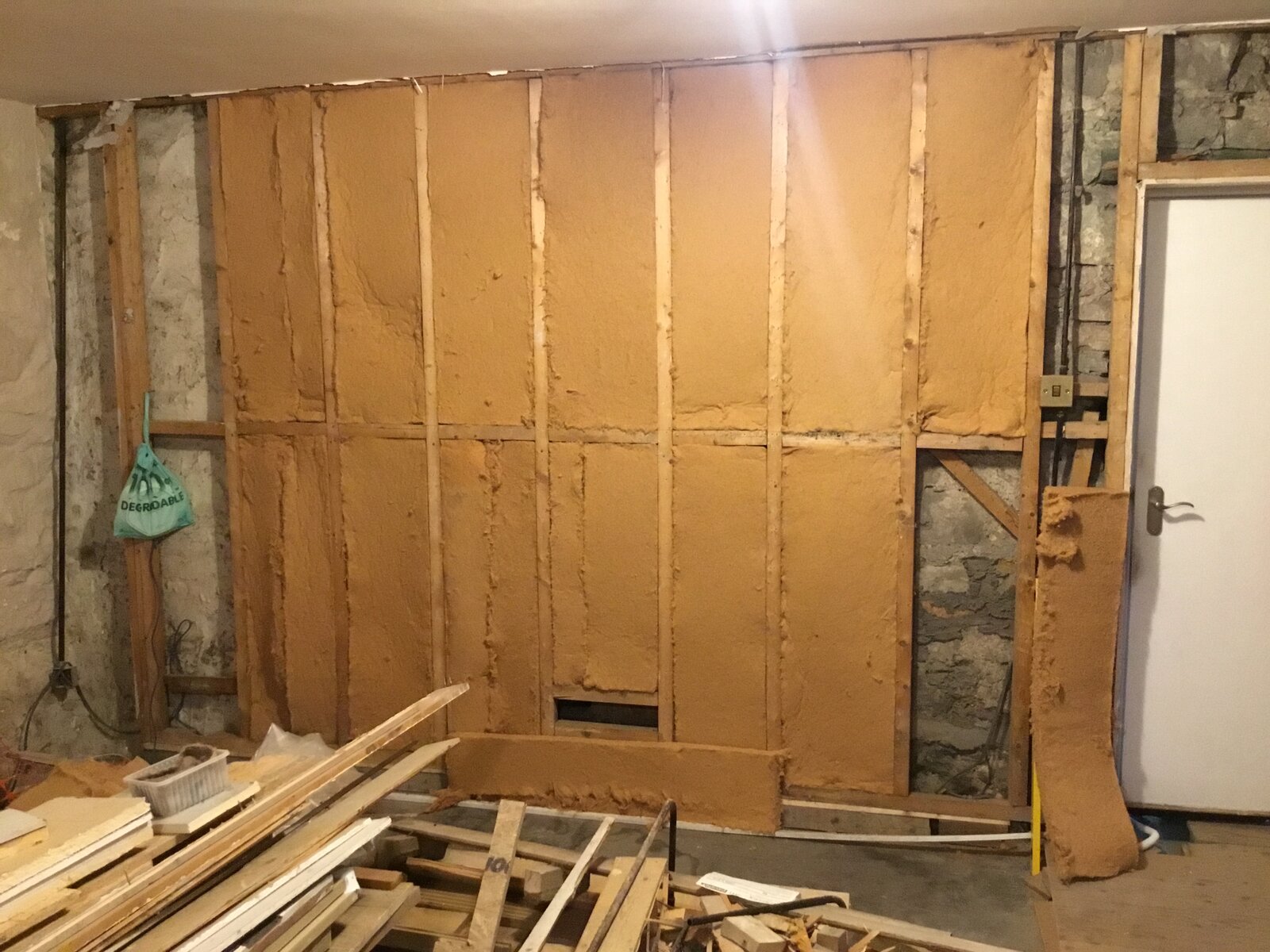

My main activity recently has been disposing of the old plasterboard, carpet and radiators (£165 spent so far) which I’ll not bore you with. But today I’ve installed the first bit of insulation, which feels like a milestone worth recording:
This is the East wall, where I’m installing the insulation into the existing 50mm studwork. The insulation is 50mm Pavaflex Light wood fibre.
Of course the batts are intended for 600mm studwork centres but mine are 400, so I have to chop them up. I’m supposed to maintain a 25mm gap between the insulation and the masonry, and these thin batts do slump a bit (the 100mm ones are better). I’ve decided they’re OK where I’ve used a single piece, but where I have a join I’ve added some support behind. I’ve got a roll of orange plastic fencing which I’ve tediously tacked in place.

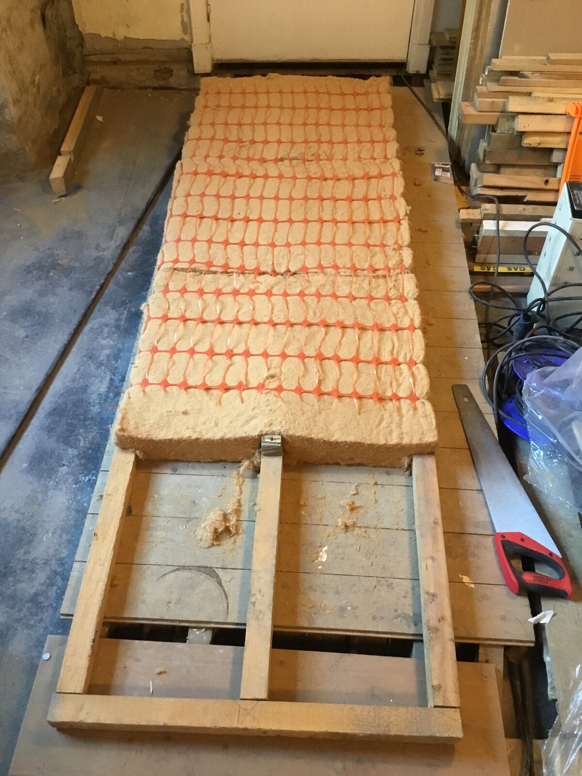

Here’s a photo of the right-hand window, which was the last area to have the studwork removed and will be the first to get it back:
I’m re-using the old 50mm studwork frames with the new 100mm insulation; I considered various ways of doing that, and decided to have the insulation overhanging the back of the frames, held in place with netting (orange fencing). This gives a good continuous layer of insulation, overlapping the noggins etc. I’ve just started assembling the first frame on the ground.
I’ve cut slots in the batts where the wood is. This seems to be a pretty easy way of doing it, though I’m aware that dealing with e.g. electrics will be more difficult as the insulation can’t be removed for access from the front.
