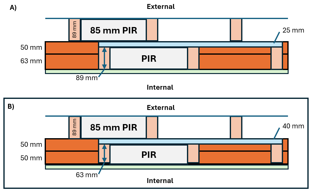

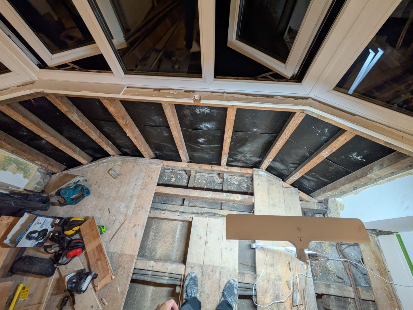

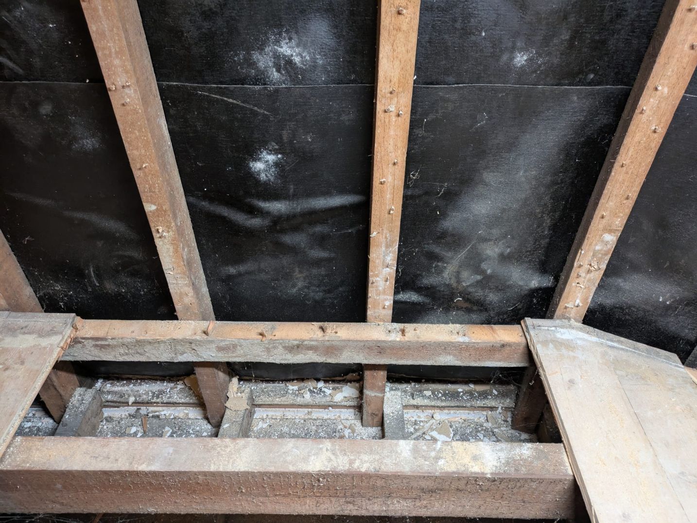

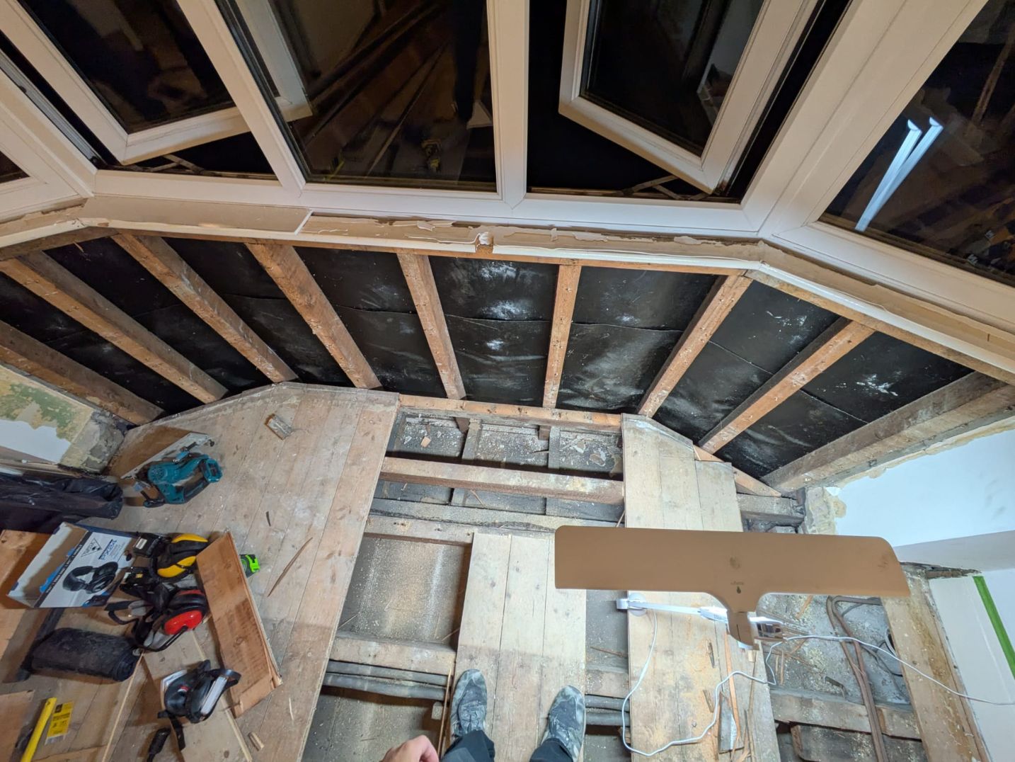

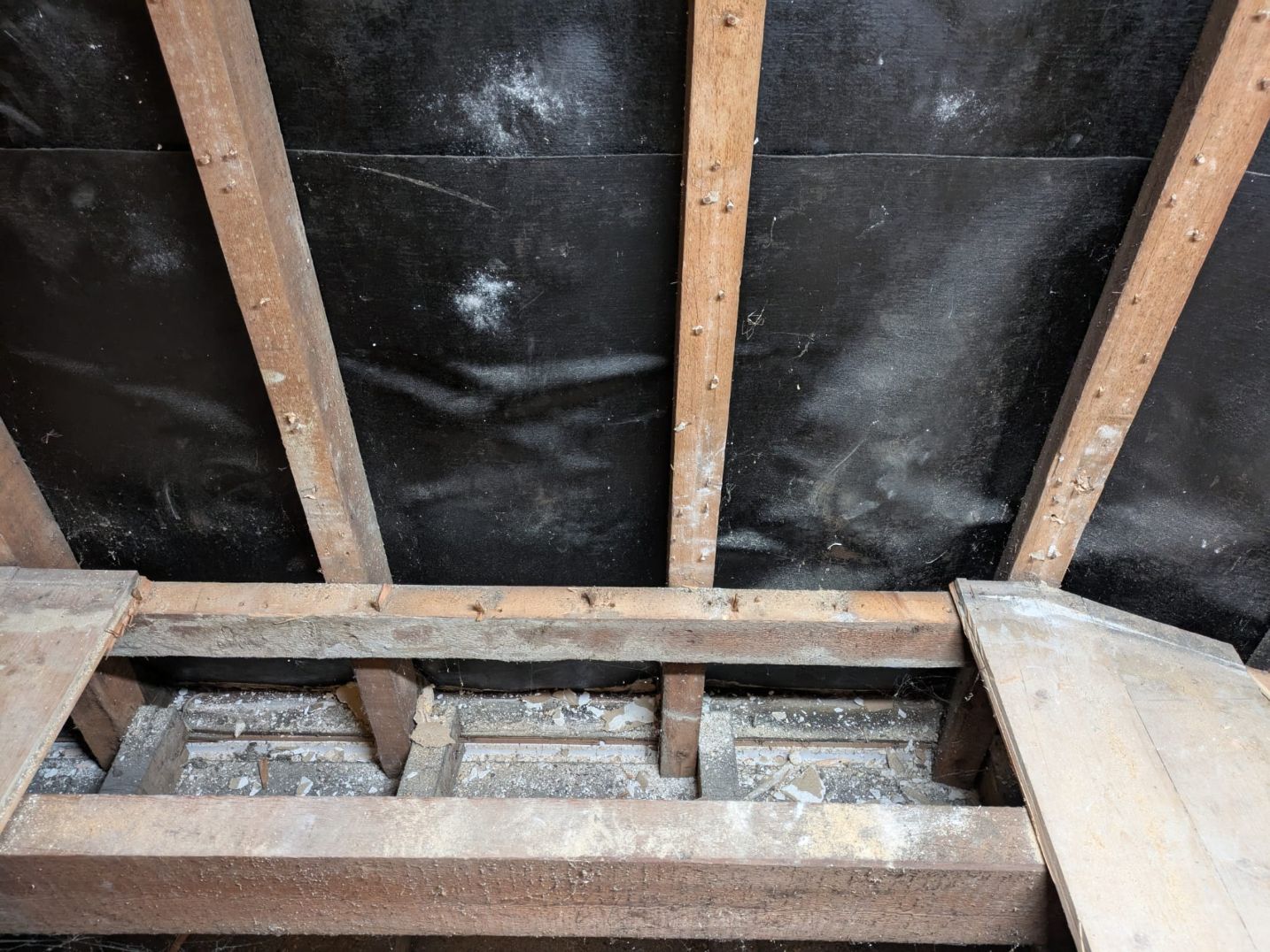

Hi all another one of many insulation threads. I have gotten pretty lost and have struggled searching for insulating information, when dealing with a non-breathable, vapour closed bitumen-like felt membrane. I believe the bay wall is felt with a roughcast rendered finish, no bricks.

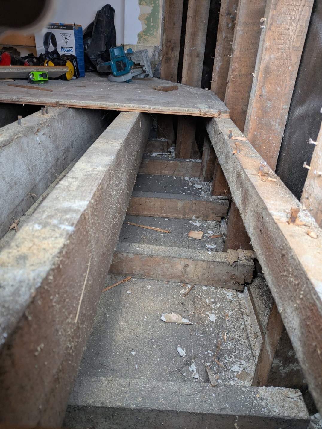

1) Bay lip - PIR triangles/wedges (foil to warm side); foam edges; foil-tape warm-face seams.
2) between outer vertical studs 1st layer at cold side - the vertical beam thickness / space from horizontal beam to DPM is 90 mm.
- Full fill so the PIR is against the DPM OR leave air gap (20-25 mm)?
- If "full fill" - the DPM bulges at points, with a 90mm board should I scribe into the board to account for DPM bulges or achieve 85 mm thickness (60 mm + 25 mm PIR).
- 4mm air gap on cold side okay?
- finish with perimeter foam and tape
3) interframe thermal break with rock wool 25-40 mm - so there is no foil on foil space that is breathable

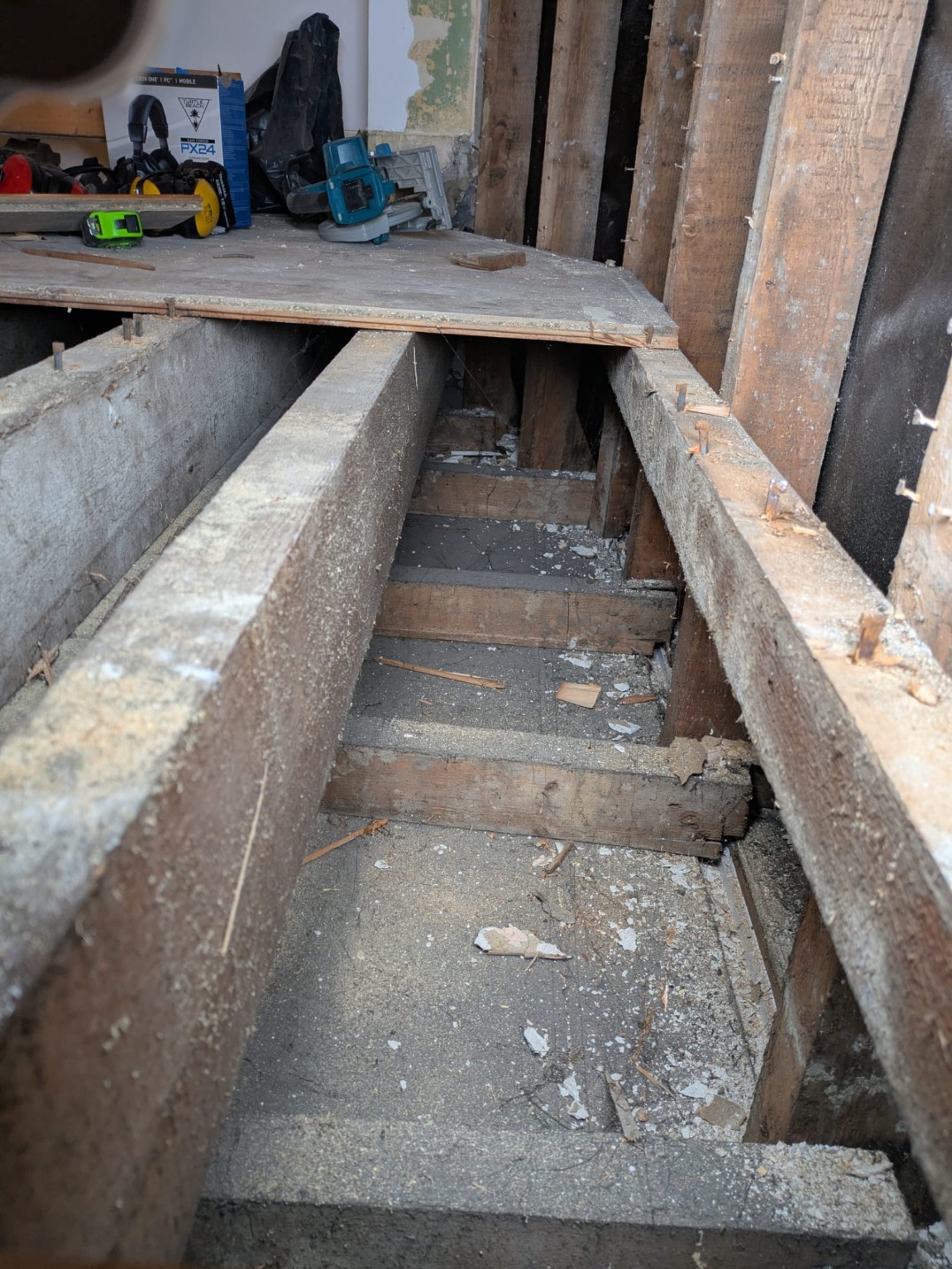

4) PIR board over bay void plasterboard (below room ceiling)
5) second frame with PIR
6) VLC bay wall insulation
7) infil void with rock wool up to floor board
8) VLC below flooring -
with tapered 3 mm OSB between floor joists then taped osb and tape edges or air tight membrane, then floor down down.
8) plasterboard
The non-breathable membrane has really confused me. I had originally wanted to rock wool the entire space (previously posted here).

Sorry, the presence of the impermeable membrane which has bulges (so not a smooth flat surface) has confused me.
Firstly, does the cold side need an air gap or not?
1) 85 mm PIR board to account for bulges
OR
2) 70 mm PIR which gives about 19mm of air gap.
Secondly, stick primarily with PIR?
No need for an air gap, but the bulges will likely be the back of the render, or the expanded metal mesh that's been pushed in.
You don't want anything pressing against this as you might end up cracking the render (unlikely if it's been applied correctly but don't risk it)
Don't waste time scribing the board (assume you mean scooping bits from the outer face of the board to accommodate the render?)
PIR will give the best thermal performance.
You've got no window board to limit the depth, so go as deep as you like. Try to avoid buying different thicknesses of board as you'll end up with a load of offcuts which justs wastes money.
Tbh just going with 70mm or 80mm board with a 37.mm insulated plasterboard over the top will sort you out.

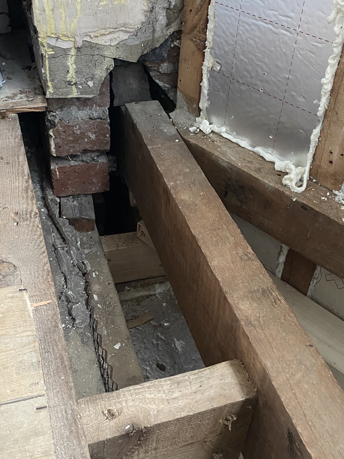

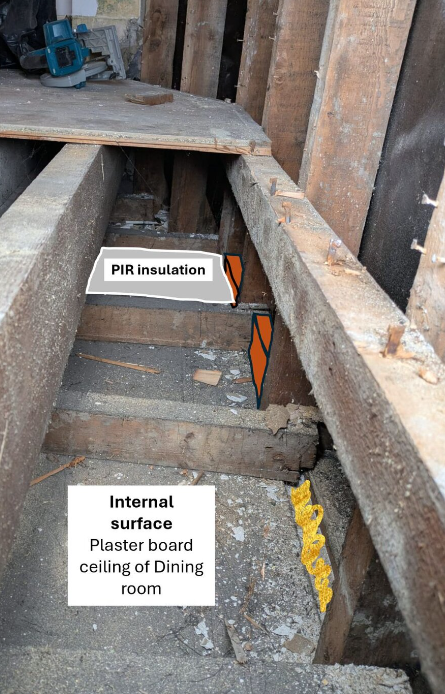

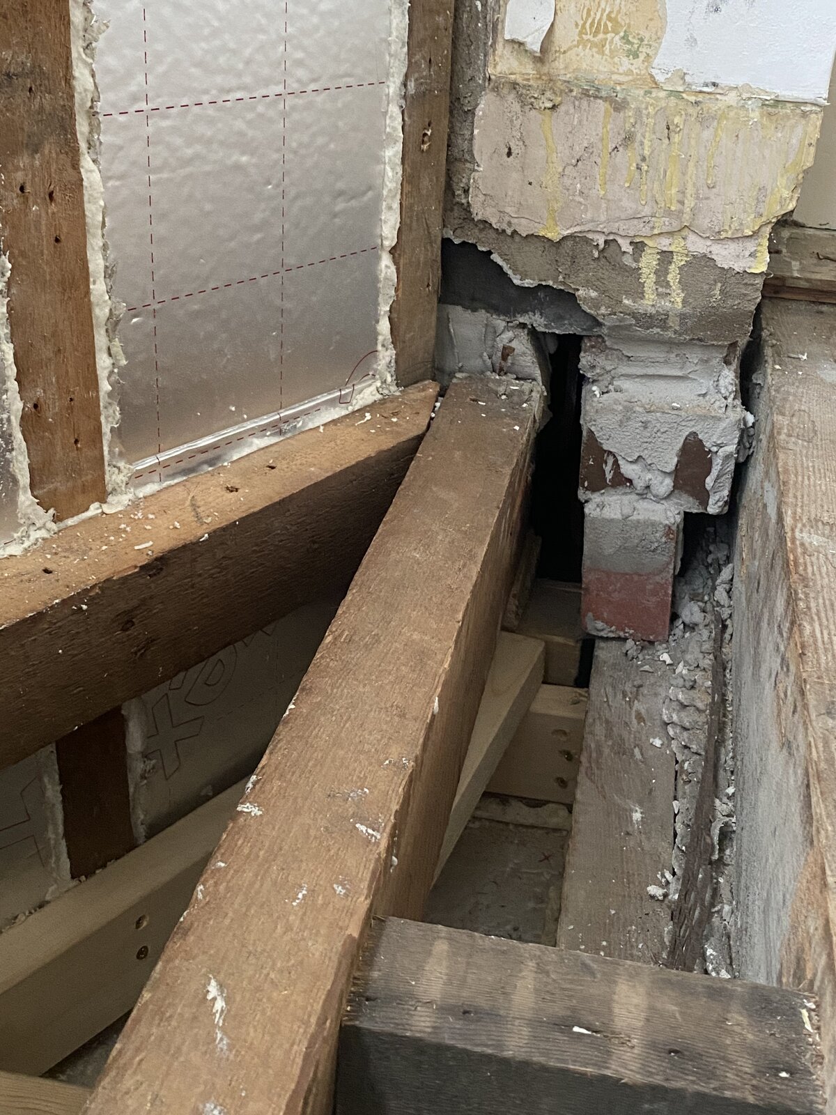

Update. First layer of PIR is in.
Either side of the bay area and below void space is a joining cavity wall. Should this be capped/sealed?
