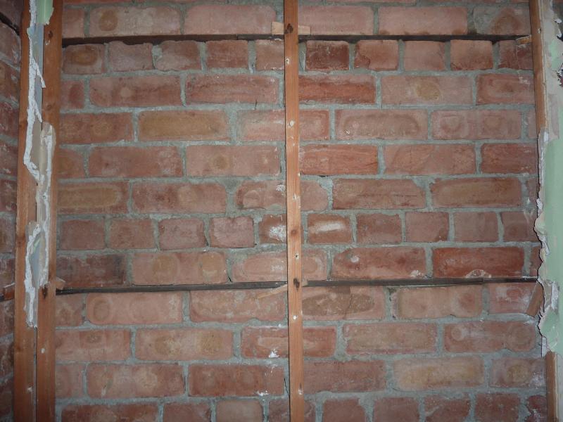

Started to take of the plasterboard in the livingroom, see pics below. Do you think the wall condition will be good enough for a dot dab insulation/plasterboard? Also, somthing I'm concerned about it the cavity is probably about 1inch, so not very big, and there seems every 4 rows the bricks are turned lengthways ie no cavity, so would moisture not get through?
I'm also thinking about getting bonded plasterboard/insulation and fixing that to the existing studs, overall wall thickness would only be 10mm more that what i was planning with putting new studs in and putting insulation between. But if i'm going to do it I want it done well!
I don't believe that is a cavity wall. Looks like English garden wall bond, which is solid 9" brickwork. By solid I mean there is no designed cavity, just a small space between the brick skins. The headers would go right through from one side to the other.
What is that material in the bed joints every seventh course and do you know how far into the joints it goes ?
Its strips of wood you're seeing there, dont know if they go all the way through, why would these be used? As for the wall construction I've not heard of that type, have you any info about it?

I was hoping the strips would be wood, it was difficult to see from the photograph. Closer inspection will reveal what they are used for. Before we started using various rawplug anchors, the traditional anchor was a built in timber pad. I strongly suspect these serve the same function. I would expect you to find the vertical studs nailed to them.
I have never seen that particular form of construction before, but it seems to be a form of dry lining to solid 9" walls. Perhaps your caviity wall surveyor was fooled by the apparent extra thickness to the wall construction it creates.
If your timber studs are dry and sound then you could use them again if you want to, adding a high performance insulation between the studs, before putting back the plasterboard. Add a vapour barrier over the insulation if the insulation does not come with any.

Edit: As for solid 9" walls, they will be fine if you have no signs of dampness penetrating. Thermally they are bad news but you are on course to make improvements. My own home is solid 9" brick and has no dampness. The same will be true of thousands of others. Occassionally a solid wall will allow penetrating dampness, but it is not the norm. English garden Wall bond is the way bricks are laid. A row of headers approx every six courses
Brick Bond types -->http://en.wikipedia.org/wiki/Brickwork I stand corrected, I think yours would actually be "Scottish Bond" according to wikipedia (look under the heading of American Bond), you learn something new every day ;)
