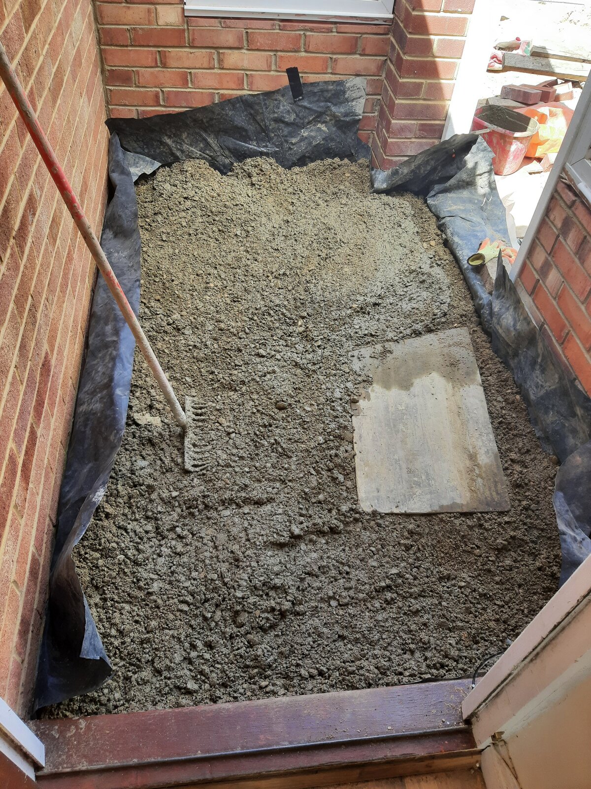

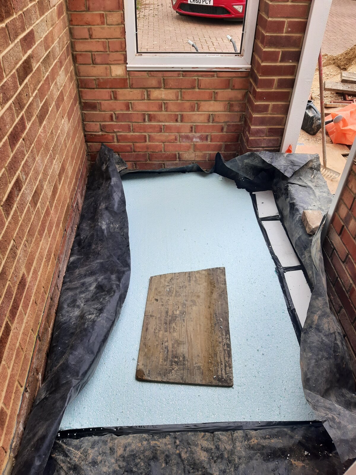

I have some anti heave foam board left over from a recent project. This weekend I was going to concrete the new porch floor with around 8inches of concrete to get upto dpc. Would there be any advantages to throwing this board in and putting concrete on top?
Thanks for your help
Thanks for your reply. Just to add this is the open cell foam a bit like an EPS sheet and not like the closed cell insulation stuff. Im not sure I can tread on this stuff without causing it to break unless I use a board to spread my weight and fill up half the area then move the board to do the other area. Still ok to use?
Yes.
You'll need a level, smooth and compacted surface beneath it, otherwise it would get torn to bits by the weight of the concrete.

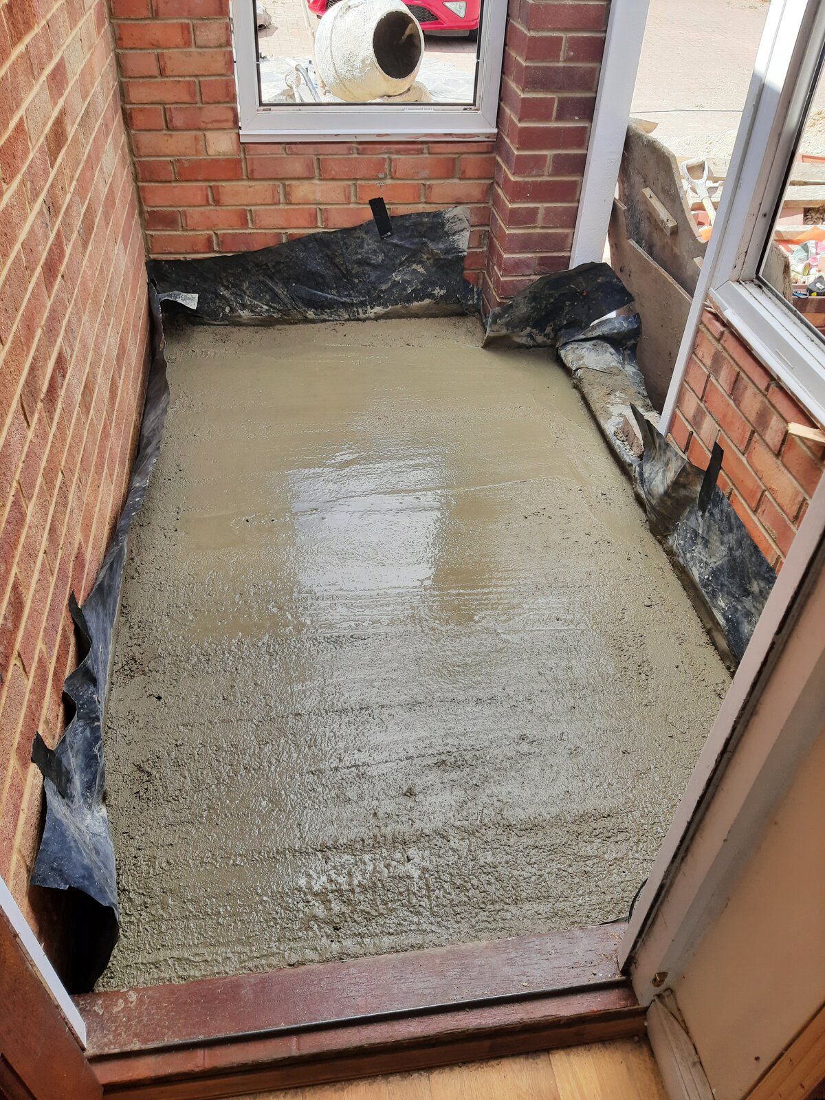

Yes I made sure the base was level. What is the minimum depth screed I can do, 20mm?

20mm (of anything, but what do you mean by "screed"? Liquid? Concrete? S&C?) directly covering your foam is a bit skinny, I'd do 40 at least
The foam has at minimum 6inches of concrete on top. The screed would be for final adjustment prior to fitting a laminate floor. I was also thinking self levelling compound but have never used it myself
Check the specs of the self-levelling products you're looking at. They all have different recommended depths, most are quite low.
