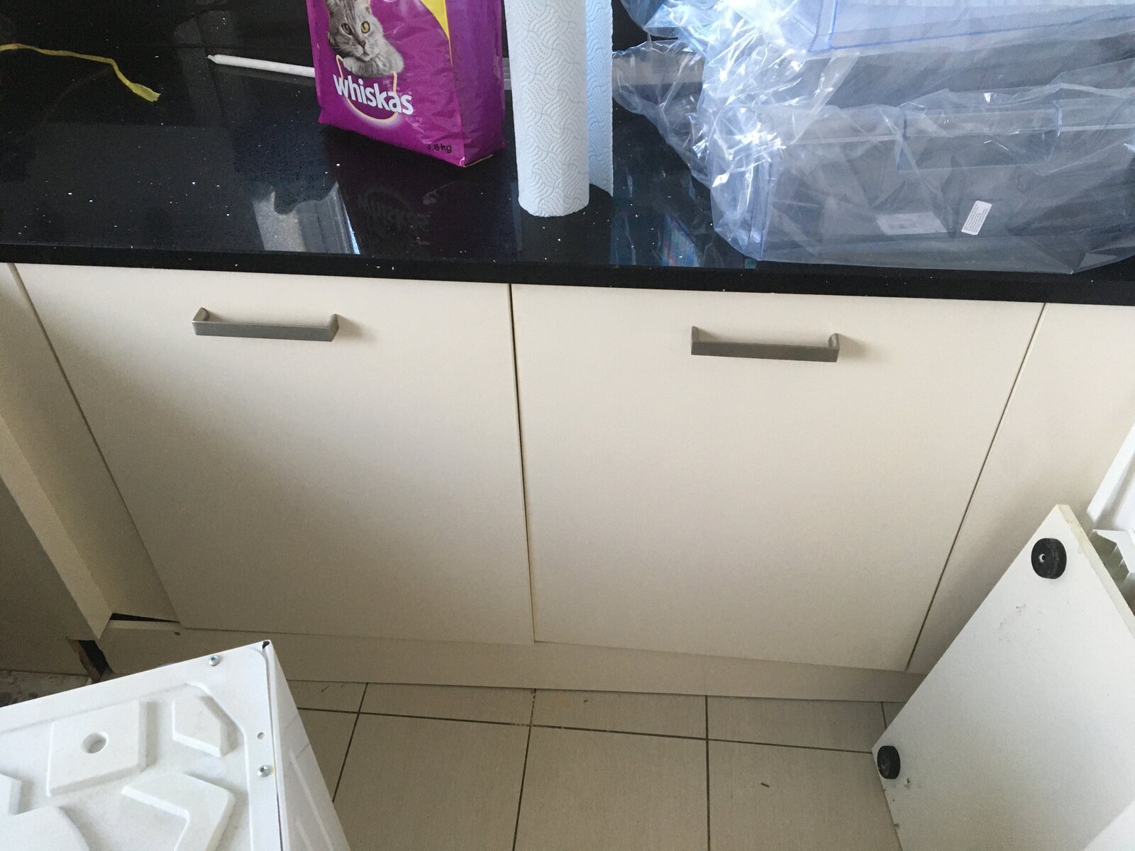

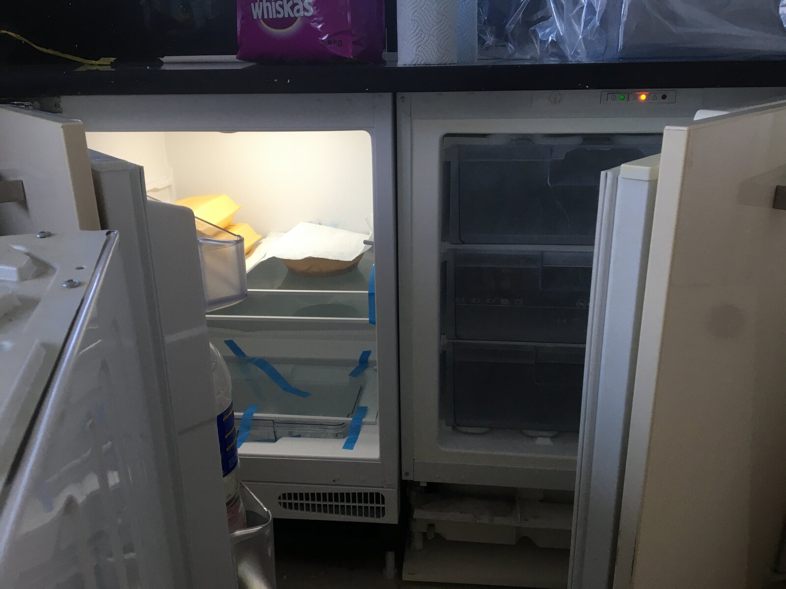

Hi you can see on the right the freezer is on a shelf. That's how the left was too.
What is the measurement from the floor to underside of worktop?

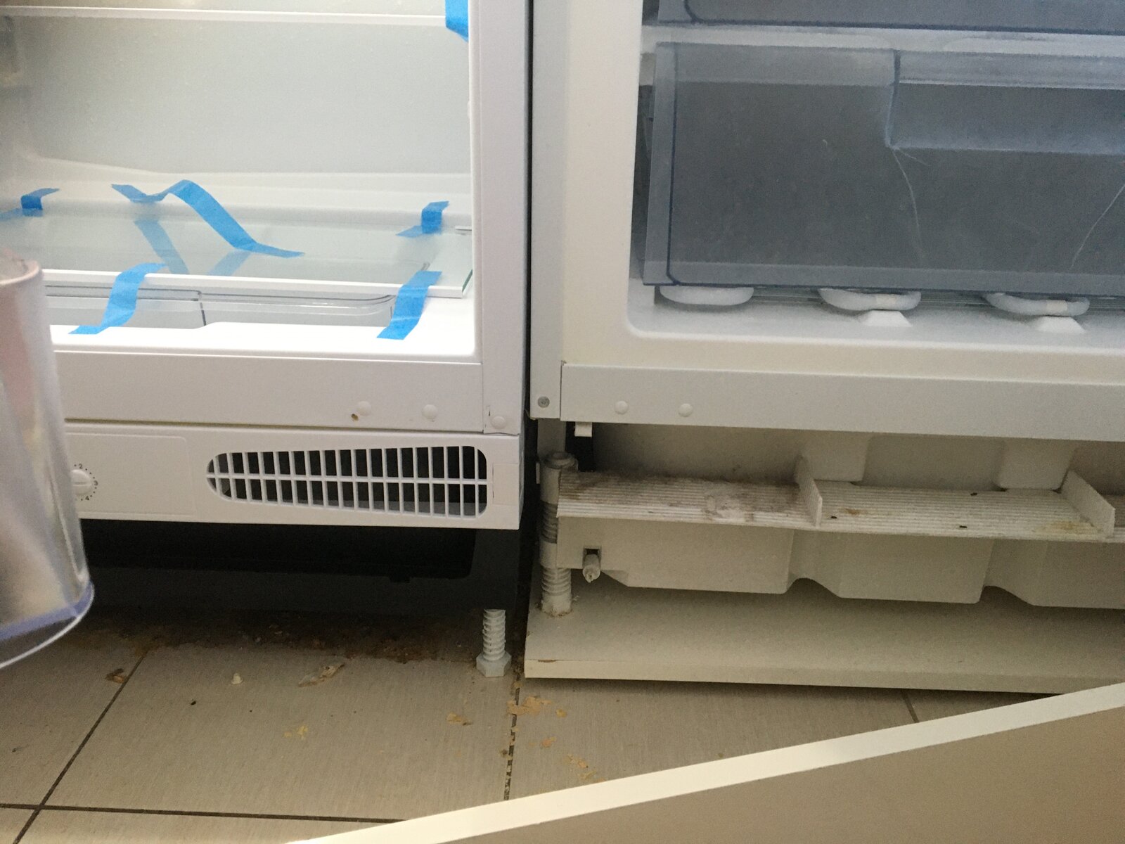

The freezer looks like a Neff? Think at 870mm height it should fit with legs extended to the floor. There should be a grill that covers up all this plastic gubbins, this usually sits on top of the plinth, behind the appliance door at the bottom.
I wonder if your worktops are a little high? hence sitting it on a shelf.
Whats under this shelf? as it doesn't look like it's sat well on the floor?
You should still be able to get these levelled up, so the door fronts are level and don't move when opened.

Hi so after the last post I couldn't remember why the currys install guy had taken the shelf at the bottom out and put the fridge directly on the floor...so I decided to pull out the fridge and put it back... in doing so... I realized the guy might have simply forgot...and to save face created some non-sense reason for not putting it back since it would require pulling it all out again after he spent ages fiddling with the feet.
So I pulled it out and put the shelf back in, I also realized that the fridges feet at the back were WAY shorter than the front... so I adjusted these so that the fridge wasn't so tilted backwards... and believe it or not...after about 20mins of adjusting and testing... I have managed to get the fridge to sit aligned with the freezer AND pushed to the top so that it does not rub on the counter nor is it moving around when you open the door.... I now believe the guy was just lazy and was trying to cut corners... rather than pull it all out and adjust the back feet repeatedly until it was right...he simply blamed the freezer and said get some sealant on the top that will solve it as nothing else can be done.
Can't believe we paid for that installation! but very happy that I have managed to get it to not move without glue or sealant was very concerned about the future if I had to take it out for any reason.
