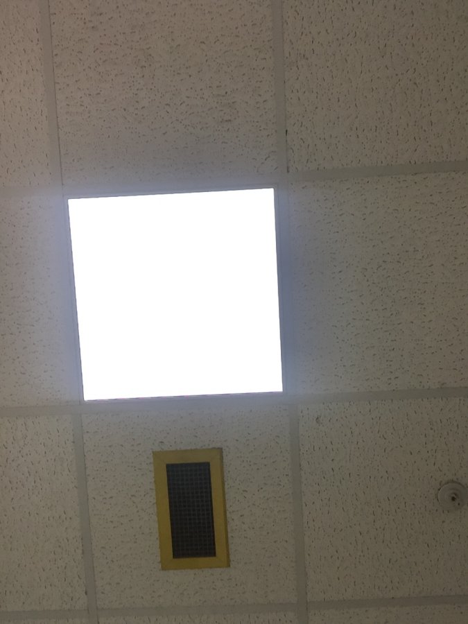

I would like to disagree with John, however I have to admit he is right. They are more flood lights than spot lights and things have moved on. But still believe there is an area v light output formula and if you don't have the area then does not matter how much output it does not help.
Take a 5 foot long LED strip and compare with the same strip inside a translucence tube and you will find the tube gives a better light. One would at first think having a tube over the LED's would reduce the light, but because it helps spread the light it works better.
I have looked at LED GU10 lamps. 16 times 1/8 of an inch is not much area, but the led uses 2/3 of that area for cooling so the real lamp is half the area of the MR16 it replaced. There is a good reason why most lamps have a opaque diffuser of some type. Area matters. Yes I use MR16 replacements for my bedroom reading lamps. They work really well. But the kitchen has one fluorescent and one LED tube, and the other two rooms LED candle bulbs, above stairs a 18W fluorescent emergency fitting HF type, and bedrooms have in the main LED bulbs with one or two of the old CFU plus a 2D above one bed that is a bit of over kill 18W is far too bright. Point being there is a place for every type of light.
