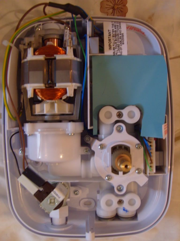

Sorry but i'm getting really confused. Remember this is an integrated power shower with the pump inside the unit on the wall. I removed the two small metal coils from the hot and cold inlets and they were perfectly clean but no water despite pump running. I think it is an airlock somewhere in the pipework leading to the shower but where do I start to sort that out?
forget running the shower isolate the power.
isolate hot/cold.
remove filters.
open hot is it running freely ?
open cold is it running freely ?
i want to know is water running from hot/cold filters.
if so replace fiters.
then we will go from here.

if your not getting any flow it must be both.
uncommon for them to both get airlocked unless tank has run empty.
would it completely stop the unit sucking in water from both hot and cold tanks?
the pump does not suck it pumps.
the flow to the pump is only gravity.

Just realised when I removed the filters I still had both hot and cold supplies turned on so does that mean there is an airlock on both?

don't know how long the showers been in or if you fitted it.
but this is how you prime these showers without the pump running.
when you check if water is running from the filters get something to cover the pcb on the right etc or tape a carrier bag under the filters.
saves any internal damage.
if you removed them without turning water off then yes.

OK - Now I feel really thick. I had removed the filters for the bottom inlet but mine are straight in from the back. Tested these seperately and both flow. I cannot however manage to remove the filters to check if they need cleaning. I tried tweezers without success - what should I use and what is my next step please?
useally a small flat screwdriver will lift them out or long nose pliers.
if your pipework comes in from the back they will useally enter the top fittings.
OK - both seem clean but have swapped with the unused ones from the bottom inlets just in case.
What do I do next please?
p.s It was top entry fittings
the pipes enter the top fittings.
you get water out of the bottom filters but none out of the top filters ?
No - Top fittings are the supply and I am getting hot and cold from the top.
It was just that I swapped the filters from the unused bottom ones to the top and vv.
Shall I put everthing back together now and see what happens?
