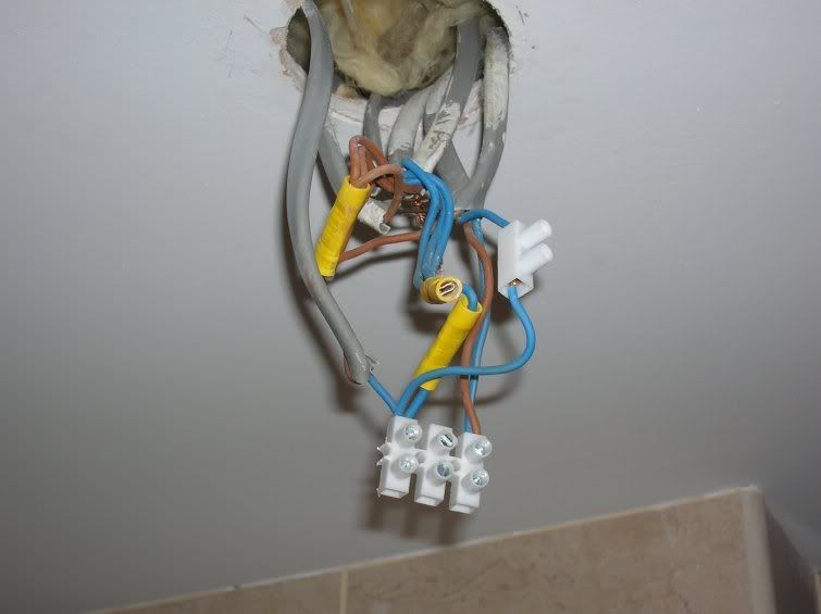

I know how much everyone loves piccies so I thought I'd share these with you. These were found in a brand new build..... the builder was using his usual subby spark but he 'vanished' before he could certify the completed works....... I wonder why ?
The PIR had two full pages of faults.......... I wish now I'd taken photos of some of the other faults.. including burnt out transformers, 4m main tails run horizontally with no support
This mess was attached to one of four downlighters in the en-suite...... thats 7 T&E cables there with the bare CPCs just twisted together :?

Hey, not bad!!!
Very similar to the 14 seperate T&E with multiple junction boxes I found buried in the door frame 2 years ago!!!
So the number to beat is 7 in 1, lets start looking, easter egg for the winner
