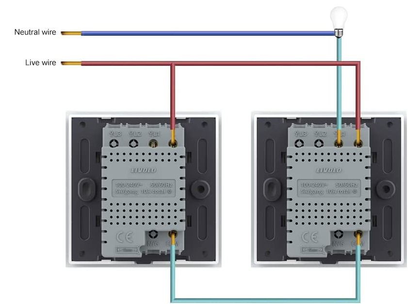

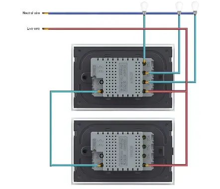

I have to agree with @JohnW2 the diagrams 1676558663735.png do not follow the traditional way used to wire up light switches. This 1676558838570.png is confusing, two way, three way, diagrams only showing wiring for two switches, but pictures showing three switches.

I have to agree with JohnW2 the diagrams do not follow the traditional way used to wire up light switches.
They are not traditional switches.
One actually operates the light(s) and others, while exactly the same design, merely COMmunicate with it (when paired with it).
They are not traditional switches. One actually operates the light(s) and others, while exactly the same design, merely COMmunicate with it (when paired with it).
Quite so ... as I wrote ...
.... What the OP appears to have, on one plate, is two switches (hence "2-gang") with 1-way ("SPST") switch functionality, each of which can be toggled on/off either locally or from a remote switch (via a signal connected to the "COM" terminal). Since the unit needs to know which of the two switches is being addressed remotely, I assume that the 'signal' has to be something more complicated (i.e. 'coded') than just a present/absent voltage.
... and, as I said, to use the marking "COM" (which has a very-long-established meaning) to indicate a "COMmunicate" terminal is just plain confusing :)
