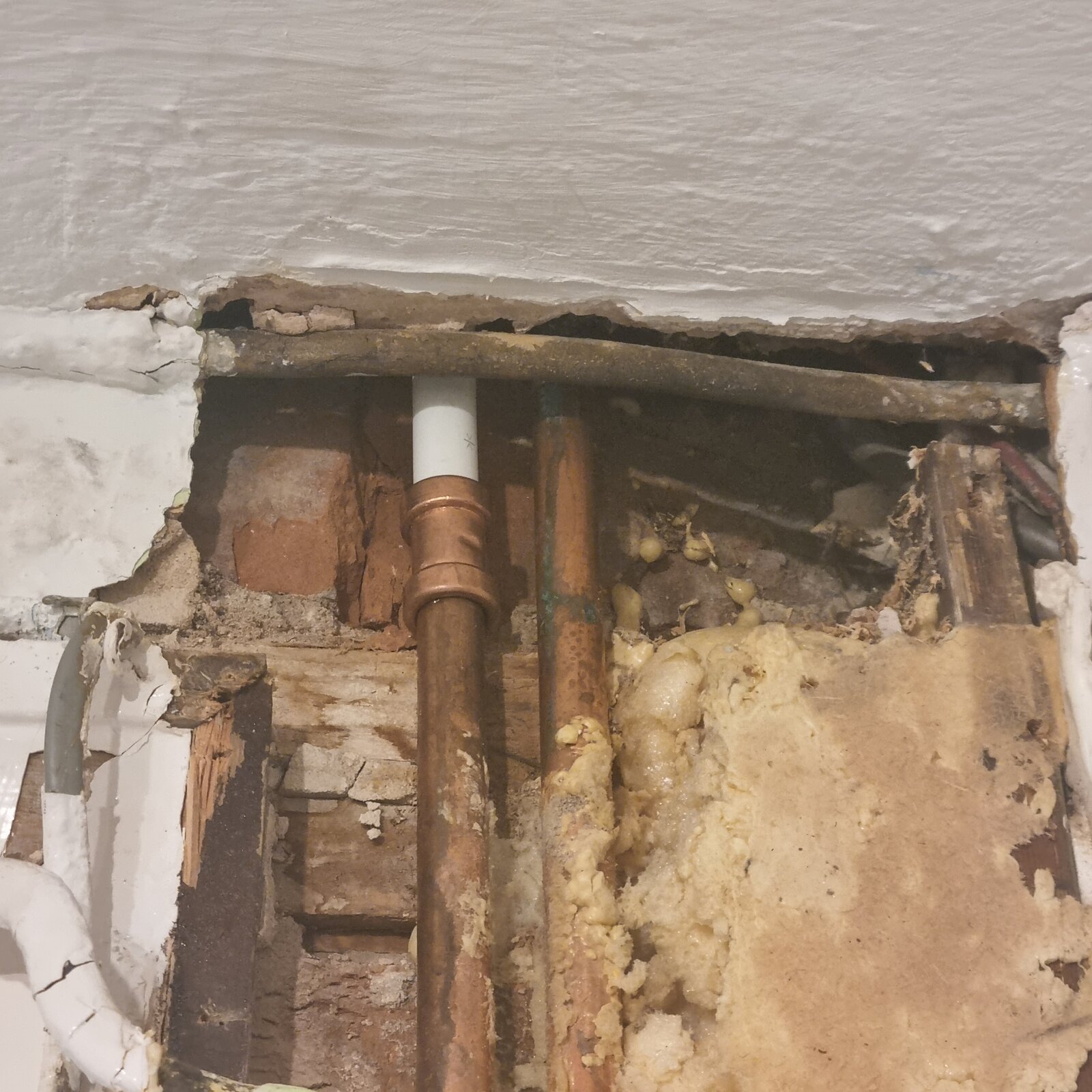

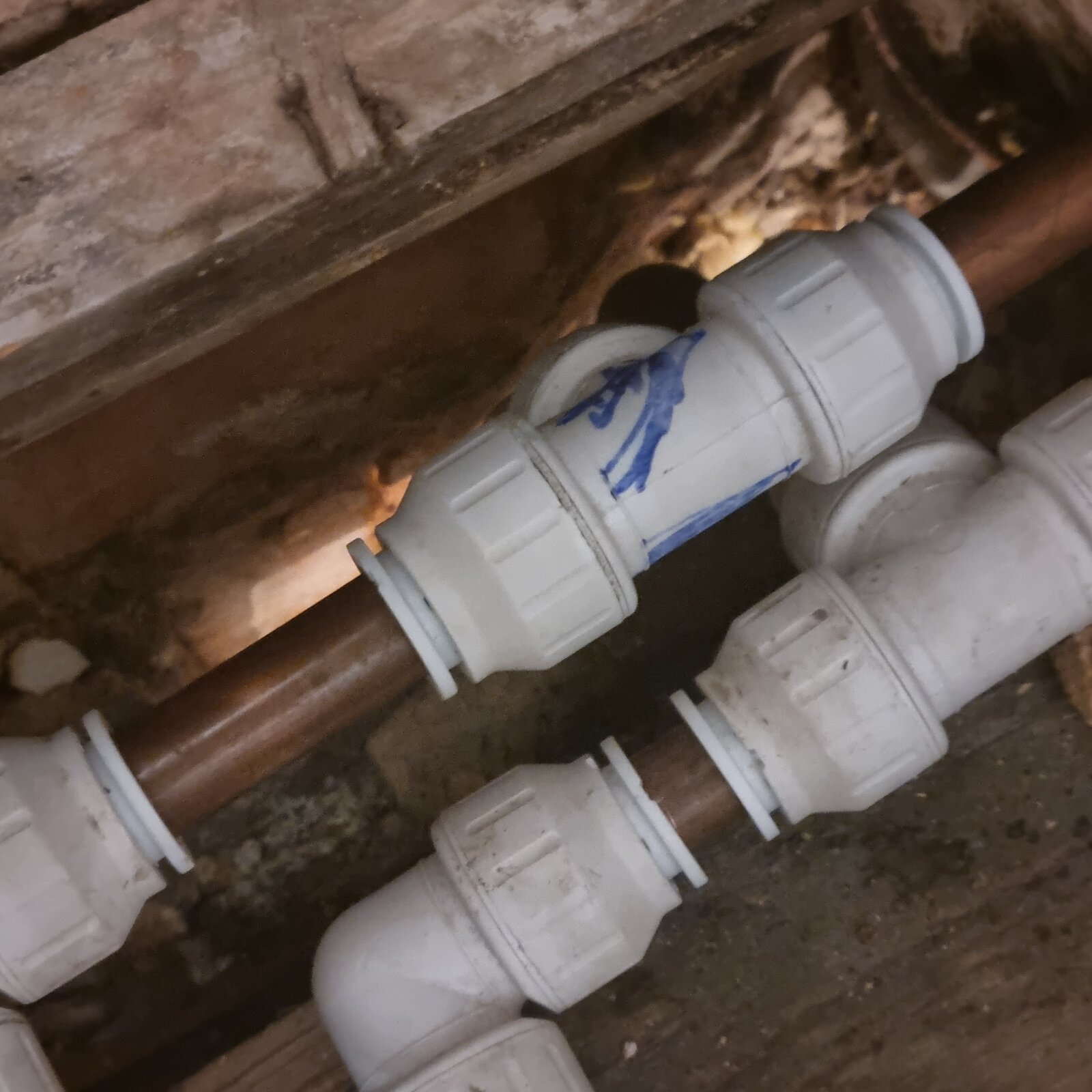

Hi please can someone advise....
I currently have the floor up in the bathroom due to a new suite. I have teed off the hot and cold feeds to supply a new floating sink and wall fixed shower mixer. The hot and cold tees then run from the bathroom down the wall into the kitchen. Since doing this the kitchen tap hot water...old mixer tap is only getting hot water intermittently (good pressure, just no hot water. I have checked the boiler when the tap is on and its not firing up when called for downstairs. The newly plumbed hot water feed is working upstairs and boiler calls so i think that rules out mispiping and a boiler fault. I have checked all pipes back and they are correct. Please any one advise on this highly annoying issue.
