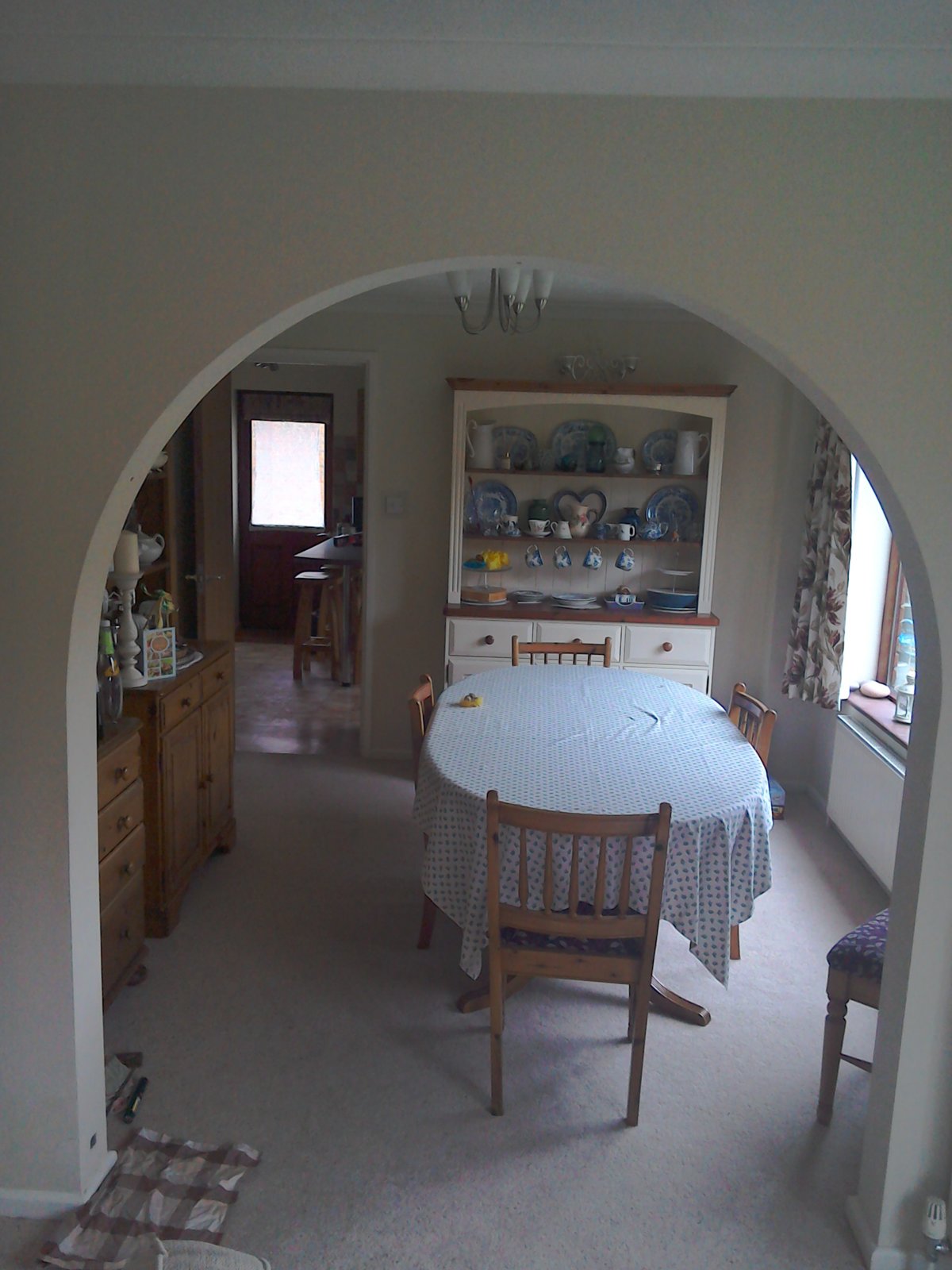

We have an internal archway that we would like to remove and square off. The house was built in 1989 and the interior walls are plasterboard.

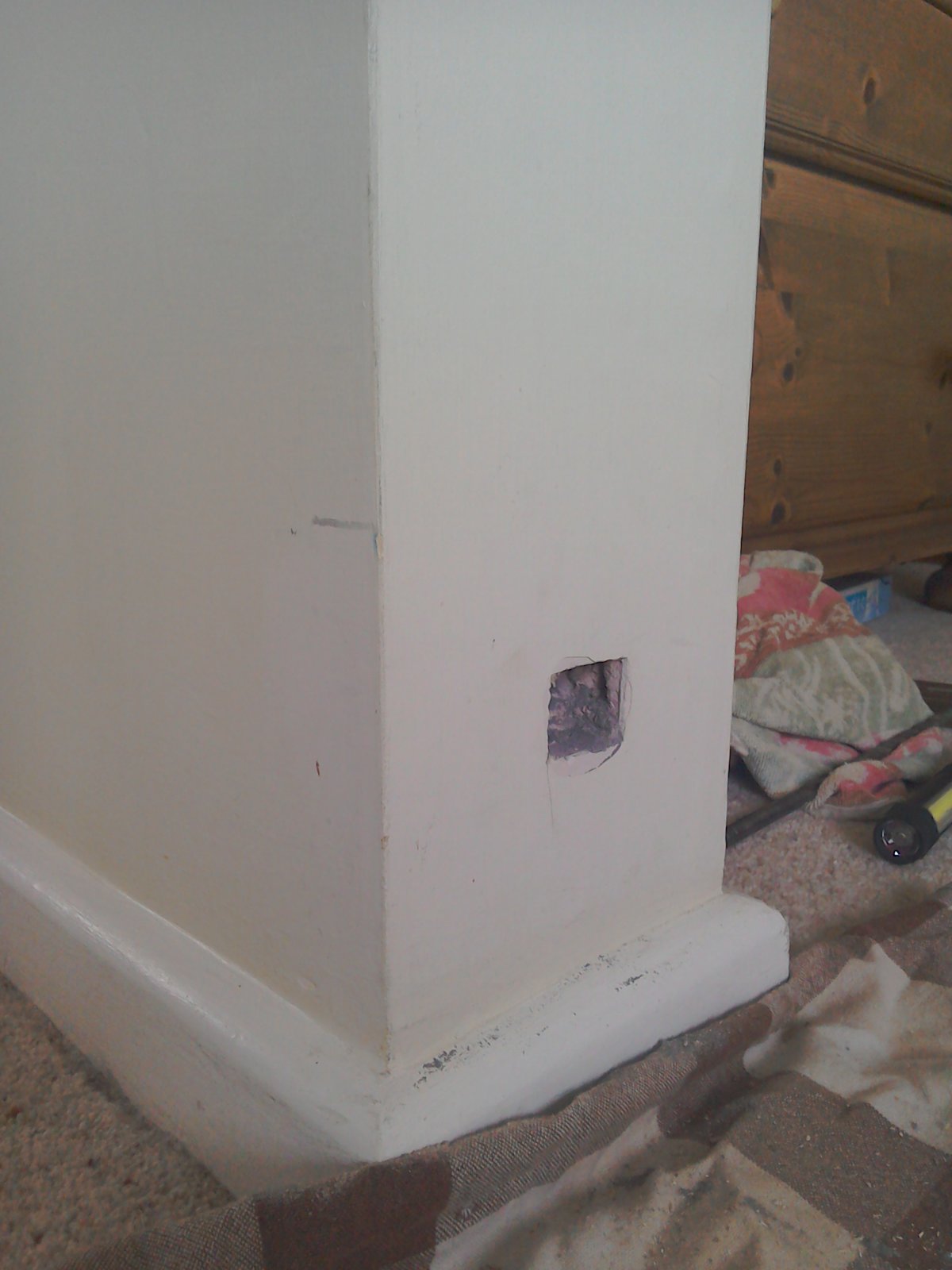

I have removed a small square of plasterboard at the bottom of one of the vertical sides of the arch (photo 2). It appears that the plasterboard has been attached with plaster blobs to breeze block. I assume the breeze blocks would run from floor to ceiling?

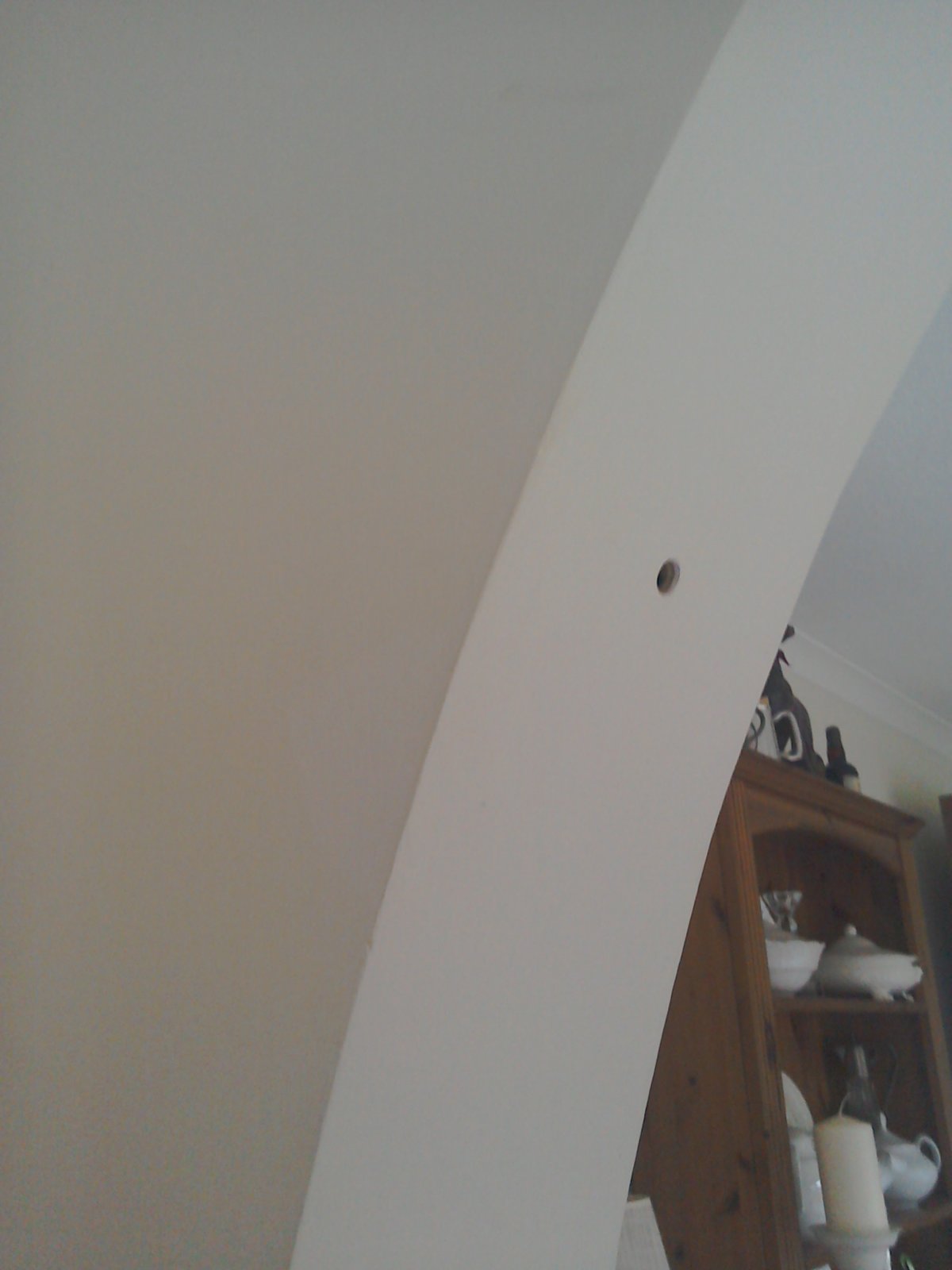

I have also drilled some pilot holes to try and find out how the arch is constructed.
I have drilled into the side curve of the arch (photo 3) which confirms, I think that there is breeze block running vertically from floor to ceiling. Does that seem most likely?

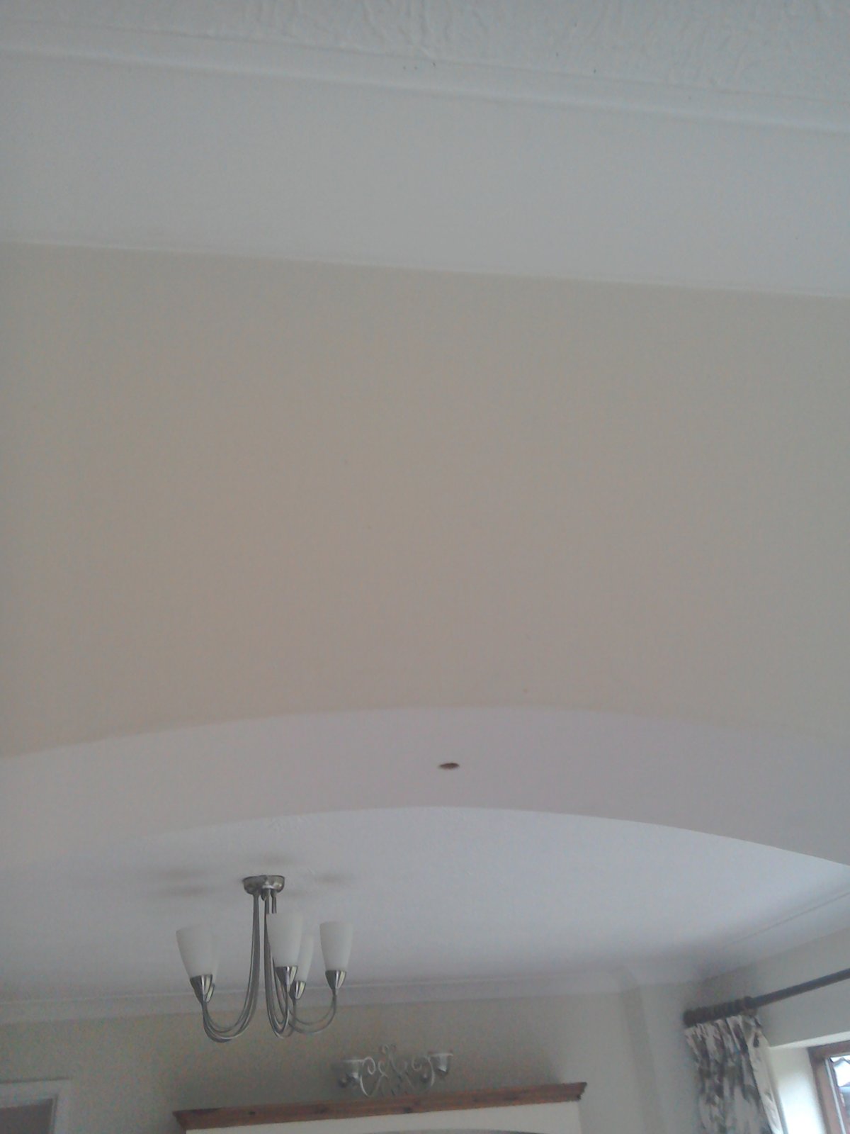

I have also drilled into the top centre of the arch (photo 4). As the drill bit goes through about 7 inches without any resistance, I assume there is nothing supported here. When the drill bits goes through 7 inches it feels like it hits wood rather than brick, but am not entirely sure. Would you expect there to be a wooden cross beam here?

The existing arch is about 6 feet wide at the base.

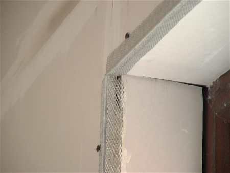

Plastering corner bead as in pic
If you try and cut the plaster/plasterboard as neat and straight as possible to the width of the opening, then you can just sand the skim off around the edges and fit the beads with minimal blending in

Main things I have learned here from the forum is to cut out the arch very carefully, then replace with plasterboard and skim on top, not using any wood as it will look better all in plasterboard. I will need to add thin metal corner beads along the vertical and horizontal edges before adding the skim.
