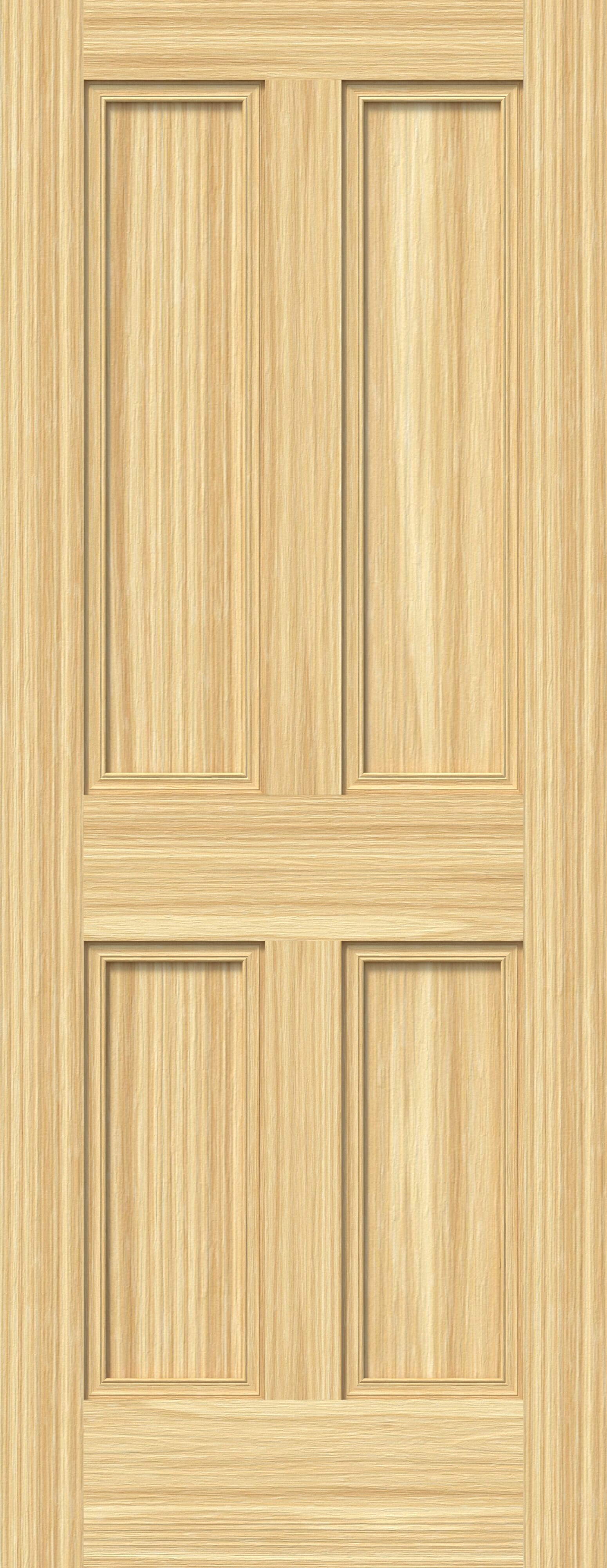

Choose any “pine” internal door from any DIY shed or any online door supplier. Example:
Quote: “Constructed with a durable particleboard core wrapped in a beautiful radiata pine veneer”.

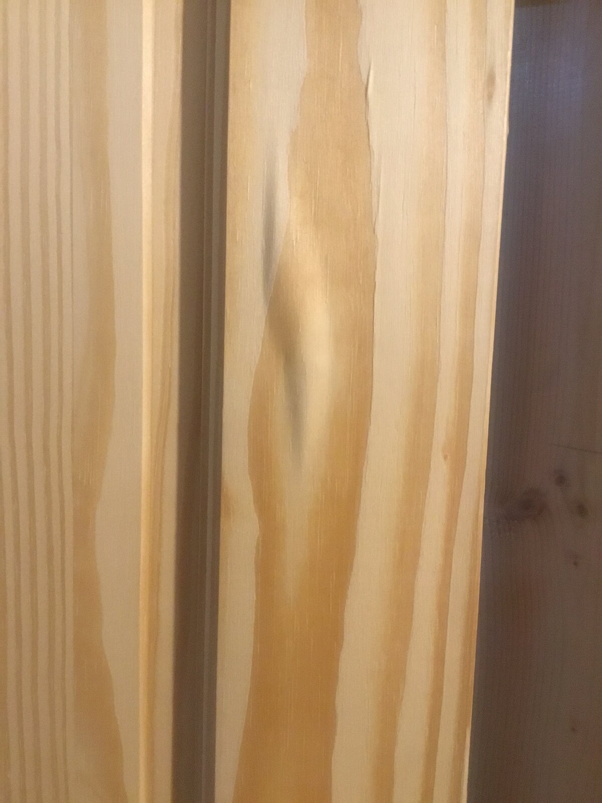

Well I should have listened to the reviews. I’ve spent the afternoon hanging it and giving it a first coat of varnish, and 2 hours later it is starting to crack, bow, fail or peel. The pine veneer has raised in a hard blister in a few places:
The varnish is a Ronseal water-based satin product.
See the terrible reviews here:
What a disaster. I could certainly return it, but then I have to choose an alternative door (back to my original question, are the more expensive ones any better?), and then spend another day fitting and finishing it. Or, I could try to flatten the blisters!
