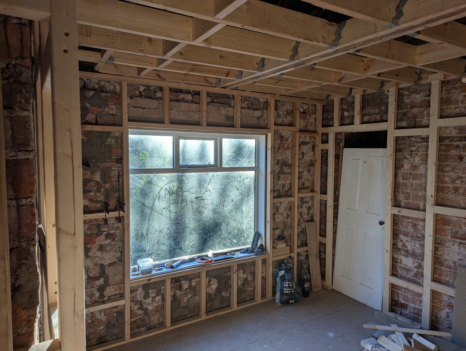

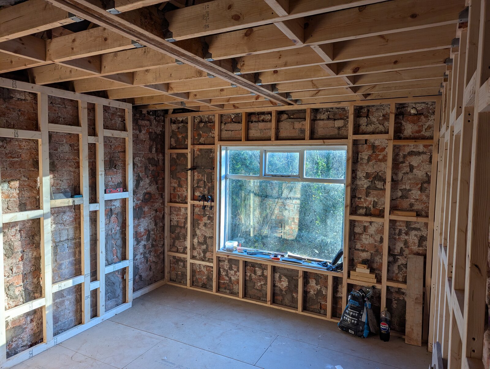

Hi everyone,
I have a very old house. Around 1830. I've took all the plaster off the internal walls and have battened all the walls. Floor to ceiling. Nothing is attached to any of the brickwork. Could anybody advise me on the best insulation to use. The outside is brick no render. And it's single 9" brickwork.
Thanks in advance.

Thanks. Did you consider putting foam backed plasterboard on the walls?
Now you have battened them, you can put 50mm kingspan PIR insulation in all the gaps. Foil backed plasterboard on top with all joints sealed meticulously to stop vapour getting behind.

You could, but it's the same thickness as the separate components, and twice the price.
Insulation is one of those things you rarely regret putting more in, but can often regret not putting enough in
Could I use insulated plasterboard? If rather not have to take anymore of the room size.
Cheers.
You are better off using separate components as this affords you the benefit of being able to stagger the joints, being able to tape the joints and not have to bother with landing on an upright (insulation only).
