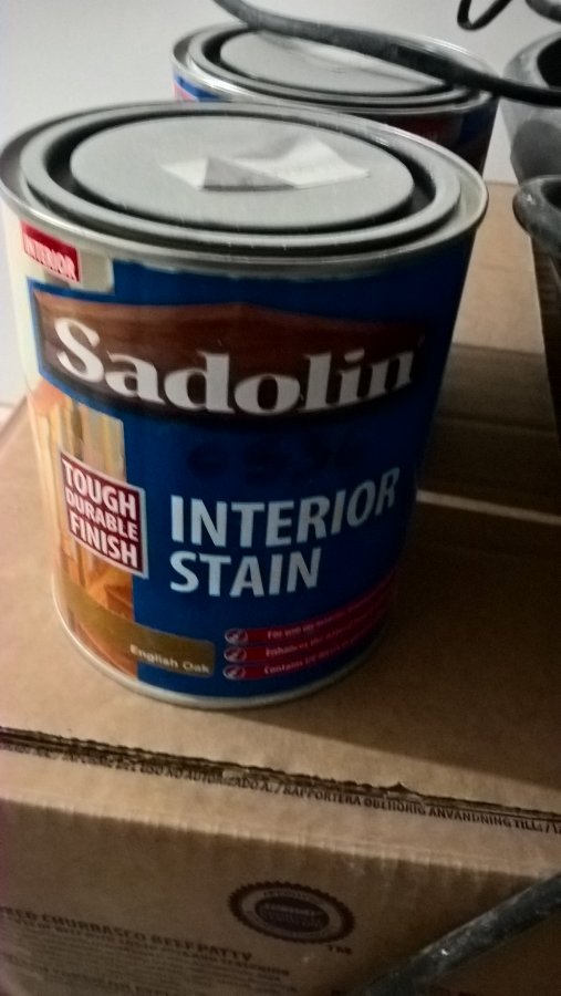

As promised, here is what Howdens sold me with the doors suggesting that it "was the best thing for it". Thoughts?

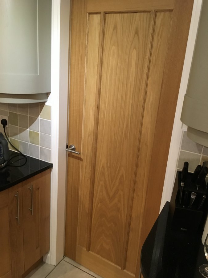

I have 14 oak veneer door in my house that were all fitted when we had the extension and pretty much everything redone. I used Osmo Polyx hard wax oil on mine after a recommendation. Super easy to apply and looks brilliant. It's a bit pricy for a tin but it does go a long way. I read a lot of threads that suggested some finishes may lift the veneer but a number of people suggested it would be fine, and indeed it was.
Thanks and that does look very nice. Is that clear satin or a different finish? How many pots will I need for 12 doors??

I would trust Howdens and Sadolin. Sadolin products are very good ( we used it on the timber frame house we built ). Give their technical department a call and ask about using their internal stain on oak veneer. It would help if you can tell them the thickness of the veneer. The good thing about many of their stain products is that the timber can be re-stained ( maybe 5 years later ) without having to strip of a layer as you have to do with varnish or paint.
Phone number on http://www.sadolin.co.uk/contact-sadolin/

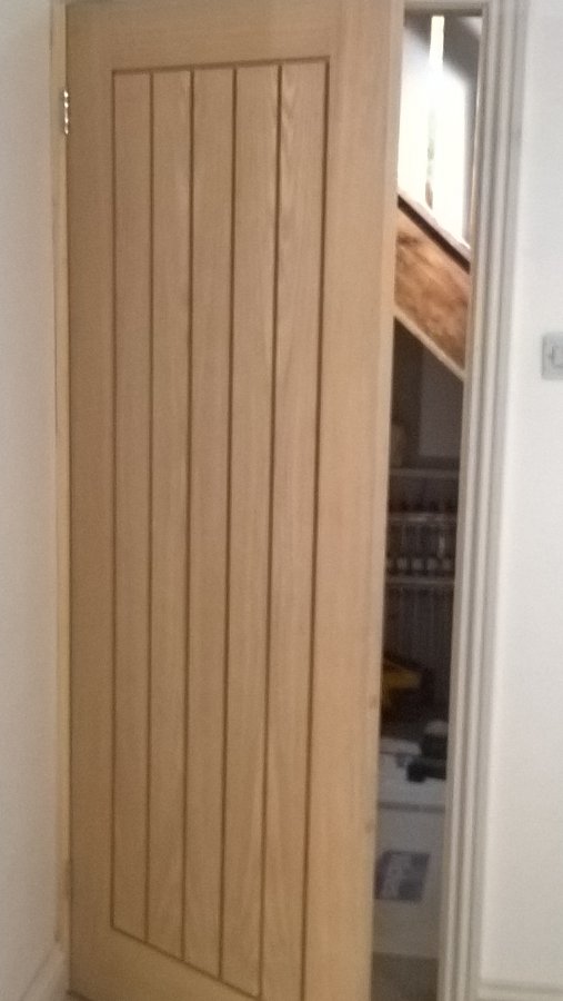

I must say that I am impressed by the picture shared by @Russ Marshall. I assume my current doors (picture below) will also look like this if I go down the osmo route.
Something also tells me that Osmo is a much simpler application than stain/varnish...

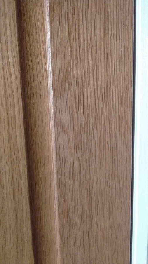

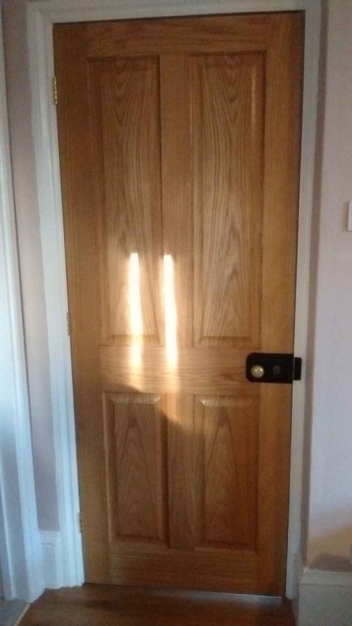

Pictures below (sorry about the low quality but house getting too dark for phone camera)
I like osmo because simply to apply and when it gets scratched or worn off I simply lightly sand the damage and wipe on another thin layer of Osmo.
I applied this in the following way:
1) Very thiny brushed on first coat left to dry (over night).
2) Very thinly brushed on second coat left to dry hard (say four night).
3) When hard I very lightly sanded with 1200grade wet and dry (using it wettened with clean water).
4) Very thinly brushed on third coat.
Note that I used "Osmo Polyx Oil, 3032, Satin, Clear".
