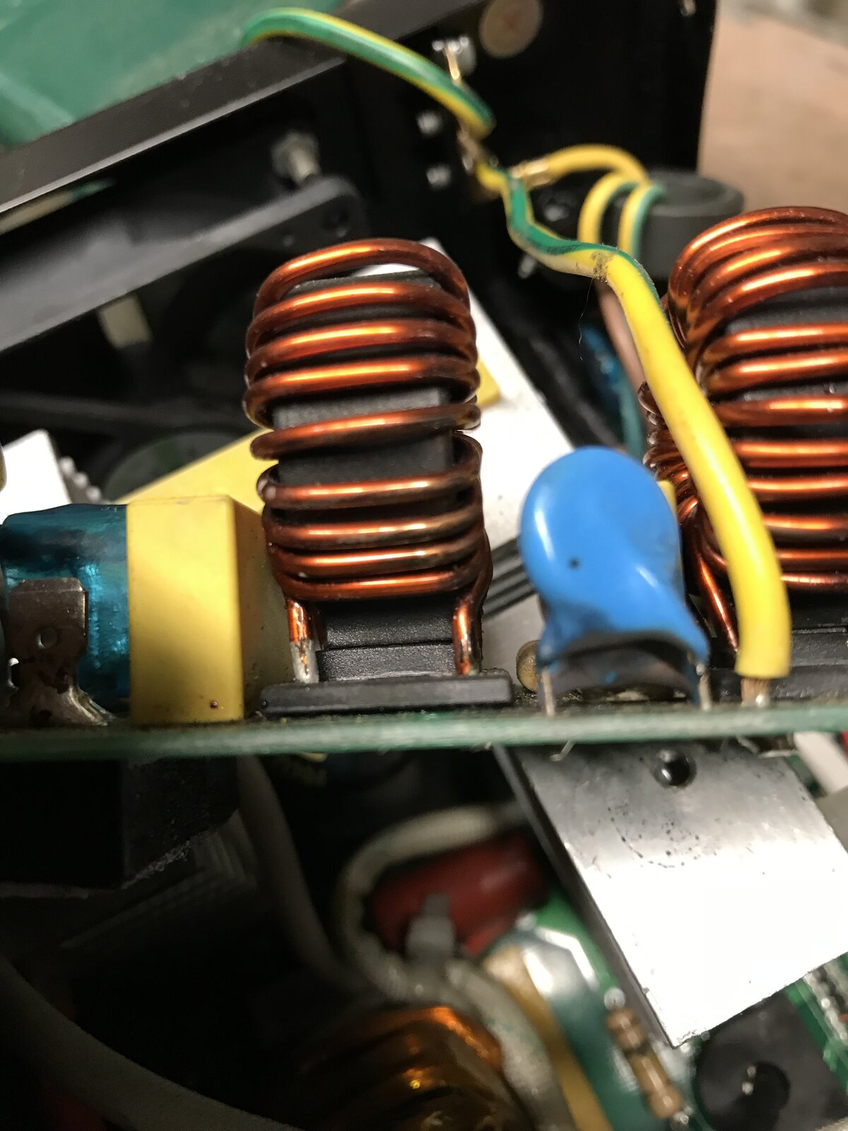

I’m not an electronics expert so I’m not sure what’s happened. Inside the only damage I can see is a little flash mark on these components.
They seem to be on a mains input board which supplies a bridge rectifier.

I’m not an electronics expert so I’m not sure what’s happened. Inside the only damage I can see is a little flash mark on these components. ... They seem to be on a mains input board which supplies a bridge rectifier.
No 'tracking'/damage on any of the PCBs?

No I can’t see any sign of any damage at all apart from what’s in the photos!!

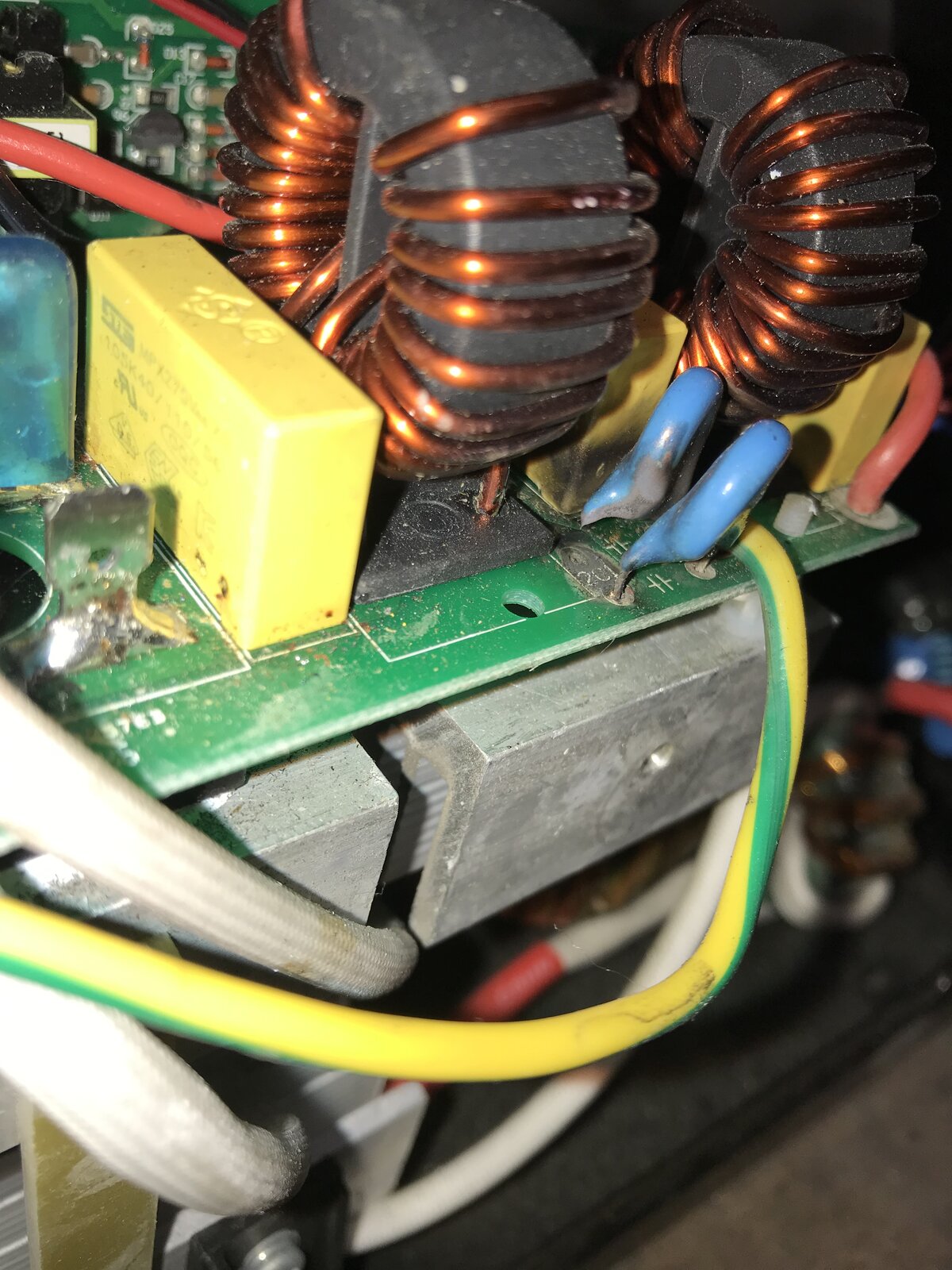

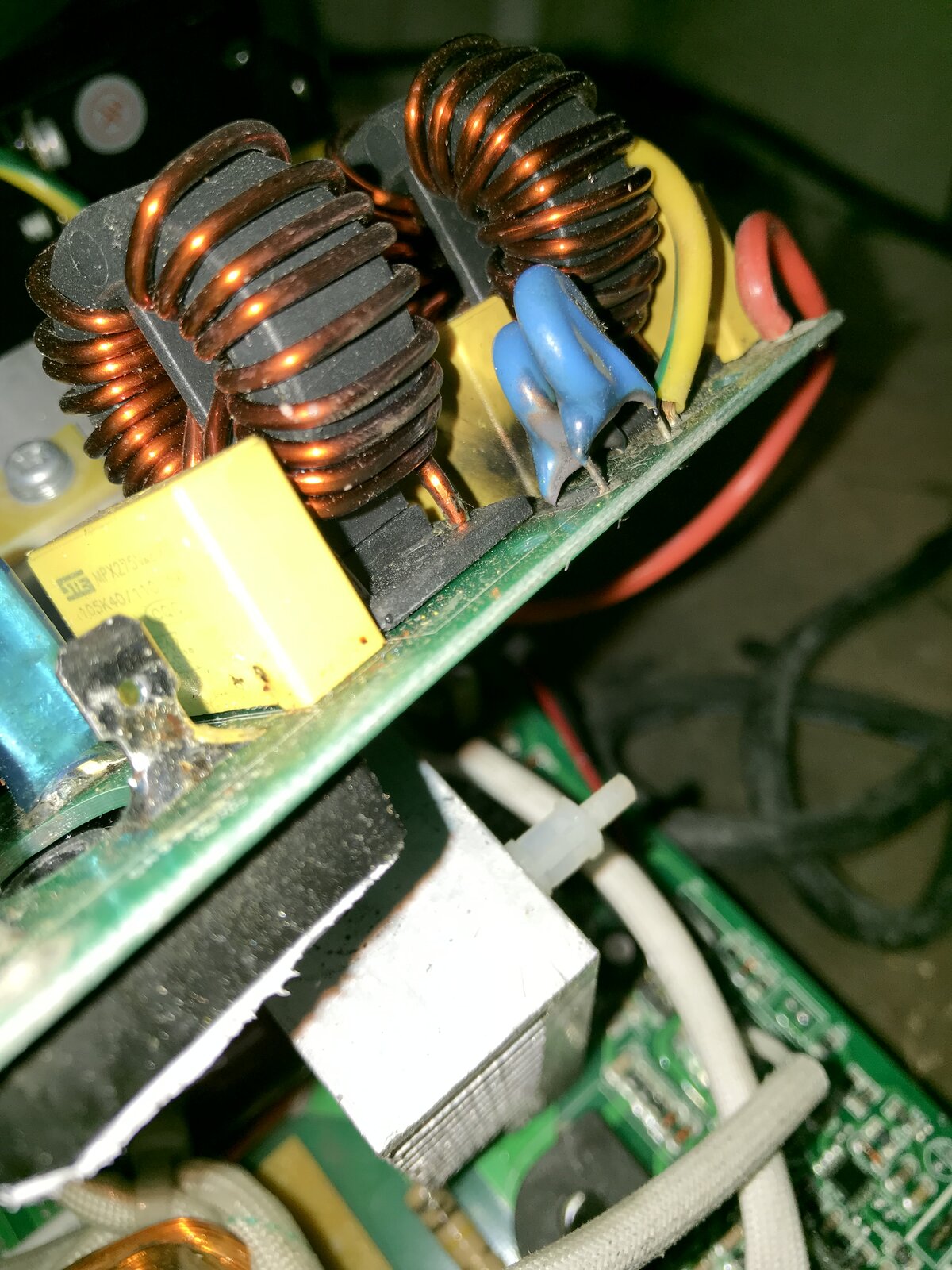

Just done some more looking. It looks like something has flashed over here. I thought they look like MOVs but the symbol on the PCB looks like a capacitor? I really don’t know enough about electronics

They do look like MOVs to me, should be able to identify the voltage rating from the side of the least burnt one. Cheap enough to replace. They short the supply by design to prevent voltage spikes, but I've found them to blow if the fuse doesn't trip soon enough.

They certainly look like MOVs to me, though as you say the legend on the PCB suggests they are capacitors, but I suspect that's not the case. I f you can confirm they are MOVs then this might be a suitable replacement
https://cpc.farnell.com/epcos/b72205s0381k101/varistor-13-5j-385vac/dp/RE03669?st=MOV
but check the quench current ratings of the original, a higher quench current might be needed. If so, look here:
https://uk.farnell.com/w/c/circuit-...-suppressors/tvs-varistors/prl/results?st=mov
MOVs certainly often look like that (and, as you say, hopefully some markings might clarify) - although that obviously doesn't prove that they are! As you say, that could explain the trip, but it wouldn't explain what RF appeared to be describing as having happened at the business end of the welding electrodes - maybe that was just a red herring?
