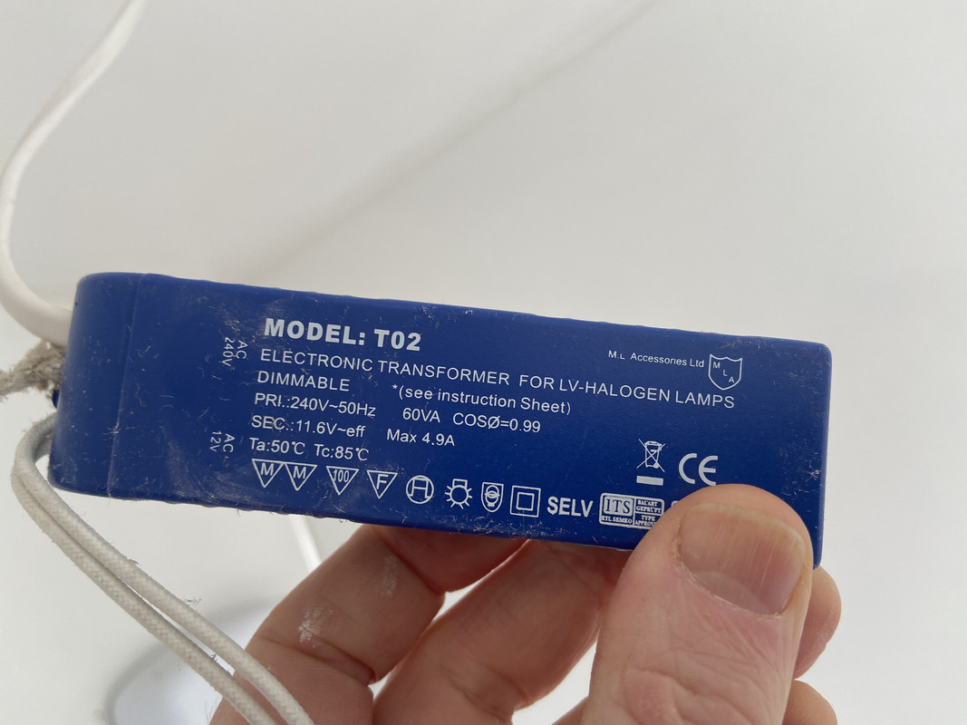

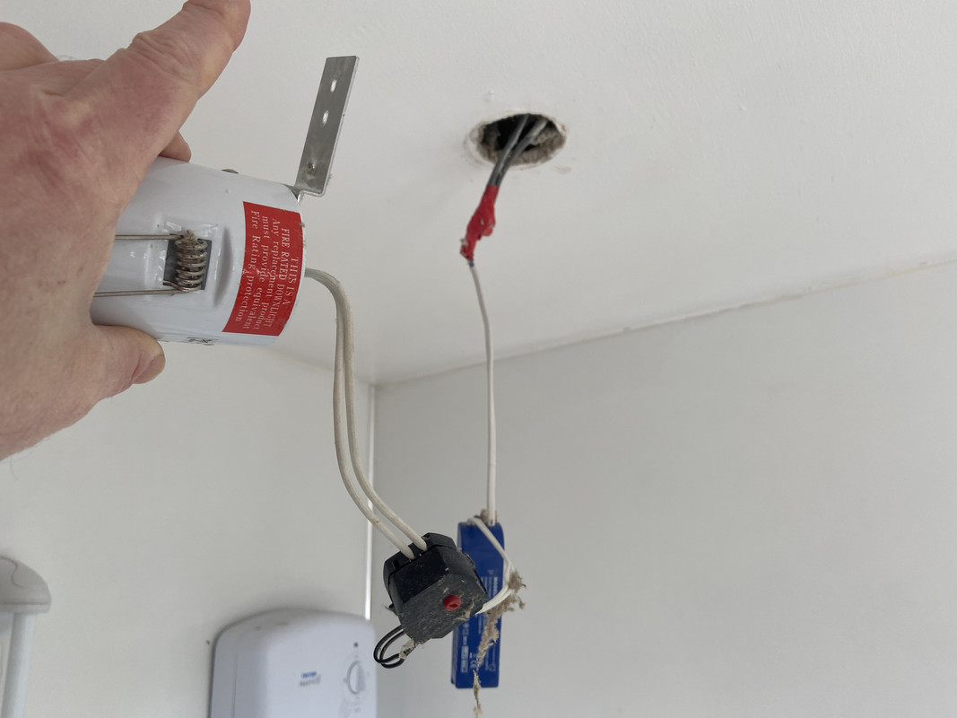

My lights are looking rusty so I thought I’d replace them. Only the light above the shower looks fire rated, the other 5 not.
Could you look at the wiring and let me know if anything looks beyond a DiY install? Thanks.
Shower:
The others:

Ok. Unless it is another property above, fire-rated is not required.
As you are asking, then - possibly.
Thanks, no there's just roof space above.
There is some loose insulation present though, and I think some of the lights are pretty tightly packed in by it, which is a concern.

Also suggest you get 240V light units (remove and throw away all the 'transformers').

It is. The instructions on the new lights will state the clearance necessary and also if they are suitable for bathrooms.
Just get 240V ones. There is no point in bothering with a transformer.

Very good info, thanks. I was wondering about the transformer on the shower light.
I've had a dig around the loose insulation and it looks like it can be shifted away from the light units.
