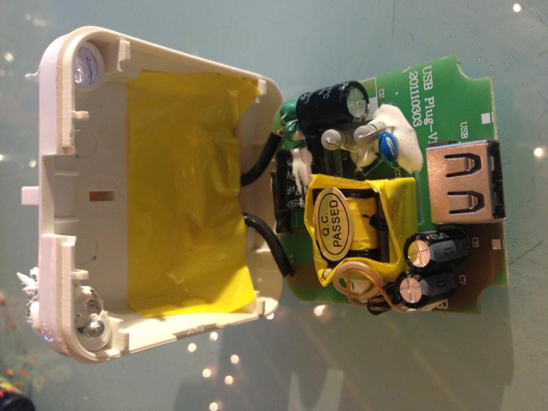

As promised, Masterplug charger from Sainsburys:
Not a massive amount off difference, besides copious amounts of glue thrown on everything, and a slightly larger csa cable connecting to the pins. Good to see the Line is fused though

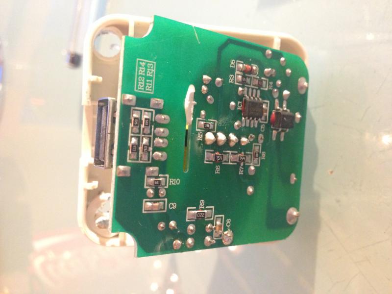

A view of the other side of the pcb would be useful. To see what they did with the data lines.
Think you have missed the point! It does not matter how cheap or badly constructed the item is what is in question is when it failed it exposed line terminals. Which if a child found before the home owner could be lethal.
I personally could not care less is a ebay item fails. What I am appalled at is it failed exposing line connections.
