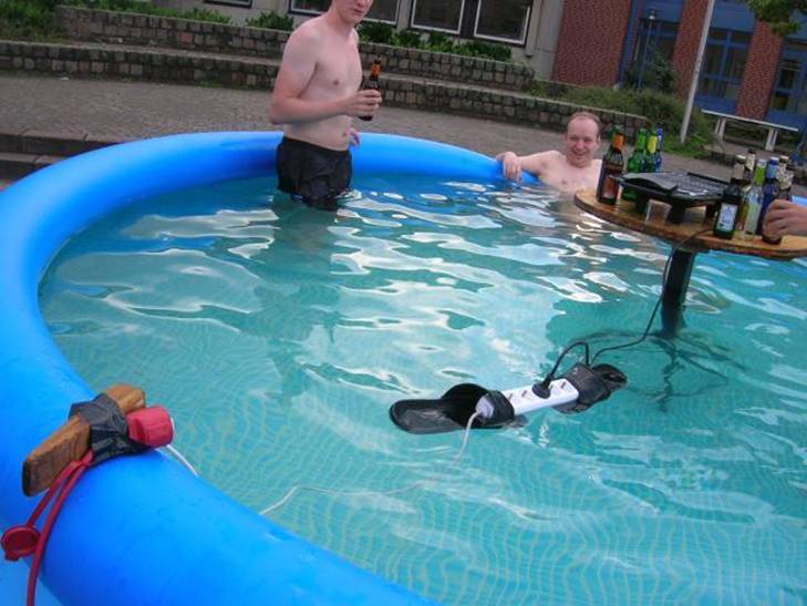

But BS 7671 is not law, so more down to what you think is safe. I suspect this is a set up for a photo shoot, Accident-Waiting.jpg but I wonder what anyone does with that water after, it is a lot of water, if I had one of those emptying it would flood a house lower down the hill, since on a water meter not really going to happen, but in a garden clearly nothing electric should be when it is emptied will get wet.

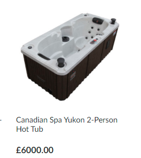

Indeed, particularly given that Section 701 of the regs is all about locations containing "bath tubs" (which, in use will usually contain hot water), I'm not particularly sure what a "hot tub" actually is. For example, is this "hot tub" a "hot tub" or a "bath tub", or what? (unless I'm missing it, I see nothing in 702 which says that it only applies to 'outdoor' things) ...
As I keep saying, in terms of common sense (aka the 'spirit' of the regs), it seems obvious to me that any container designed to be filled with water in which people will be at least partially immersed should be treated the same, in relation to electrical safety, regardless of what it is called. Is that not the case?
