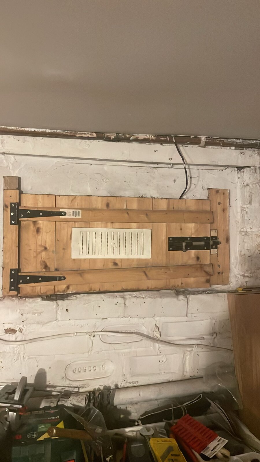

No ventilation st the front but have got a hatch at the back that isnt sealed and lunks with the underneath of some old decking. Checked for leaks such as btoken pipes and it's a general dampness from the front walls. An old coal chute did exist and appears to have been blocked up well, so I believe it's general water pressure most noticeable at the bottom 3 ft across the front of the property. The walls are not tanked. The dividing walls are nice and dry.

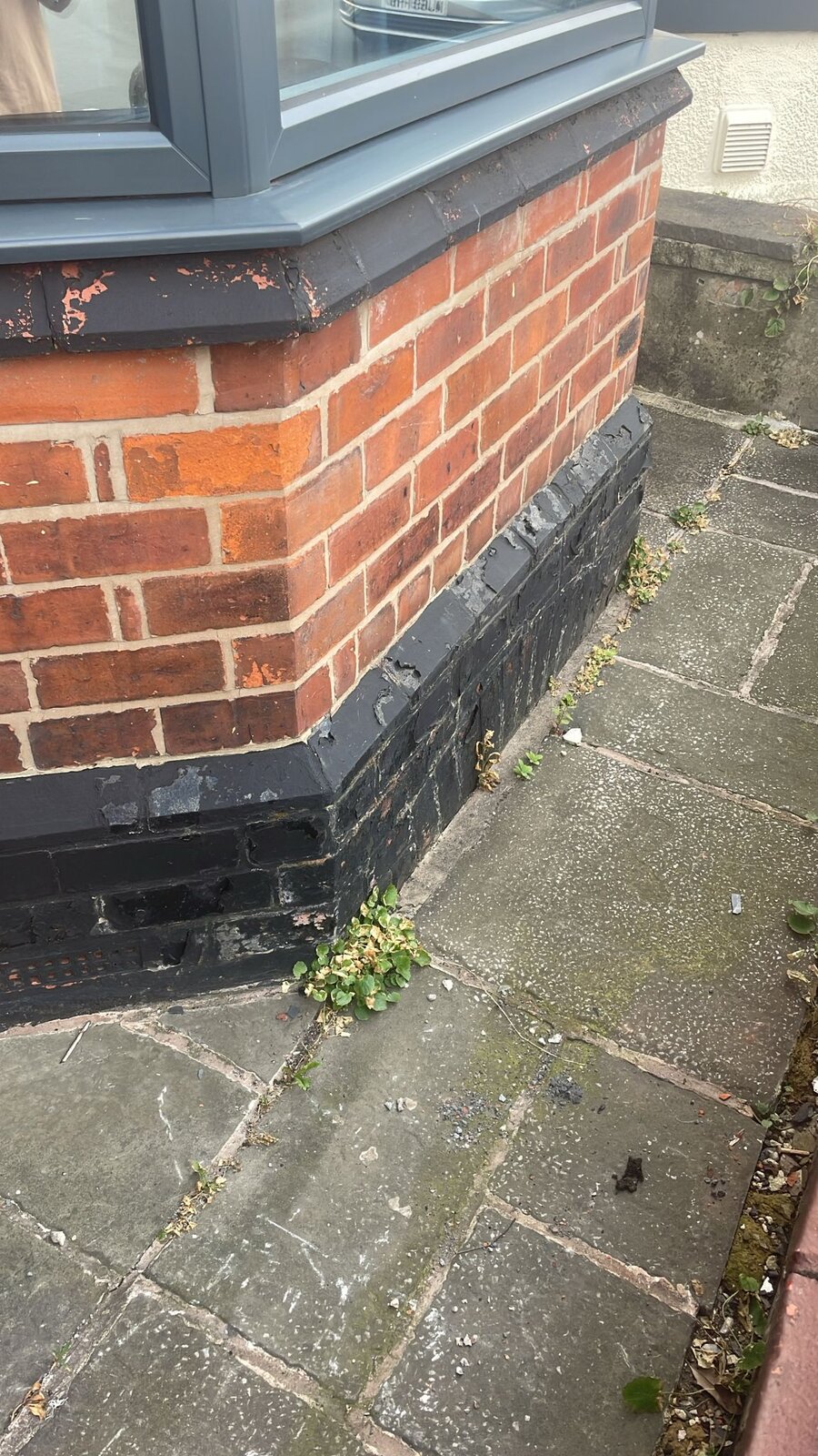

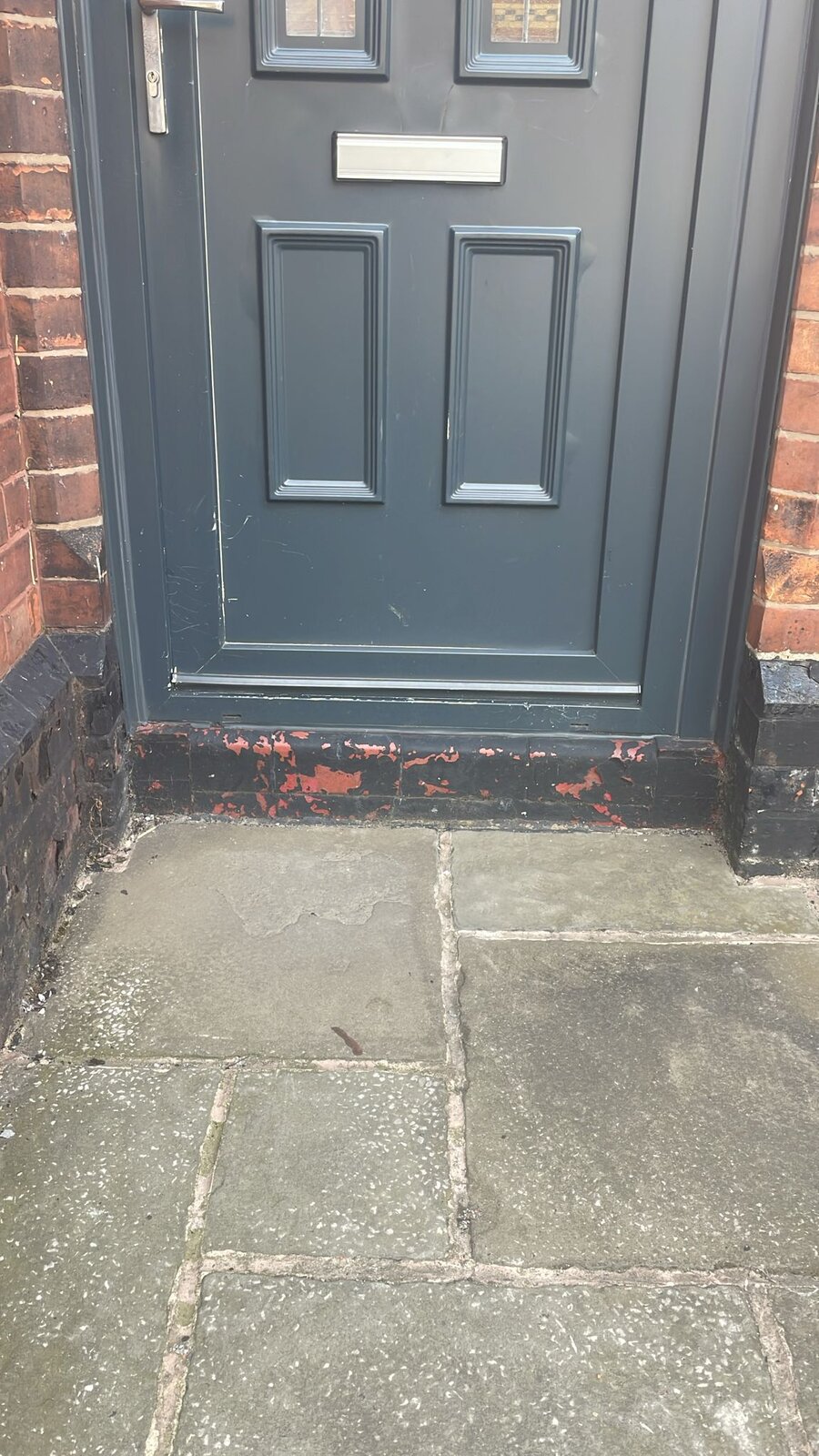

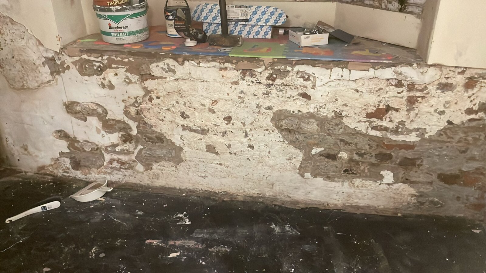

Photos attached. A slim airbrick is just visible painted black at the bottom left of the bay window.

Black paint at the foot of a wall is usually an attempt to hide (it does not cure) persistent damp. In fact, by blocking evaporation, it makes it worse. It looks like you have attractive dense red bricks behind the paint.
The airbrick looks like it might be clogged, and you would benefit from more. One every two metres is common, and as you have a damp problem, more would be better.
Victorian houses with cellars often had ventilators under the front doorstep, I can't see any on yours. Have a look at similar houses in your road to try and work out the original level before the paving.

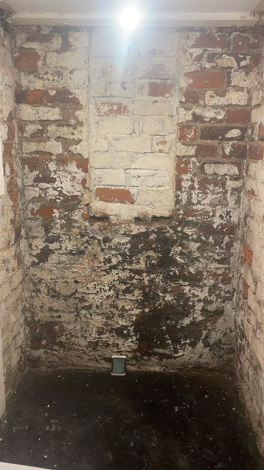

The black part of the cellar wall indicates persistent damp. Its position beneath the bricked up coalhole suggests to me that the old chute might be channeling rainwater towards the wall. It will be difficult to investigate and remedy without taking up the paving.
You could open up the hatch and ventilate with a grill. Start by opening the ventilator in the hatch.
I can't see any guttering, downpipes or gullies. Where are they? The bay should have one.
Bit of excavation then, and yes the blackness certainly below the old chute is damp but it seems at least the blackness is more associated with ingrained coal dust. Guttering is to the right at the junction with the adjacent property. It enters a channel in the wall and runs out to the pavement. It was on our minds if there was an issue there but since the ceiling level of the cellar appears to be considerably drier we have been less concerned with that as a source. There is a house nearby by that has what looks like a powered vent out of the cellar and that's at pavement level where as ours has the additional stepped up section at the front (something they don't have).

Plinth - I think I'm clarifying the difference between the neighbour with the powered vent in which case yes. The neighbour is not however the same build as most of the road, our terrace has a plinth /raised slab area about 3inches high at a gate from the pavement sloping up to the property.
