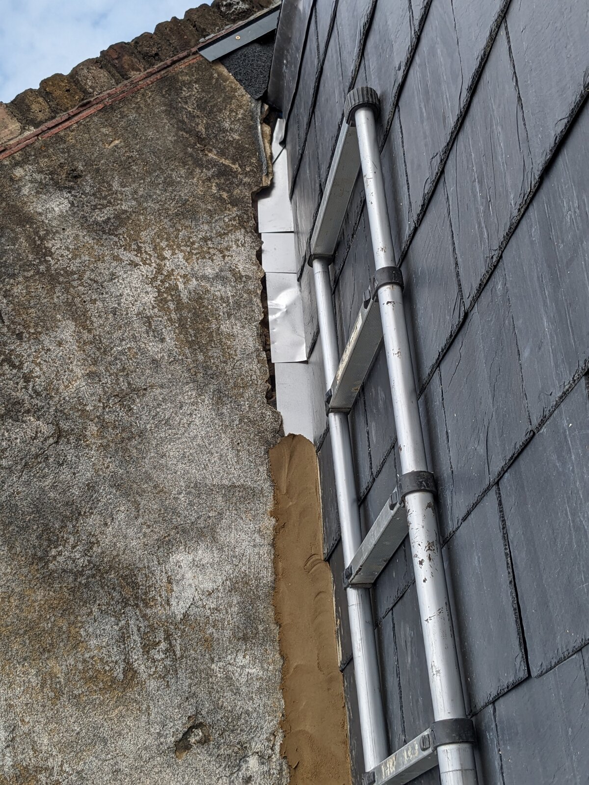

My slate roof has just been redone, looks like quality work by competent roofer but I am worried about the abutment flashing where my roof meets the next house's wall. He installed lead soakers at the abutment (which I think is right) but covered them with cement. I asked about lead flashing instead but he said because the abutment wall is rendered, cement flashing was proper. I am concerned about durability. How long will the cement last before cracking? Should I insist on lead? I assume that will come with significant extra cost which will be a challenge, so if the cement will last more than 5 years I'll take it. Adding a photo from last week that shows the soakers underneath, but the work is now fully completed, and the soakers fully "flashed" in cement.

There should be a vertical stop end to the render and only a small portion of the flashing covered.
As it is, there is a big risk of that render detaching due to expansion of the metal flashing.
Either way, it looks like building sand has been used and that's bad if so

Ideally there should be a cover flashing above the soakers. Roof movement will soon make that render useless. At least with a cover flashing, the soakers and the cover flashing move independently.
OP,
1. Remove all the sand & cement attempt at a fillet.
2. Remove the weird screw fixed off-cut of felt at the ridge.
3. The soakers appear to be zinc or some kind of sheet metal - if they are then remove the soakers as well.
4. Use a 3:1 mix of sand & cement for render patching, & any pointing.
1a. Lead step flashing would be the best cover flashing.
2b. The ridge needs a lead saddle - what you have could, in time, blow away and leak.
3c. Soakers should be cut from lead sheet flashing.
