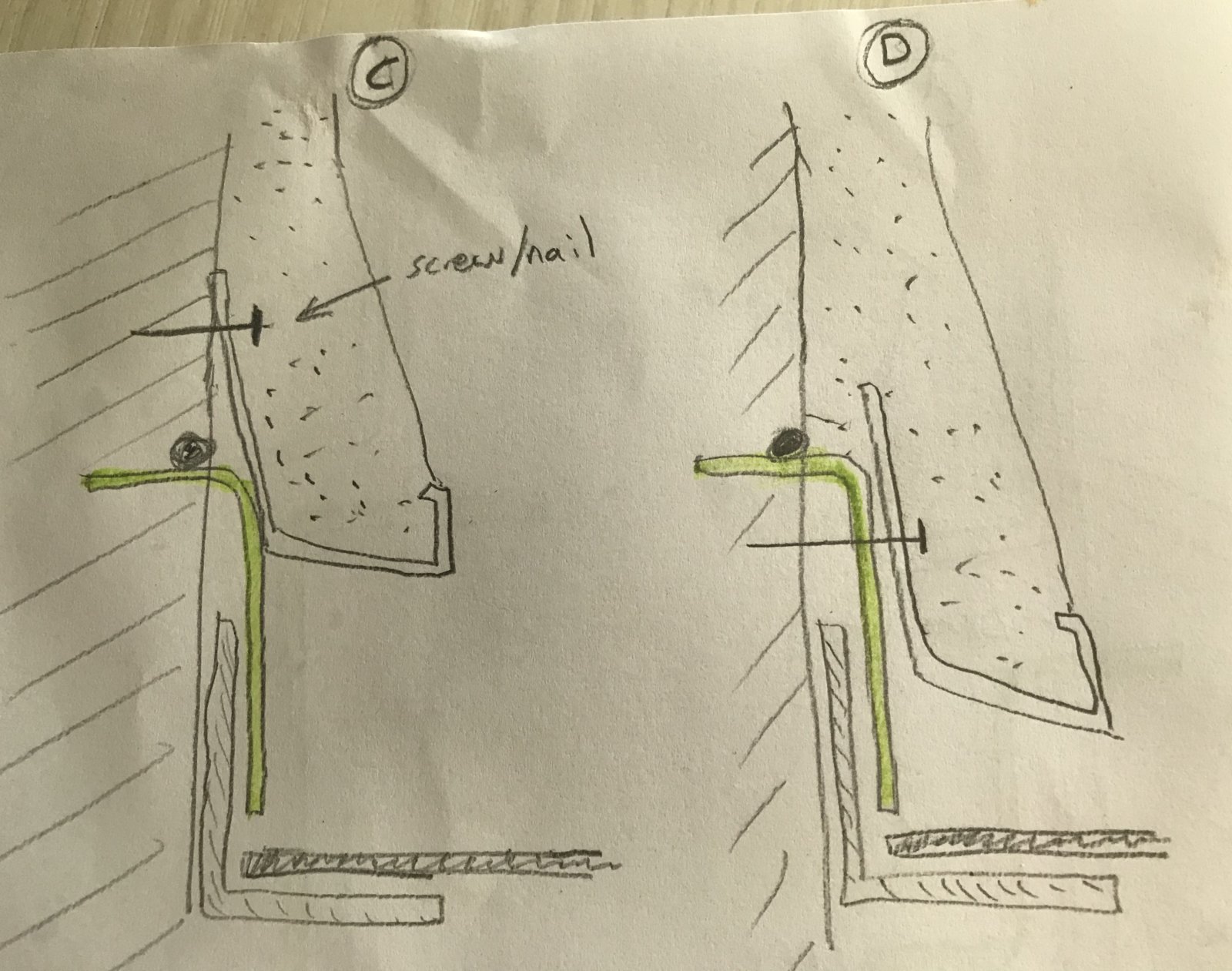

What is that gap between the top of the lead cover flashing and the render bead in the sketches :?::!:
Cover the lead with the bead.
Ok. I’m about to do this so I want to get it right!
Do you mean like C or D below? Screwed/nailed?

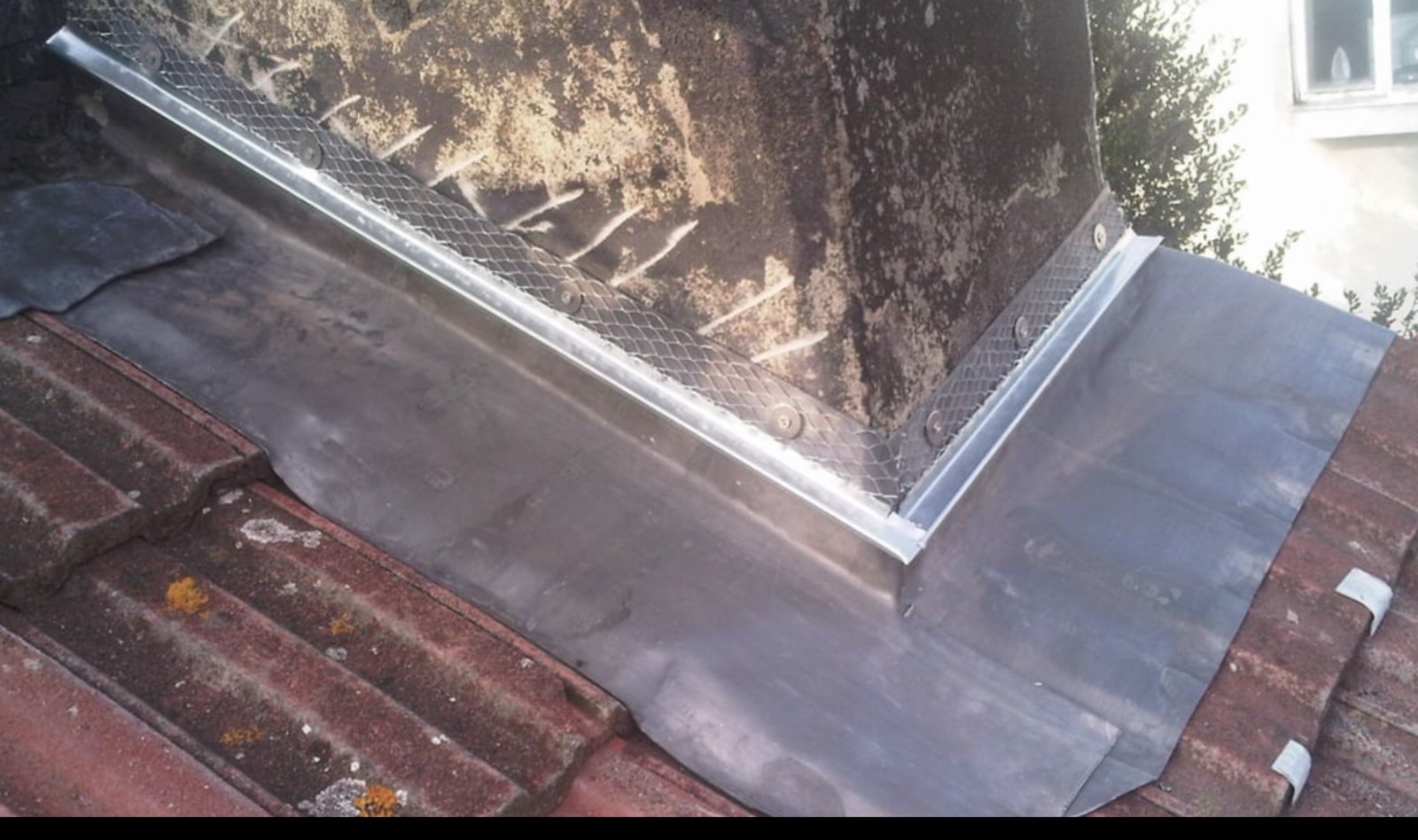

I saw this picture some where as well:
You dont "cover the lead with the bead".
You never cover the lead with the BellCast.
The Bellcast stays above the flashing to allow easy removal of the flashing if necessary and, more important, to avoid lead expansion.
Neither do you ever render on to the lead flashing.
Sketches C & D are both wrong why not make it simple on yourself & do it like Sketch B as earlier advised.
The photo you introduce is also partly wrong & different:
Plastic beads not metal should be used on exterior work.
The one piece lead is not chased in.
Slates being used are in this thread not profiled tiles.
Most important - fixing the Bellcast like that is well wrong. Short story is that in time that fixing method might cause the lead the render and the Bellcast to fail.
"The bead just overlaps the lead and no more" - No it doesn't and it never has.
The Bellcast stays above the lead chase - a clear gap should be seen.
