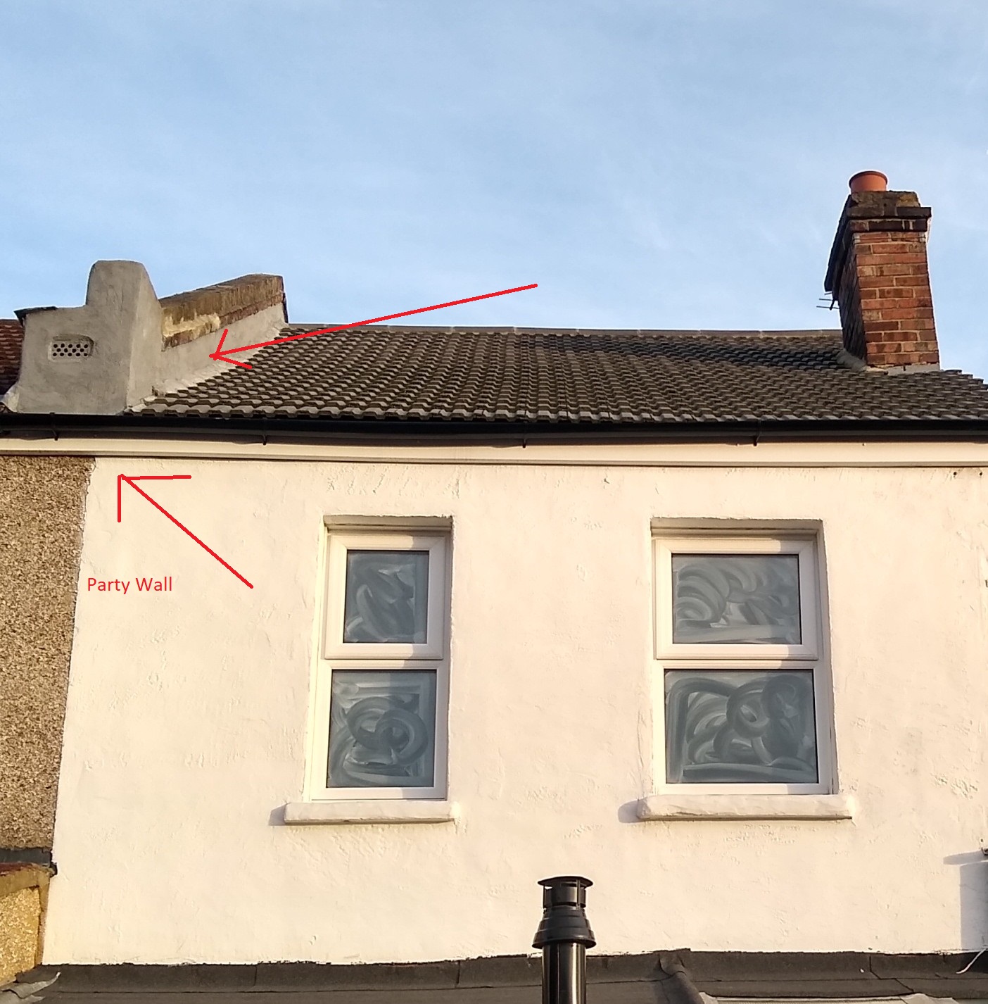

Called a few roofers around and they all have differing ways of installing the lead flashing on parapet wall and i just wanted some advice
Some have said that they will
1. Remove the existing concrete fillet
2. Chase into the parapet wall
3. Insert/ install lead flashing
Some have said that a proper job is to hack off the silvery coating on the parapet , then mechanically fix the flashing to the parapet
Some have said that soakers must be used for the best job
I am a overwhelmed and would like some confirmation from you guys on the correct way to install lead flashing

If the lead does not penetrate the brickwork then the rain can get behind the render [silvery coating ] and travel through to roof.
So chasing into the brickwork is the way to do it. Thanks
However one guy said that he'd hack off the silvery coating on the parapet. This seems unnecessary or am i wrong?
Also do I need to have soakers installed when i have concrete roof tiles?
No soakers necessary for the tile concerned (Ludlow major unless mistaken)
Lead flashing should cover a roll
Depends how far you want to go mate the previous owner has attempted/paid for a lash up if you want to hack off and make good be prepared for a considerable price difference
I'd probably try and include chimney in the price as this has the same issue
The roof doesn't look to old from the pugwork but firewalls are definitely an issue that need lead details and not simply lash on materials

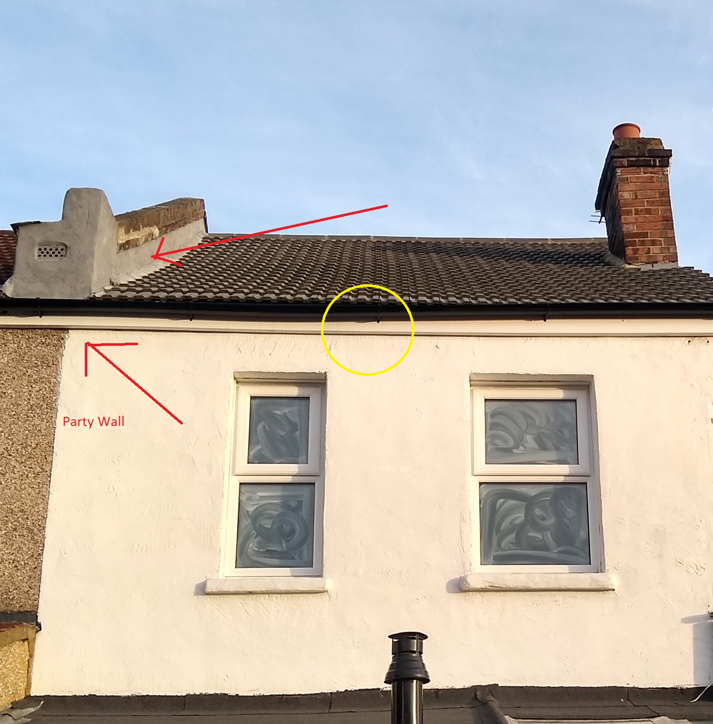

Realign gutter brackets while your at it.
To do this, would the bracket (circled yellow) be raised up as there is a dip to the gutter on the left hand side of the bracket?
Would I need any additional brackets for that noticeable dip?
Take the gutter off and tie a line from the party wall bracket to the gable end bracket and that way you can set your brackets to the string line, brackets about every 800mm so you need at least one more.
