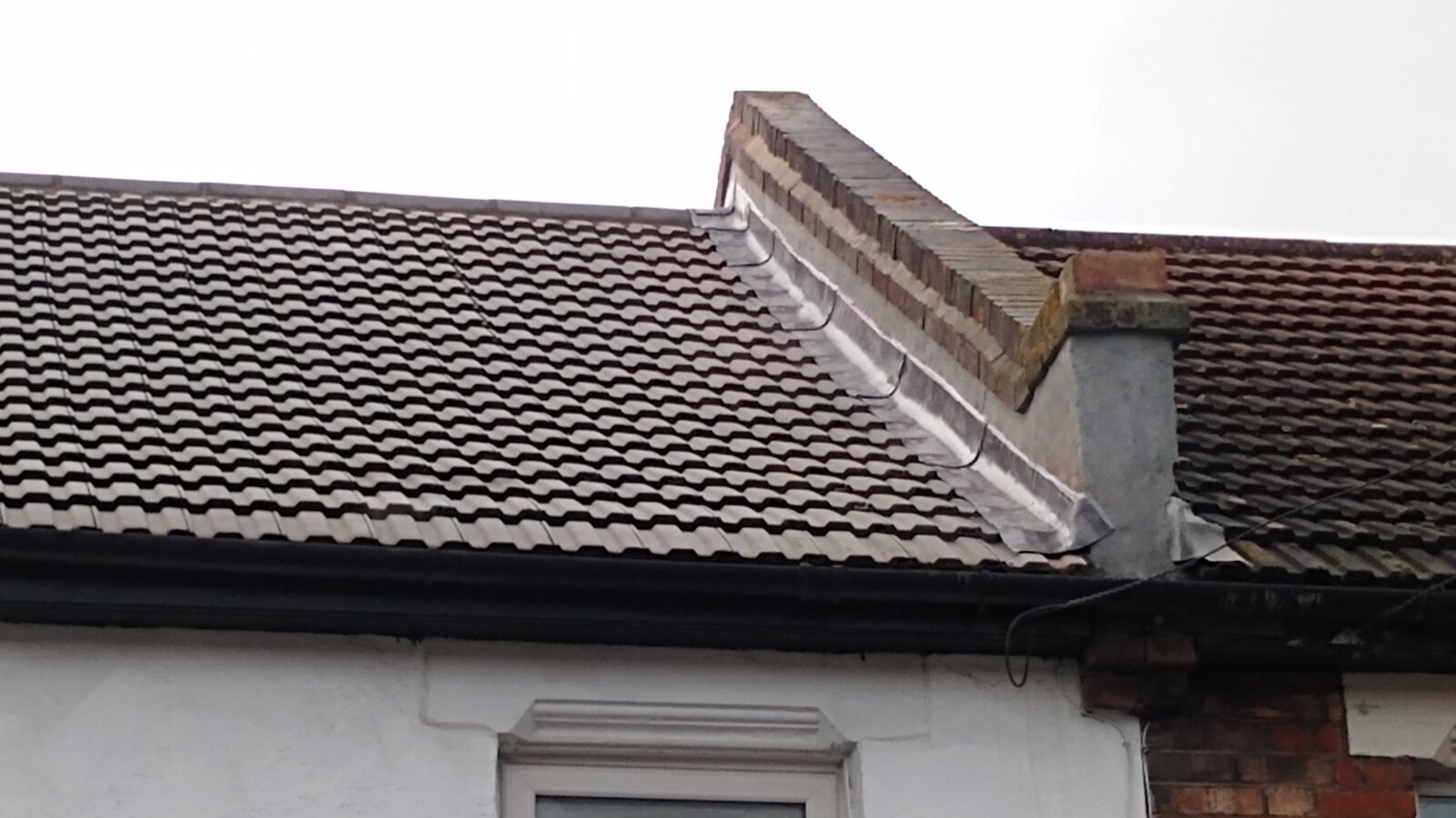

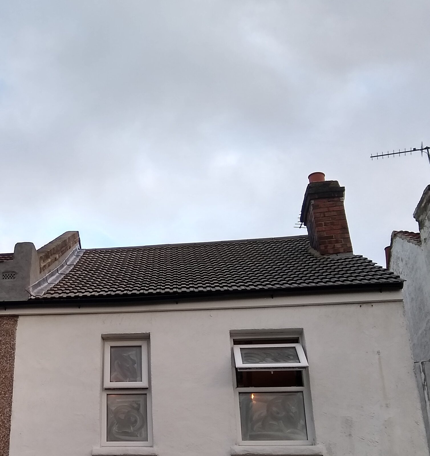

Updated thread with pics
I guess now would be an opportune time to ask whether this a 'good roofing/lead flashing job?'

No it's not great. Looks like a shallow chase into render. Joint pumped up with lead mastic .
The bottom dressing is a give away

Following the lead work, water ingress was still noted
In order to identify whether the water was entering from above (i.e. the parapet wall) or below (i.e. under the lead flashing/roof tile), the roofer lifted the lead flashing, applied some lead sealant and then 'glued' this down to the tile
The water ingress cut down significantly. He is now suggesting the use of a 'secret gutter'
At present, water ingress was noted on the front and rear elevation party wall, closest to the gutter. Does anyone know why?

I wouldn't be surprised, however in his defence, the roof does have a bow in it
Secret gutter will make no difference.
Sticking the lead down wouldn't make any difference.
However, if the over laps are wrong then sticking them down would help for now.
Your barking up the wrong tree

The roofer said that as there is a significant gap between the parapet wall and the redland roof tile, he wanted to use a secret gutter to stop driving rain getting under the lead and into the property.
Is that not the case? The secret gutter wont solve this issue?
What about soakers? Or is it simply a case that the lead has not been laid down properly?
It stopped the majority of the water ingress.
My issue is that sticking lead sealant down onto the roof tile is not a long term solution.
The gap between wall and tiles is irrelevant.
The new flashing covers two rolls of the tile. Even if water got back that far it would get on the underlay.
If mastic applied slowed the leak it is most likely that over laps have been sealed.
It would not made a difference to water tracking sideways.
There is a possibility that tiles have been crack during lead dressing.
The flashing isn't great. A shallow cut into render is pretty poor.
Fwiw, if you do get things added the a secret gutter will eclipse soakers on these tiles.
I still say there's more to the issue
