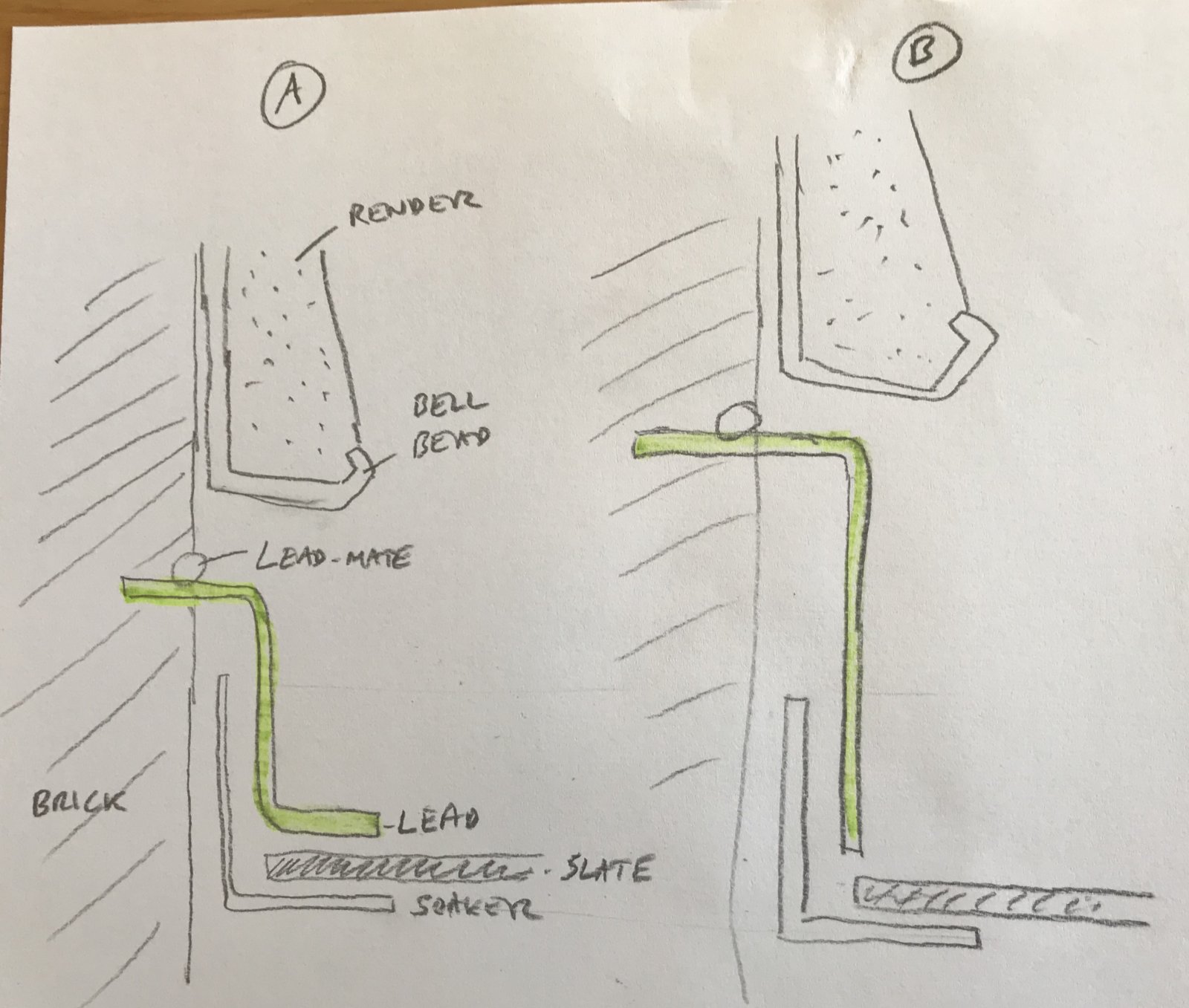

Another question though. Should the lead go like A or B in the picture below:

either will work but B is the usual method over slate.
Well done with the section view sketches - clear and simple.
