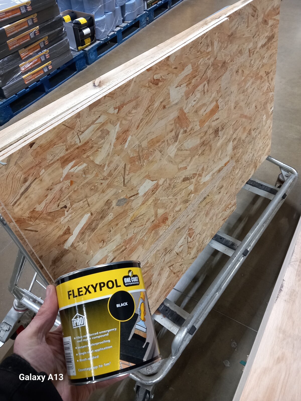

Is flexypol the best stuff to waterproof osb?
22 Nov 2018
2,038
43
Was gonna put osb over the top of a watertank but there will be an area which gets water on it a lot is this bitumen flexypol stuff the best stuff to waterproof it and stop it rotting? Once dry is this flexypol stuff ok to touch with your hands or throw tools on like any other paint?

It has a lid etc but I want to throw things on top so thought I'd cover it again with wood to give it another shell and cut a circular hole on osb where tanks lid is underneath
If this is a similar product to Acrypol or Evercryl, it isn't particularly recommended for timber application.

What kind of plastic? Is there anything which will waterproof the osb? Oil based paint etc if not this stuff
No, can you replace the OSB with a sheet of polycarbonate - even the tri wall used for conservatory roofs?
You can treat the OSB with any sort of paint you like - it'll last a while.

I mean I've got thet acropol stuff now, is it worth trying ?
Acrypol sticks to most things but it doesn't like timber.
It mentions it's uses on the can but timber isn't one of them.
