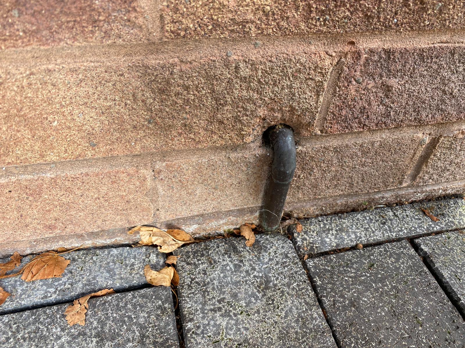

Ok the guy has been. My mum has a old boiler. Which has a copper pipe outside draining into drive. However we was told by other fitters this needs to be changed so it goes into a drain. However the person who came today said it’s fine...
It's a bit close to the ground - if it's dripping in the Winter and freezes it could potentially block the pipe with ice, leading to a dangerous situation
Why was it suggested by some other Instalers that under new regulation. Given I didn’t have a drain nearby. I need a pump to take it up wall into the garage void and down behind the washing machine into the waste?
Its copper and can't be used for condensate drain.

I’m probably not phrasing my self properly. A previous 2 installer said would need to condensate with a pump to a drain pipe as we didn’t have a drain nearby. While the recent installer said we didn’t (and we can just use existing drain off point- changing it to plastic) - not sure why he said this when I thought condensate pipes had to be near a drain or limestone
