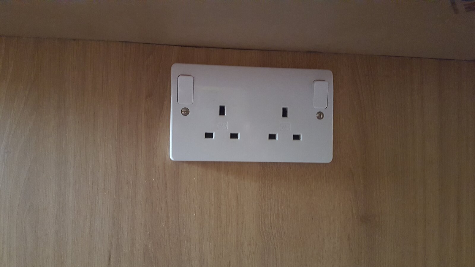

If you fit the sockets such that the plug cable lies horizontal when in use then it will be easier to use. Two single sockets aligned such that they are "facing" in opposite directions would be quite neat.
Would it be easier to use if the socket was mounted just below worktop level in the side of the island? I did just this with a socket at the end of the peninsula in our kitchen.
As its going to be quite a prominent island, and a bit of a center piece to the room - my wife wanted to avoid an ugly plug visible on the side of it. There isn't any counter overhang on the side (there is in the middle, where there will be a seating area, and there will be a plug under there), and the obvious place was the kickboard - where the design is such that the island will look like its floating on the plinths (so the overhand is at bottom, if that makes sense). As the plinth is 18cm, a plug suitable for a laptop charger would fit - but its a question of whether this violates any regulations. I'm not looking to plug a heater or hair dryer into it - and potentially if I presented USB-C - maybe thats not considered a plug and could be within regulations (obviously a plug is the most flexible for different laptops).
