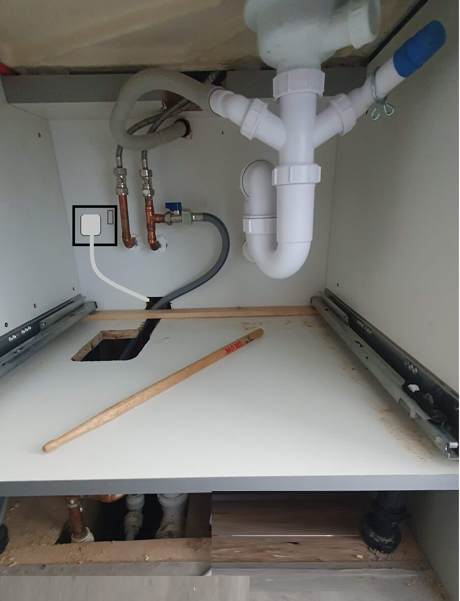

integrated dishwasher wiring - is this even safe?....

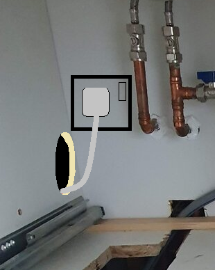

Would we feel more comfortable with this arrangement? Only a single socket is required View attachment 284865
As long as the appliance cable is long enough it should be quite doable, if not another hole can be cut but be aware the position of the appliance doesn't trap the cable.
I would put it higher, those ball valves can be a PITA, dripping or spitting when you turn them.

Yes agreed, however I imagine this is unlikely to be changed,
Notional idea really

Can also use an FCU inside the cupboard with cables and flex all hidden. Flex to a socket behind dishwasher if there's space, or somewhere near. Or use one of those lighting style connectors if happy to cut off plug.

What are the slider rails under the sink waste for? If they are not going to be used take them out, drill a small hole in the base, bring the two T&E cables up through the base as high as they will reach, re-fit the socket to the right-hand side panel and cover the cables with a bit of capping.

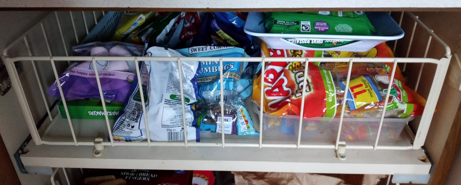

that will basically be a drawer, usually a flat shelf with a 'cage'and any height right up to the top and possibly including additional levels
something like this sort of parts but very adaptable:
