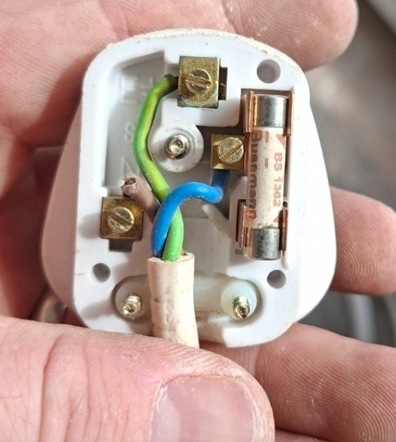

This is a plug on a piece of hire equipment, how it was returned by a builder after he had hired it. All I've done for this photo is remove the cover.
This was sent for repair with the complaint of shocks from appliance:
