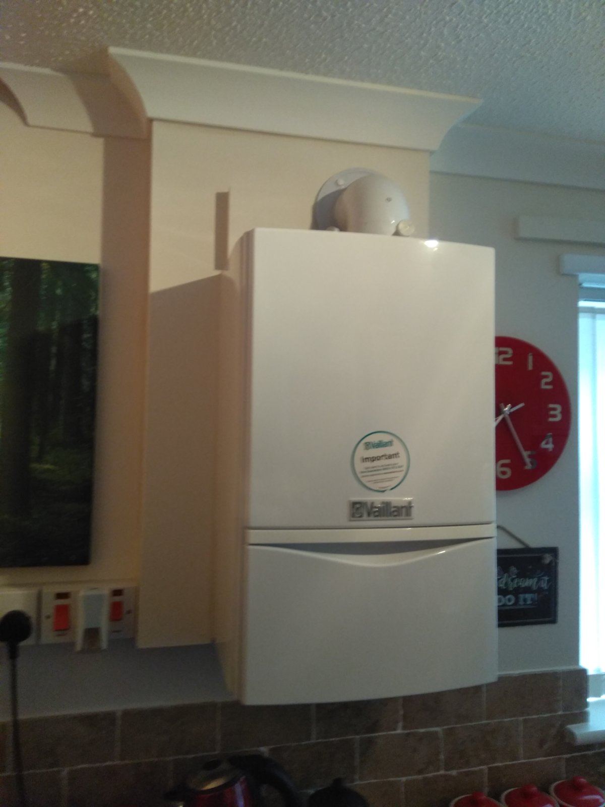

I did a similar thing with mine......
Yes, it will be fine to do that. My own boiler is installed in an adapted kitchen unit wall cupboard, which matches the rest of the fitted kitchen. Just be aware of the boiler manufacturers recommendations for spacing between the cupboard walls and the boiler case, though it is more about proper access for servicing purposes.
I'd be more concerned about whether the case can be taken off the boiler for servicing. Or is the cupboard around it removable. As far as the boxing in of the flue is concerned, the sample point needs to be accessible and the joint between the turret elbow and the rest of the flue should be visible for inspection.

My boiler's case is easily removable, with the cupboard in place, but the whole cupboard can be removed with not much work. I originally had a much larger boiler in it, so plenty of room for the present one.
Read the manual for clearances/ventilation (even with modern boilers).
Leave plenty of clearance to allow for the boxing to expand with mositure (it always happens).
It MUST be easily removable for inspection of the flue/gas pipework etc.
Do not use 3 million screws etc.
I've lost count of the boxing in that I've had to butcher in order to repair boilers...
