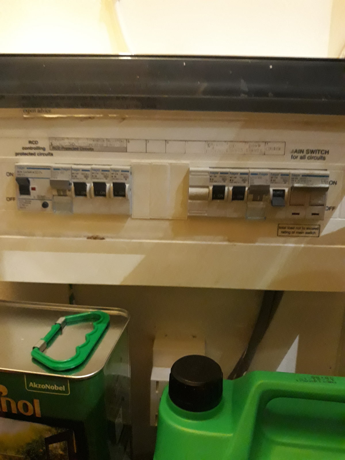

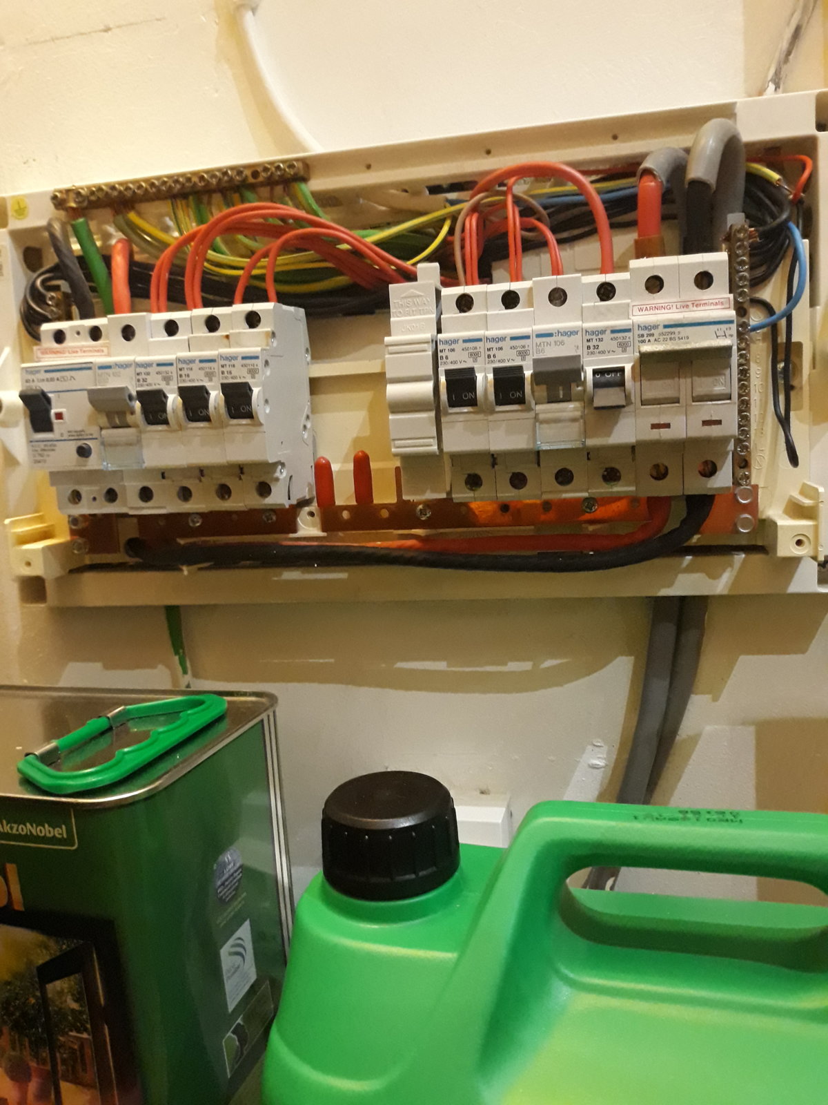

Hi all, i came home from work and was about to put tea on, so as always i preheated the oven then have a shower and get changed, when i came back down the stairs it seems the oven had lost power, the hob didn't work either, so i went to the fuseboard and right enough the breaker had tripped, the issue is however the breaker is not resetting at all, i tried turning off the oven and hob at the isolator then tried the breaker but no luck,so i took the cover of the consumer unit and removed the 6mm live cable from the top of the breaker but the mcb still wouldn't reset, i think the breaker mechanism has failed as the lever has no resistance and it just springs back to the off position.
So i am quite certain the breaker has failed, but before i order a replacement i was thinking of replacing with an rcbo as the cooker currently is not rcd protected for some reason? I am just wondering if hager sell an rcbo that will fit this consumer unit? Here is a couple pictures of my consumer unit.

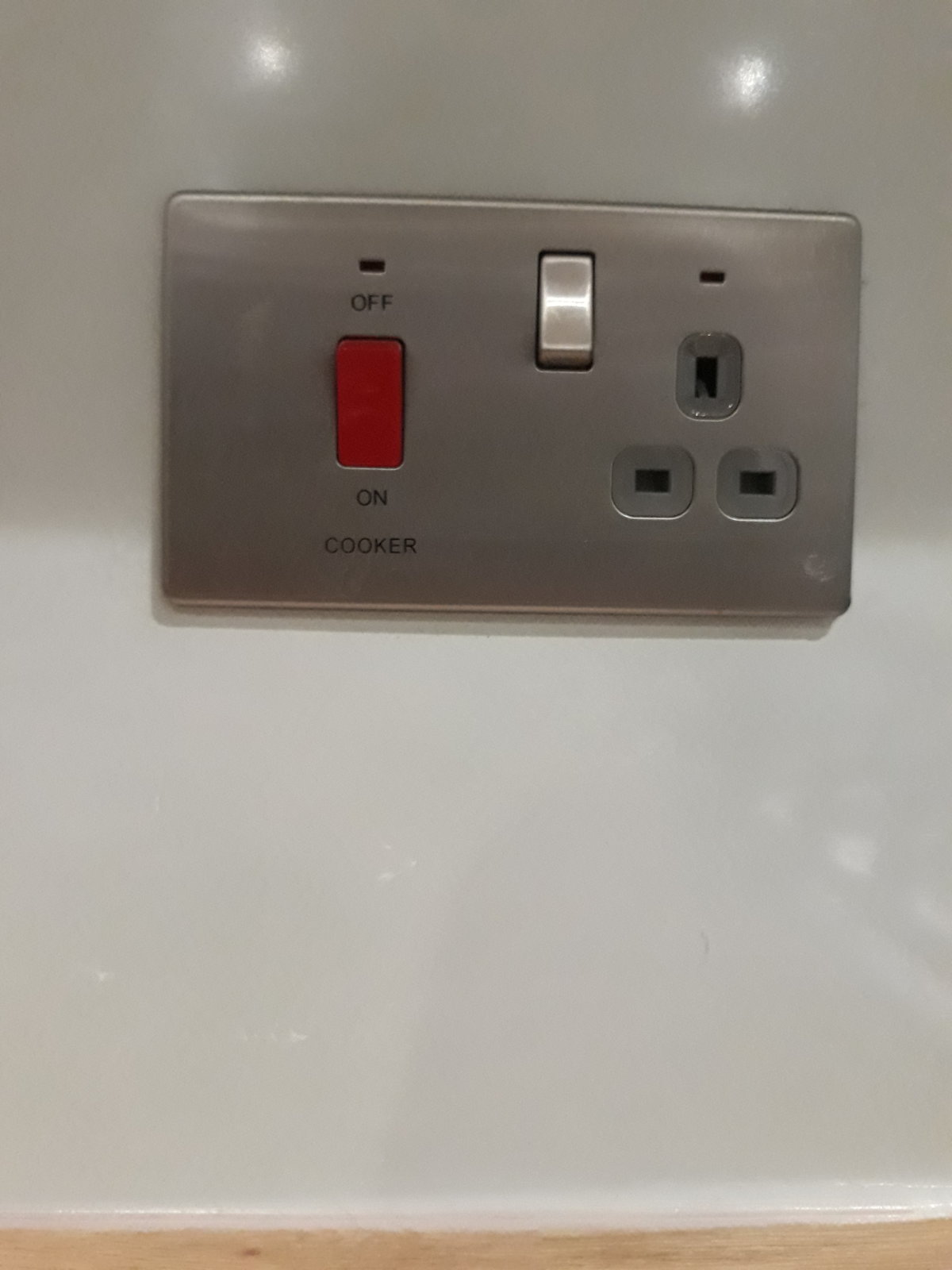

and here is the isolator
20190916_232806.jpg as you can see this also contains a socket hence my question about an rcbo, I often use this socket for when i cut the grass as its right near the backdoor, so i reckon it would be a good idea to fit an rcbo if possible? I don't really want to be messing about altering the busbar and also the cooker cable may not have enough slack. Any help would be great.

Hager stuff fits most of there boards,they just often change the codes, i believe the current range is MTN.
Why is the Main switch still on.
I think it very unlikely you can fit a single width RCBO, you can likely fit a 2 unit wide version, but that would need some alterations which would remove the type testing so it would be a distribution unit not a consumer unit.

Hi all, i came home from work and was about to put tea on, so as always i preheated the oven then have a shower and get changed, when i came back down the stairs it seems the oven had lost power, the hob didn't work either, so i went to the fuseboard and right enough the breaker had tripped, the issue is however the breaker is not resetting at all, i tried turning off the oven and hob at the isolator then tried the breaker but no luck,so i took the cover of the consumer unit and removed the 6mm live cable from the top of the breaker but the mcb still wouldn't reset, i think the breaker mechanism has failed as the lever has no resistance and it just springs back to the off position.So i am quite certain the breaker has failed,
You might be right, it would appear to be broken.
However, that does not mean there was or is not a fault.
RCBOs are a bit taller but it looks like one would go in.
Yes, for the socket used for outdoor tools an RCD would be a good idea.
I wouldn't bother if it was just for the cooker.

You wouldn't need to alter the busbar, but the RCBO should be tested before use, and presumably you do not have the equipment.
Should the cooker circuit be on the rcd side as it has a socket? Why was it not on the rcd to begin with, are cookers prone to nuisance trips perhaps? or were the rules just different back then? This consumer unit is original to the house build around 1995 ish
Thanks.
As above re: RCD for cooker and socket.
Rules different back then.
Cookers are unlikely to produce nuisance trips.

While the standard hager rcbos do fit, they tight on the top terminals in that board, ideally you need one of the new reduced height rcbos, the 32A is Hager part no. ADA332G https://www.hager.co.uk/product-cat...cbos-type-b-30ma-6ka-1-pole/ada332g/91254.htm
Seen quite few hager mcbs go 'floppy' seems quite a common failure mode, Theres probably a fault in the cooker, also, it likely tried to trip and failed, but at least it failed safe. Remember swapping one that failed the same way when it tripped because the householder had left the flex of an iron trailing across a hob and also accidentally turned hob control on, was a fancy steam generator iron too with the flex melted about 300mm from the plug, and she'd chucked the thing in the bin in annoyance, after I swapped the breaker I said to go and get it out the bin and I cut the flex back and re-fitted the plugtop. It amazes me how happy people are these days to chuck expensive things away without a second thought!
