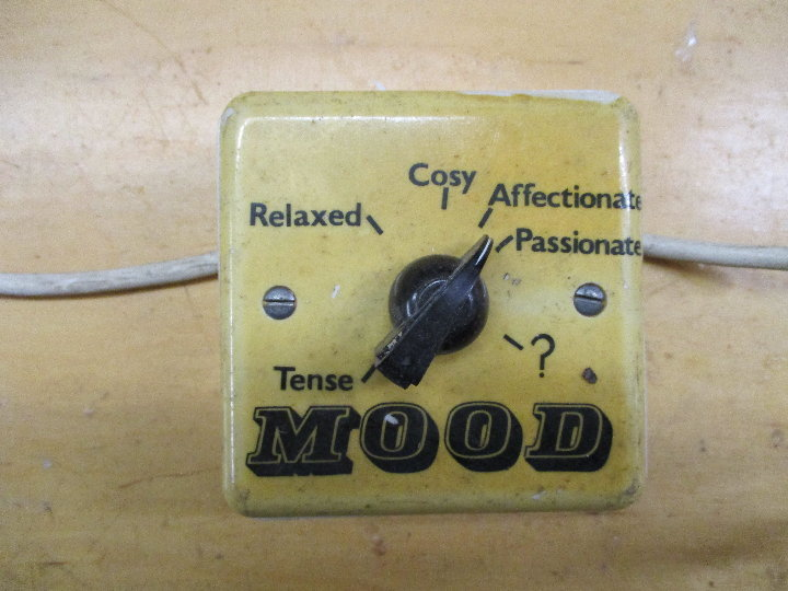

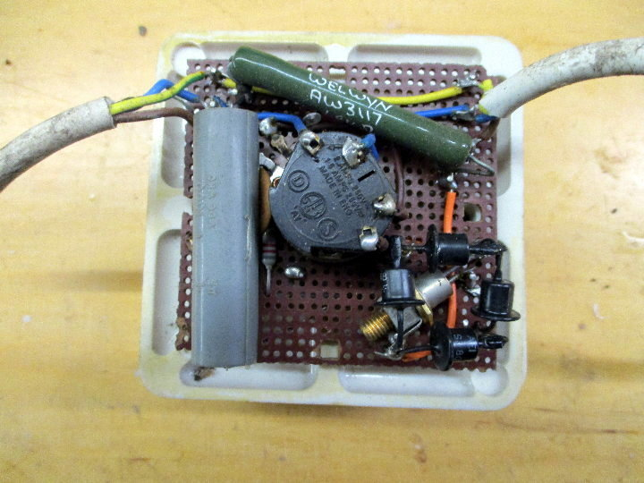

This was very late 60s (possibly very early 70s) - you can see the four ('top hat') diodes (not copper oxide or selenium - I thing silicon 1N540 or similar) of the bridge (with SCR/thyristor below). The second photo, showing the 'reverse', is proof that I was 'in my youth' at the time :)
