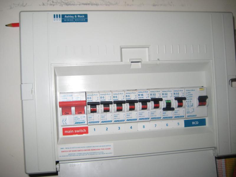

I want to install a 10.8kw mira shower but I'm not sure if my consumer unit is up to the job. I know from reading the other posts about the same topic that I need a minimum of 10mm2 cable and a 45amp MCB. my current shower is a 8.5kw so I'm guessing the cable will need to be changed but i'm not sure if my consumer unit will take a 45amp MCB.
Can anyone confirm if my consumer unit will take a 45amp MCB and if yes where can i get one from?
I'm not a sparky and my knowledge on electrics is almost zero so if you could keep your response in simple terms that would be much appreciated. :confused:
i assume the 32a mcb is the existing shower circuit?
CU looks ok but its hard to tell with the cover still on it,if your main bonds are present.
are you using a sparks for the work?
if not how will you get the cable from a to b ,bonding,notification etc?
most of the mainstream wholesalers will get the new mcb in for you not sure who has it as stock though

Burnsey,
As suggested, your CU appears to accept mcbs from GE, who also make 50A mcbs.

Yeah thats the existing shower circuit. I've turned it off because the shower is leaking internally. I'll run the cable from A to B myself but yes I will get a qualified sparks to do the final connection. I'll either try to run it where the existing one is which is down the dot and dab cavity (which I know will take alot of swearing) or I'll bring it down a stud wall and then through the ceiling above the CU.

Thanks for the link but from what I can see they don't do 45amp.
Thanks for the help everyone. I guess now my question is do I need a 45amp or 50amp MCB. If I need 45amp is it safe to use a 50amp?

45A.
10800 ÷ 240 = 45
9900 ÷ 230= 43
Depends on cable size, and what it runs through. 10mm² might not be OK - would it run through insulation, or behind insulated wall covering?

No. The cavity between plaster board and block work wall is uninsulated and so are the stud walls if I went along that route.
If it's 45amp I need then that's the way I'll go, and if I can't get my hands on one then I guess it's an indendant 45amp consumer unit like this one.
http://www.toolstation.com/?r=f&feature=63252
Don't really want to take chances on the 50amp MCB when the cost is only an extra £22.00 to do it the correct / safe way.
