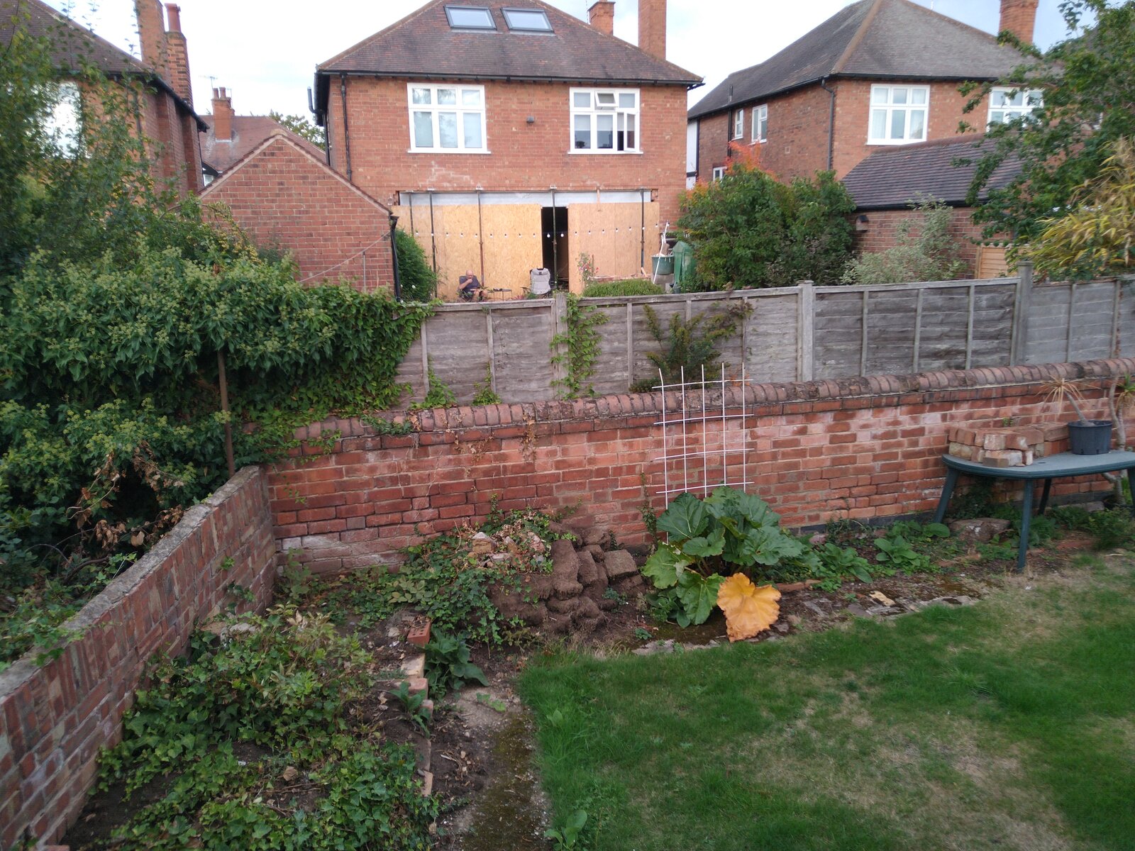

My neighbours work at the moment, may be posting a picture of a collapsed house next week, but it does beg the question.
