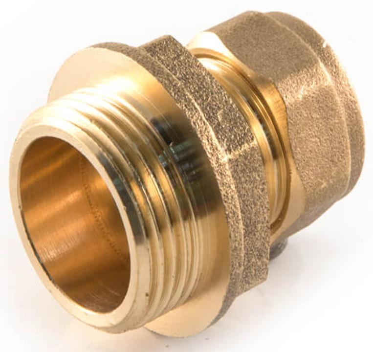

I dismantled the assembly and remade the connections following your advice, no leaks no weeps, I tested it by banging it about a bit and leaving the pressure on for a couple of days, all was OK. It's now completed and the backer board in place. (The last thing you need in a wet room is to have to pull it apart because of a weeping connection).
Because its difficult to be precise about the number of turns required to seal 1/2" BSP connections I experimented on a test set up and thought the following might help as a bit of a guide...
I found than about 15 to 18 turns of plumbers (not gas) PTFE seems to be about optimal, any less and the joint can be prone the weeping, any more and it becomes difficult to start the male thread turning. The torque to seal needs to be quite a bit more than hand tight, but quite a bit less than you could achieve with a small/medium size set of grips (a bit vague I'm afraid, but I have no means of measuring torque). What I did find though is that if you do over tighten slightly and the joint starts to weep, providing you used enough PTFE tape in the first place, backing the thread off slightly can usually seal the joint. Tightening it further (which would be the natural inclination) just makes the weep worse. Over tighen a lot and it can be beyond recovery.
